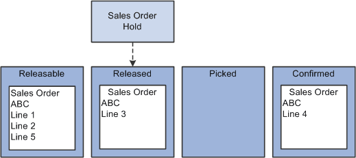

This diagram illustrates an example of a sales order that has lines that are not sent to the TMS. This order contains five lines in different fulfillment states; three are releasable, one is released, and one is confirmed. If PeopleSoft Order Management is set up so that each order line is held at a released state, then lines 1, 2, and 5 will not be sent to the TMS. However, lines 3 and 4 will be sent to the TMS because line 3 is already at a released state, and line 4 is past a released state.
TMS sales order holds

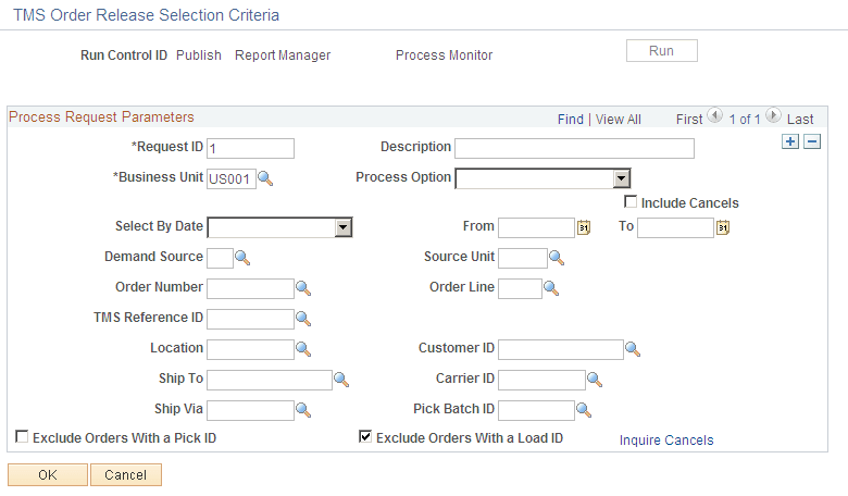

TMS Order Release Selection Criteria Page
Use the TMS_ORDER_RELEASE EIP to send demand data from PeopleSoft Inventory to the TMS.
Use the TMS Order Release Selection Criteria page (IN_RUN_TMSREL) to select which order lines are to be processed for this run control.
Navigation:
Select the TMS Order Release check box on the Publish Outbound Message page, and click the TMS Order Release link.
This example illustrates the fields and controls on the TMS Order Release Selection Criteria page. You can find definitions for the fields and controls later on this page.
Field or Control Description
Process Option
Select one of these options to run the IN_TMSORDREL application engine process:
Initial Download: Select to send order lines to the TMS for the first time.
Re-send Shipment: Select to send changes to order lines that were previously sent to the TMS.
Remove Shipments: Select to request that all rows of shipment be physically deleted from the TMS system.
Include Cancels
Select this option to remove all rows of a shipment from the TMS. This option is used to remove shipments that have an unfulfilled state in PeopleSoft Inventory or Order Management.
TMS Reference ID
Select a value if you are resending or removing a shipment. This option is used when change orders occur or to identify a specific TMS Reference ID.
Inquire Cancels
Select this link to view all orders that have an unfulfilled state and will be downloaded to the TMS if you select the Include Cancels option.
The TMS Reference ID is created from auto numbering setup on the PeopleSoft system. This ID is assigned to each order line selected during the Publish Outbound Message process.
