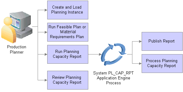

You can also use the Supply Planning Capacity Workbench to view capacity usage for a business unit, work center, and periods of time. The workbench is interactive and real-time.
The next drawing illustrates how a planner would prepare for and run the Capacity Report. First, planners normally define the planning instance and load it into the system. Next, they run either the material plan to determine material requirements or the Feasible solver to resolve material feasibility for resolvable material violations. Finally, planners run the Capacity Report using the SPL_CAPX_RPT Application Engine process, after which they can review the report using Oracle's XML Publisher. Planners can update the supply or demand and repeat the steps. This drawing illustrates the steps:
This drawing illustrates how a planner prepares for and run the Capacity Report
Capacity report creation

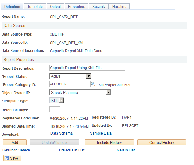

Definition Page
Use the Definition page (PSXPRPTDEFN) to define Planning Capacity XML Publisher report templates.
Navigation:
Reporting Tools, XML Publisher, Report Definition.
This example illustrates the fields and controls on the Report Definition page - Definition tab. You can find definitions for the fields and controls later on this page.
You use the page Report Definition page - Definition tab to define the report ID and its attributes. Report definitions associate a data source with template files. The previous page displays the Capacity Planning report definition that is provided with PeopleSoft Supply Planning. You can use the definition as a template to build other report definitions. A template is used to associate different layout formats as required by different countries or regions or as required by different channels such as web posting, printer, facsimile, and so on.
See Understanding XML Publisher Setup.

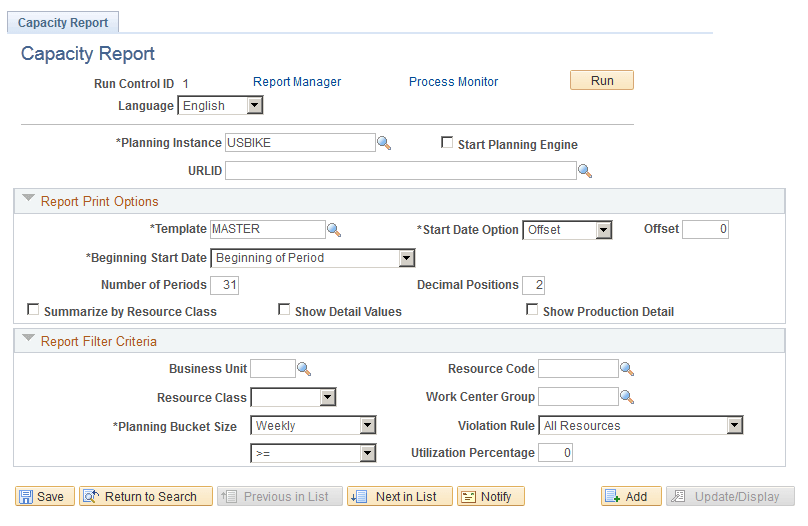

Capacity Report Page
Use the Capacity Report page (PL_CAPACITY_REPORT) to run Capacity Reports.
Navigation:
Supply Planning, Solve Plan, Reports, Capacity
Click the Run button on the Capacity Report page to create the report.
This example illustrates the fields and controls on the Capacity Report. You can find definitions for the fields and controls later on this page.
Capacity Report
To define the parameters for a Capacity Report, select the run control ID, complete the print options and filter criteria and click the Run button. When running the program, the system extracts the capacity data and invokes XML Publisher. Using Integration Broker message transactions, the system processes the supply planning transactions and retrieves the capacity profiles from the application engine, processes them, and saves them to database tables where capacity data can be extracted for the report.

Report Print Options
Use this grid to define the print options for the Capacity report.
Field or Control Description
Template
Select a row type template. The template determines which row type values appear in the Capacity report. PeopleSoft Supply Planning provides standard display templates that you can use to set up of default templates where you can define unique row types, graphs, period durations, and other display defaults for workbenches and review pages. When you create reports for XML Publisher, you can also use a delivered default template.
Start Date Option
Select the date option that you want to use to generate the Capacity report. Options include: Date and Offset. To define a specific date, select Date. If you select a specific date, enter the date in the Date field. If you select the Offset value, enter the number of offset days from the current date in the Offset field.
Date
Select a specific date on which to generate the Capacity report.
Offset
Enter the number of days that you want to offset the report generation date. For example, if you enter an offset of 10, and if the current date is 12/01/2009, the system calculates the start date as 12/01/2009 plus 10 days and sets the offset date as 12/11/2009 for generating the Capacity Report.
Beginning Start Date
Define the start date of the first bucket. Values are Beginning of Period, in which the start date falls on a specific start date that you entered in the Date field. Initially, the system uses Beginning of Period as the default value. Templates with capacity-based display types always use Beginning of Period.
Number of Periods
Enter the number of buckets that the system should calculate and display in the Capacity Report. The system initially populates this field with the value that you entered for the Default Number of Periods field on the Define Display Template page. This value defines how far into the future, that the report displays the capacity usage profile. For example, if you enter 30, the report displays 30 bucketed values for capacity usage for the bucket size specified, such as 30 days, 30 weeks, or 30 months.
Decimal Positions
Enter the decimal precision that the system should uses for Capacity Report quantity buckets.
Summarize by Resource Class
Select to display an aggregate summary on the Planning Resource report for all of the resources defined by the resource class (Time or Unit) selected in the Resource Class field. The system aggregates them across multiple resource codes; however, not across the business unit.
Only resources that belong to the same resource class, and with the same planning bucket and same business unit can be aggregated. If you do not provide the filter for the resource class, planning bucket size, or business unit, the report will contain multiple summarizations for each combination of resource class, planning bucket size and business unit.
The work center group is used only as filter. The system summarizes the Capacity Report across work center groups. If you enter a value for the resource code without a wildcard symbol, the summarization section will not be displayed in the report, because there is nothing to summarize.
Show Detail Information
Select to include the aggregate summary and supporting details for all resources in the Capacity Report. You use this check box only with the Summarize by Resource Class check box. If you select both the Summarize by Resource Class and Show Detail Information, check boxes, the report summarizes the resource usage over time, and detail or individual resource usage over time. If the Show Detail Information check box is deselected, then the report only displays the summarized information.
Show Production Detail
Select to include production details in the Capacity Planning report. These details include the resource for the given time frame, either planned or actual.
Report Filter Criteria
Business Unit
Select a single business unit or leave it the field blank to select all business units. You cannot use wildcard searches for this field.
Resource Class
Select a resource class value our leave the field blank to select both resources classes. Values are Time that displays aggregate resources based on the amount of time that is available in the time bucket that you select, and Unit that displays aggregate resources based on the number of units the resources can produce in a time bucket.
Work Center Group
Select a work center group. Work center groups can consist of one or more people and machines and represents a logical grouping of machines, a department, or a cost center. You can also user wildcard searches for this field.
Planning Bucket Size
Select either Daily, Weekly, or Monthly planning buckets on . A value is required in this field. If you want to see a daily and weekly report, you must, for example generate two reports.
Violation Rule
Select a value to limit the search for resources. Possible values are:
All Resources: Includes all resources in the search.
Consider Violations: Limits the search to resources where solvers consider violations when solving for capacity.
Ignore Violations: Limits the search to resources that solvers ignore when solving for capacity. You use the Work Center page to indicate that you want to report over-capacity resources but not repair them during the optimization process. To access the page, select: Supply Planning, and then Refine Plan, and then Manufacturing.
Utilization Percentage
Select an operator by which you want to limit the resource search. After selecting an operator, enter a value to use in conjunction with the operator. This filters the range of the utilization percentage. For example, if you select the > (greater than) field value and enter the an operator value of 90, the Capacity Report will display capacity usage for only those resources with utilization greater than 90 percent. The utilization is the result from the solver that divides the usage by availability. Availability is calculated using the definition defined on the Work Center page.
