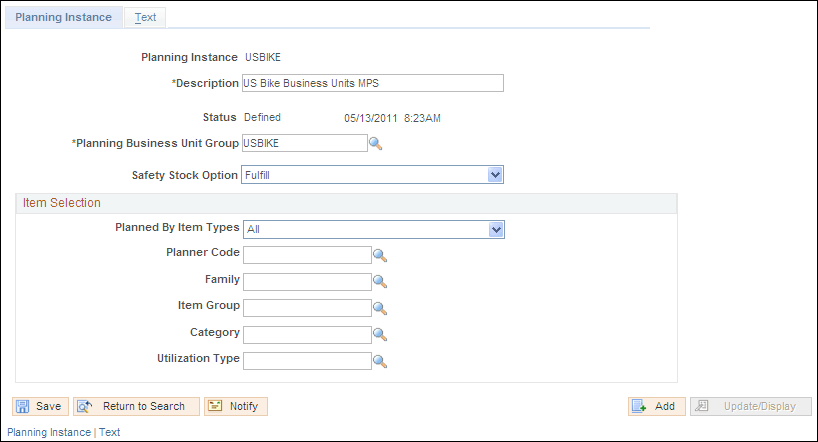

Planning Instance Page
Use the Planning Instance page
Navigation:
Supply Planning, and then Create Plan, and then Planning Instances
This example illustrates the fields and controls on the Planning Instance Page. You can find definitions for the fields and controls later on this page.
Field or Control Description
Status
Displays the status of the Planning Instance Load process for the corresponding planning instance ID or the last major data exchange that occurred for the planning instance.
Safety Stock Option
Select the desired safety stock option from:
  1. Fulfill: This is the default
  2. Ignore until First Demand
  3. Ignore
Planned By Type
Select only those items that are associated with the specified planned by types.
A change to the item selection criteria has no effect on the next regenerative select or net change Load Planning Instance process run. Field values in the Item Selection group box apply to full regenerations only.
