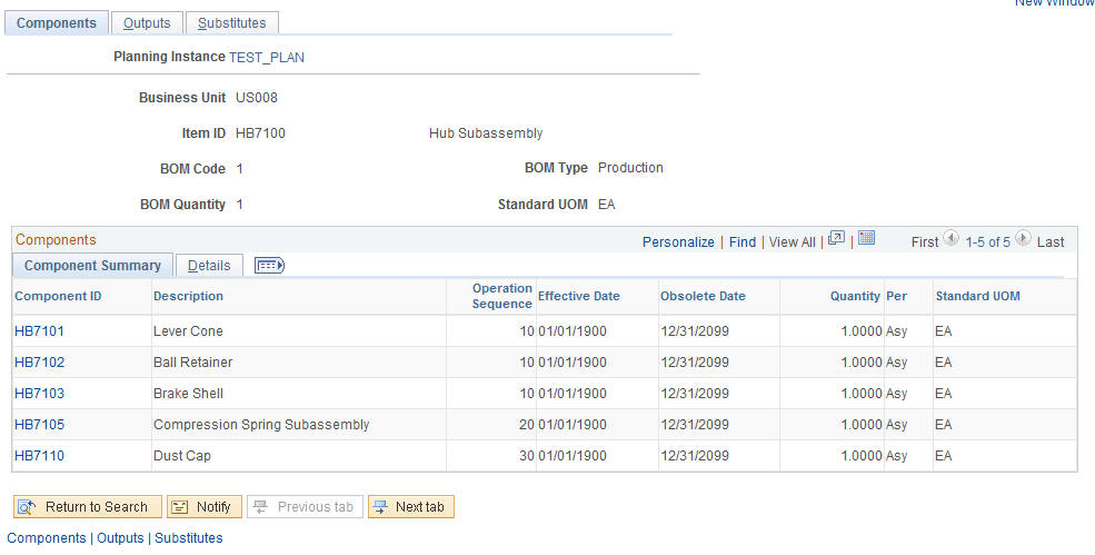

Review Bills of Material - Components Page
Use the Review Bills of Material - Components page ( PL_BOM_COMP ) to review general information about BOMs and their components.
Navigation:
Supply Planning, and then Refine Plan, and then Manufacturing, and then Review Bills of Material
This example illustrates the fields and controls on the Review Bills of Material - Components page. You can find definitions for the fields and controls later on this page.
Details
Select the Details tab.
Field or Control Description
Yield
Displays the expected percentage of usable components in a batch of components issued to production. A 100 percent yield assumes that the entire quantity of the component is usable and none are to be scrapped. The system considers component yield in the PeopleSoft Supply Planning to inflate component requirements to account for the expected loss during the assembly process. When scheduling the number of components to be used in production, the system divides the required quantity by the component yield value to derive the scheduled quantity. For example, suppose that an assembly has a demand of 100 units and the quantity per assembly is 1 with a component yield of 90 percent, then planning requires 111 components (100/.90). If the expected 10 percent yield loss occurs, 11 components (111 ×.10) are unusable, leaving you with the original required 100 components. When calculating the cost of the assembly, the system includes the component yield loss, thereby increasing the cost contribution of the component.
Substitutes Exist
Indicates whether you have defined substitutes on the BOM for this component item. You can review substitute information on the Substitutes tab.
