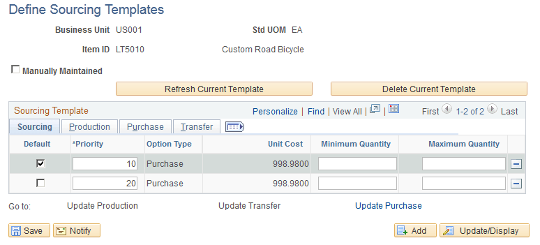

Define Sourcing Templates Page
Use the Define Sourcing Templates page (PL_SRC_TEMPLATE) to create sourcing templates.
Identifies sourcing details including production, purchasing, and transfer options for sourcing templates.
Navigation:
Supply Planning, and then Define Planning Attributes, and then Sourcing Templates, and then Define Sourcing Templates
This example illustrates the fields and controls on the Define Sourcing Template page. You can find definitions for the fields and controls later on this page.
Field or Control Description
Manually Maintained
Select to identify this sourcing template as a manually maintained template. If you select this check box, the Generate Sourcing Template batch job does not overwrite any options in the template.
If you no longer need to maintain this sourcing template manually, deselect this check box. The next time that you run the Generate Sourcing Template batch job, the system overwrites the current sourcing template, including the options that you have defined.
Refresh Current Template
Click to replace the existing sourcing options with the current available default sourcing options. When prompted, click Yes to refresh with the current sourcing options; click No to keep the sourcing options as they appear on the page
Update Production
Click to access the Update Production page, where you can select production options for the item.
Update Transfer
Click to access the Update Transfers page, where you can select transfer options for the item.
Update Purchase
Click to access the Update Purchase page, where you can select purchase options for the item.
Sourcing
Select the Sourcing tab to view and maintain basic information about the sourcing template.
Default
Select to use this sourcing option as the default value when the planning engine sources demand for the current plan. You can select only one sourcing option as the default for the template. The system uses the default option to source demand when no sourcing template entries meet the selection criteria.
Priority
Enter a numerical value that defines the priority that you want the planning engine to consider when using a sourcing option to meet demand. You can enter any positive number up to 999. The planning engine (solver dependant) considers all of the sourcing template options (production, transfer, and purchase) using their priority in ascending sequence until it finds a template that can meet the demand without creating planning exceptions. If the planning solvers cannot find a template without exceptions, then it uses the default template.
Option Type
Defines whether the demand is supplied by production, purchase, or transfer.
Minimum Quantity
Defines the minimum demand quantity that should be considered when selecting this sourcing option. For example, if the demand is 10 but the minimum quantity is 50, then the sourcing option will not be considered when generating supply.
Maximum Quantity
Defines the maximum demand quantity that should be considered when selecting this sourcing option. For example, if the demand is 100 but the maximum quantity is 80, then the sourcing option will not be considered when generating supply.
Production
Select the Production tab to view and update information related to bills of material.
Purchase
Select the Purchase tab to view and update information related to purchasing and suppliers.
Transfer
Select the Transfer tab to view and update information related to material transfers.
