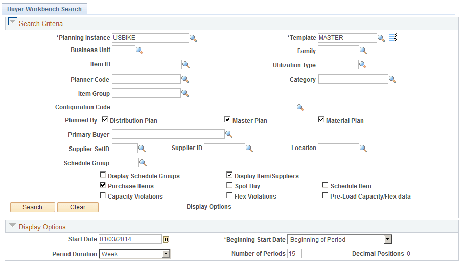

Buyer Workbench Search Page
Use the Buyer Workbench Search page (PL_BWBENCH_SRCH) to define search criteria for generating a list of schedule groups and items.
You can select the schedule group, group of items, or item for which you want to review buyer plans.
Navigation:
  • Supply Planning, and then Solve Plan, and then Material, and then Buyer Workbench
  • Supply Planning, and then Solve Plan, and then Material, and then Review Buyer Purchases
This example illustrates the fields and controls on the Buyer Workbench Search page. You can find definitions for the fields and controls later on this page.
The Review Buyer Purchases component offers the same search, summary, and drill down capabilities as the Buyer Workbench component. However, you cannot make changes or add new orders to the plan through the Review Buyer Purchases component.
Field or Control Description
Primary Buyer
(Optional) Include in the list only the purchase information for items assigned to the specific primary buyer.
Supplier SetID
(Optional) Include in the list only the purchase information for suppliers whose SetID matches a specific value.
Supplier ID
(Optional) Include in the list only the purchase information for suppliers whose supplier ID matches a specific value.
Name
(Optional) Include in the list only the purchase information for suppliers whose supplier name matches a specific value.
Location
(Optional) Include in the list only the purchase information for suppliers whose supplier location matches a specific value.
Display Schedule Groups
Select to include schedule groups in the list.
Display Items/Suppliers
Select to include item and supplier combinations in the list.
Purchase Items
Select to include items that you procure using PeopleSoft Purchasing.
Spot Buy
Select to include spot buy items that you procure using PeopleSoft Strategic Sourcing.
Schedule Item
Select to include schedule items that you procure .
Schedule Priority
Select a priority if you want to include schedule items with a specific priority. Values are High, Medium, and Low.
The schedule priority will only be enabled if you select the schedule item display option.
Capacity Violations
Select to include schedule groups and items with capacity violations.
Flex Violations
Select to include schedule groups and items with flex violations.
Pre-load Capacity/Flex data
Select to load capacity and flex data in the Buyer Workbench Summary page. If you select this check box, you do not need to click the Calculate Capacity/Flex box on the Buyer Workbench Summary page to view the capacity and flex data.

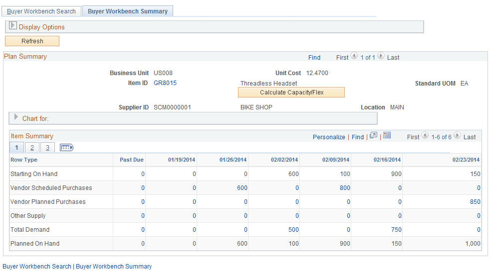

Buyer Workbench Summary Page
Use the Buyer Workbench Summary page
Navigation:
(click any link in the Schedule Group or Item ID column to review the corresponding details).
This example illustrates the fields and controls on the Buyer Workbench Summary page. You can find definitions for the fields and controls later on this page.
The Plan Summary group section contains a set of data for each row selected from the item/supplier grid on the Buyer Workbench Search page, and contains these grid areas:
  • Display Options.
  • Plan Summary.
  • Chart For.
  • Item Summary.
Display Options
The fields that you defined on the Buyer Workbench Search page in the Display Options group box appear. You can change this criteria here and click the refresh button to update the data on the Buyer Workbench Summary page.
Plan Summary
This section displays the business unit, item ID, schedule group, supplier ID, and supplier location. If you selected a schedule group on the Buyer Workbench Search page, the system displays the Calculate Capacity/Flex button in this section.
Chart For
In this area, you can review a chart of the plan summary data. The default chart type, as well as the rows included in the chart are determined by the display template that you select.
The system does not automatically generate charts when first accessing the Chart section. Select a graph type and click the Graph button to generate a graph.
Item Summary
This section displays bucketed purchasing information for the schedule group, or items and suppliers that you selected on the Buyer Workbench Search page.
The number of buckets that appear is determined by the values that you define for the fields in the Display Options group box. The template that you select for the corresponding planning instance determines which order-based and calculated rows appear. Order-based rows, such as supplier planned purchases, represent summarized demand and supply types. Calculated row types, such as planned on-hand, are derived from the values in other row types.
Click any link within a bucket (including order-based row types) to access a detailed list of orders.
