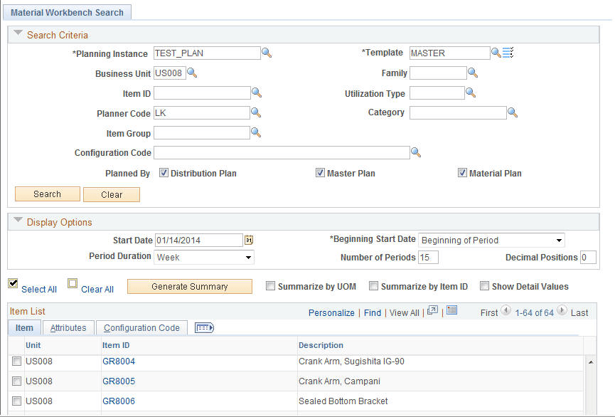

Material Workbench Search Page
Use the Material Workbench Search page (PL_WBENCH_SRCH) to define item search criteria used to generate a list of items from which you can review material plans.
Navigation:
Supply Planning, and then Solve Plan, and then Material, and then Material Plan Workbench
This example illustrates the fields and controls on the Material Workbench Search page. You can find definitions for the fields and controls later on this page.
Enter search criteria to filter the results, and click the Search button to display the results on this page. Click the Clear button to clear all of the criteria. You can specify which display template to use or click the Display Row Types button to override the settings for the display template that appears. If you select the check box for multiple items, click the Generate Summary button to generate an aggregate summary for the selected items and drill down to the Material Workbench Summary page, where you can review the item details. For single items, click any link in the Item ID column to review the corresponding item details. Select Summarize by UOM or Summarize by Item ID to summarize the results for multiple items by unit of measure or by item ID, respectively.
When summarizing data across items, select the Show Detail option to display the summary for each item. If you do not select the Show Detail option, a summary for all of the items appears on the Material Workbench Summary page, but no item-specific summary appears. Access the Material Workbench Drill Down pages to review summary details for individual items.
Multiple views of the item list are available by selecting the tabs in the scroll area. Each tab includes additional information related to the item, including corresponding business units, item descriptions, and item attributes,
Display Options
Define how the search results appear on the Material Workbench Summary page. The system populates the fields in this group box with default values that it derives from the display template that you specify in the Template field.

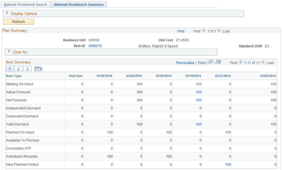

Material Workbench Summary Page
Use the Material Workbench Summary page (PL_WBENCH_SUMMARY) to analyze the horizontal material plan summary for an item or group of items and drill down to plan details.
Navigation:
click any link in the Item ID column or select multiple items and click the Generate Summary button on the Material Workbench Search page
This example illustrates the fields and controls on the Material Workbench Summary page. You can find definitions for the fields and controls later on this page.
You cannot maintain plans directly from the Material Workbench Summary page. You can drill down to modify the material plan details related to the summary information. Those changes appear when you return to the Material Workbench Summary page. When drilling down to material plan details from the Review Material Plan Summary page, the detail pages are display only.
Display Options
You can override the display template value that you defined on the Material Workbench Search page, specify a start date, start date options, number of periods, and a decimal precision to use. To override the values that you entered on the Material Workbench Search page, enter new values on this page and click the Refresh button to display summaries that include the new display options.
Chart For
Use this section to display a graphical view of the summarized information, based on the charting options associated with the rows in the summary. The system uses the default chart type and chart rows in the chart that you defined on the display template. You can override the chart type. If you change the data included in the chart, including any display option information or chart type, you must click the Graph button to regenerate the chart. The system uses the periods in the horizontal summary for the chart periods.
Item Summary
Displays the horizontal plan information based on the items that you selected and display template that you specified. The item summary displays the rows and bucketed material plans for the items selected. If you generated summaries across items (either by unit of measure or by item ID) the summarized information appears first. If you selected the Show Detail option, the system displays individual item summaries in subsequent grids.
Each grid provides a Chart For section. You can drill down from all of the rows that are based on individual orders. System-calculated rows, such as Planned On Hand, Periods of Supply, and Available to Promise, are calculated using the other row type information. The system sequences item summaries in ascending order based on item and business unit.
When calculating values for row types, the system ignores demand and supply where the Include Quantity Flag (INCL_QTY_FLG) is not equal to Y. Additionally, the system does not include canceled or closed orders in the summary bucket calculation, but displays canceled and closed orders in detail drill down pages.
