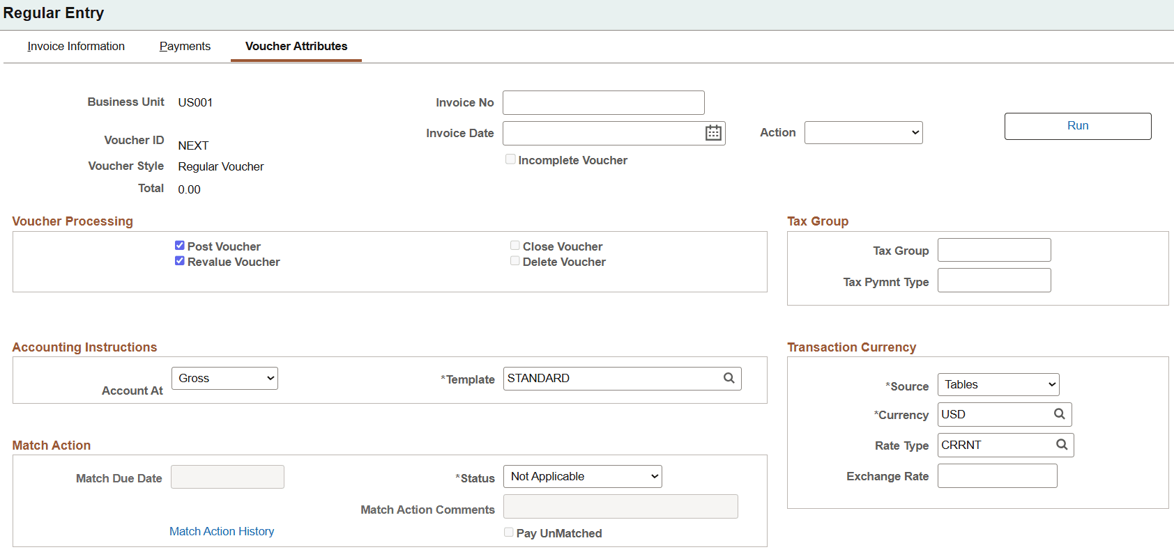

This example illustrates the fields and controls on the Voucher Attributes page, add mode (1 of 2). You can find definitions for the fields and controls later on this page.
Voucher attributes page (1 of 2)

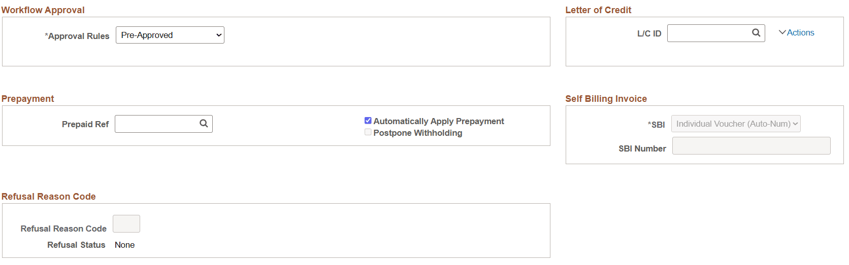

This example illustrates the fields and controls on the Voucher Attributes page, add mode (2 of 2). You can find definitions for the fields and controls later on this page.
Voucher Attributes Page (2 of 2)

Field or Control Description
Incomplete
Indicates whether the voucher is incomplete or not. The Incomplete check box will be selected when you click the Save for Later button. Clicking the Save button will deselect the check box. An incomplete voucher is not eligible for Budget Checking, matching or posting.
The Voucher Search and the Voucher Inquiry component allows the user to search by the Incomplete voucher check box.
Voucher ID validations, currency and the currency exchange data validations are done for the incomplete vouchers. Incomplete vouchers are not picked up by voucher build process.
