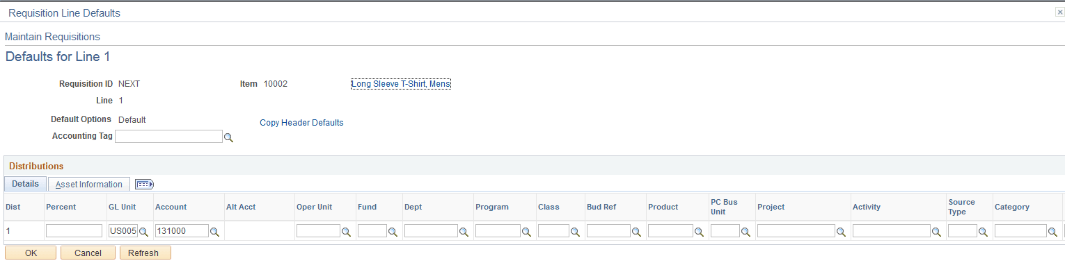

Defaults for Line Page
REQ_LINE_DEFAULTS
Enter default information for a requisition line.
Retrofit field changes to all the distributions on the requisition line Page
REQ_DFLT_RETROFIT
Apply default field-value changes for the requisition line to all distribution lines.

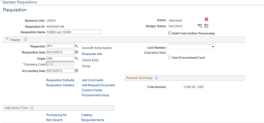

Maintain Requisitions - Requisition Page
Use the Maintain Requisitions - Requisition page (REQ_FORM) to create requisitions online.
Navigation:
Purchasing, and then Requisitions, and then Add/Update Requisitions, and then Maintain Requisitions - Requisition
This example illustrates the fields and controls on the Maintain Requisitions - Requisition page. You can find definitions for the fields and controls later on this page.
Maintain Requisition - Requisition page(1of2)
This example illustrates the fields and controls on the Maintain Requisition - Requisition page(2of2). You can find definitions for the fields and controls later on this page.

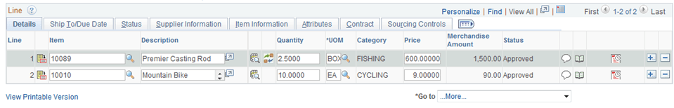

Details
Select the Details tab.
Field or Control Description
Line Details
Click the Details button to access the Maintain Requisitions - Details for Line page. Use this page to view the details for the requisition lines.
Item
Select the ID of the item that you want to order. If the item that you want to order does not have an item ID, you can order the item by description only. To do this, enter item information in the Description field.
Description
Enter a description of the item that is listed in the Item field. If you are ordering an item by description only, enter item information in this field. If you specify an item ID, the description appears from the Purchasing Attributes page.
Item SearchItem Search
Click to access the Item Search Criteria page where you can enter search criteria to locate and select an item that you want to apply to a requisition line. If you select this button from a requisition line with an item ID, you can replace the current item with the item that you select on the Item Search Criteria page.
See Item Search Criteria Page.
Quantity
Enter the item quantity to order. The quantity is recalculated if you change the unit of measure.
When Order Multiples is configured on the Purchasing Attributes page, the system checks order multiples on the Add/Update Requisitions page when you enter or update the line quantity. If the quantity is not a valid multiple, the system displays a warning message with a suggested quantity. You can select Yes to update the quantity or No to keep the entered quantity.
UOM (unit of measure)
Select the unit of measure for the requested item.
Category
Enter the category for the item on the requisition line. If you specify an item ID, the category appears from the Purchasing Attributes page; you cannot change it.
Price
The item price derived through the pricing default hierarchy. You can change this value if it is enabled according to the default hierarchy. If you are ordering an item by description only, enter the item price. The price can also be derived based on contract pricing or price adjustment.
If you are using commitment control, the price field is unavailable for modification when a requisition schedule that is distributed by quantity has been partially or fully sourced to a purchase order. This field is also unavailable for modification when you are creating a change order for a requisition (that is distributed by quantity) that has been partially or fully sourced to a purchase order.
Merchandise Amount
Displays the total amount for the requisition line.
Status
Displays the status of this requisition line.
Use ProCard (use procurement card)
This check box appears as selected for the line if you have the Use Procurement Card check box selected at the header level. If you select this check box, this purchase order line will be charged to the procurement card.
Comments
Select to accesses the Requisition Line Comments page where you can add comments and upload one or more supporting documents.
The system displays an error message if you try to load more than the number of attachments specified on the Application Fundamentals: Installation Options - Multiple Attachments Page for Purchasing product.
Line Default
Click the Line Defaults button to access the Details for Line page. Use this page to maintain line defaults.
Schedule
Click the Schedule button to access the Maintain Requisitions - Schedule page, where you can view schedule shipment details and distribution information.
Cancel
Click the Cancel Line button to cancel the line on the requisition.
Ship To/Due Date
Select this tab to access information about shipment ship date, due dates, and schedules.
See Creating Requisition Schedules.

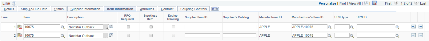

Item Information
Click on the Item Tab on the requisition to view the original sub item, description and item substitution search icon
This example illustrates the fields and controls on the Item Information page. You can find definitions for the fields and controls later on this page.
Requisition - Item Information Page
The Item Info Tab – shows the new item sub fields:
For more Information SeeUnderstanding Item Substitution in Procurement
Original substituted item
Displays the original item ID on a procurement transaction that is being substituted. Once an Original Substituted Item is designated for a procurement transaction, it is carried all the way through to the receipt and cannot be changed. (The field name is also referred to as Original Item in some cases where the Item may or may not have been substituted.)
Substitute Item search
Select to display all the related substitute items
RFQ Required (request for quote required)
Select to indicate that this requisition line must be submitted for supplier quotes before purchase order sourcing. The setting of the RFQ Required check box appears as a default value from the Item Category - Purchasing Item Attribute Hierarchy.
If you can override the RFQ required rule, which you set on the User Preferences: Procurement - Requisition Authorizations page, you can select or deselect the RFQ Required check box on this page.
If you cannot override the RFQ required rule, you can only select the RFQ Required check box if it is deselected. You will receive an error message if you try to deselect the RFQ Required check box if it is selected.
Note: If the RFQ Required check box is deselected, the system checks to ensure that the business unit RFQ-required monetary threshold is defined, checks the line amount, and then sets the RFQ Required check box accordingly. After you save the requisition, the system also matches the requisition distribution ChartField values with the RFQ Rule ChartField values. If a match exists, the system selects the RFQ Required check box.
Stockless Item
Select to indicate that the ordered item is for par replenishment. This check box is available only if the selected item is set up as stockless, according to the default hierarchy for stockless items.
Device Tracking
Indicates whether a line contains a device-tracked item.
Supplier Item ID
Enter the item ID used by the supplier for this item.
Supplier's Catalog
Manufacturer ID
Enter the item ID that the supplier uses for this item.
Manufacturer's Item ID
Enter the manufacturer's item ID that the supplier uses for this item.
UPN Type
Select applicable UPN Type Code.
UPN ID
Select applicable universal product number that is defined by a unique combination of item ID, manufacturer ID, manufacturer item ID, and Unit of Measure.
On selecting the UPN ID, the item line information associated with the selected UPN ID will be populated.
For inventory items, if you have set up the information in the Item Manufacturer UPN table, this information appears by default into the contract. If you order by UPN ID, the item ID and related information is copied to the purchase order or requisition line. The system verifies that the UPN ID is valid for inventory items and matches what is set up in the Item Manufacturer UPN table.
When the Inventory Item ID has been left blank, an attempt will be made to retrieve the Inventory Item (from the Item Manufacturer UPN table) based on the UPN ID entered. UPN ID is the only value required for looking up the item in the Item Manufacturer UPN table. If a match with the Item Manufacturer UPN Table has been found, all of the fields associated with the UPN ID (Item ID, UPN Type, Mfg ID, Mfg Item, and UOM) will be defaulted onto the transaction line along with other Item attributes required for the requisition like Item description, Price, Supplier etc. No confirmation message will be displayed.
Note: For description only items (ad hoc items), you do not have the option to select UPN Type and UPN ID from the prompt. UPN ID and UPN Type values will default from the contract.
Item Search
Clicking on the Item Search Icon will bring up the Substitute Item page (SUB_ITM_SRCH) that will allow the user to view all items available to substitute.
Click on the Item Search icon to bring up the Substitute Item Page
This example illustrates the fields and controls on the Substitute Item Search Page. You can find definitions for the fields and controls later on this page.
For more information on the Substitute Item Search Page See Manual Substitution Understanding Item Substitution in Procurement
Use the Defaults for Line page (REQ_LINE_DEFAULTS) to enter default information for a requisition line.
Navigation:
Click the Line Defaults button on the Maintain Requisitions - Requisition page.
This example illustrates the fields and controls on the Defaults for Line page. You can find definitions for the fields and controls later on this page.
Requisition Line Default page
When you change requisition line default information and exit the page, whether using the Default or Override option set at the header, the system prompts you with the Retrofit field changes to all the distributions on the requisition line page.
Default Options
Displays either Default or Override. This value is defined on the Requisition Defaults page.
SpeedChart
Select a default SpeedChart. The SpeedChart feature enables you to use a code that contains preset distributions.
Note: The field is enabled only when the default option is set to override.
Note: Accounting Tags appear in lieu of Speedcharts when the Accounting Tag check box is selected for Purchasing on the Accounting Tag Registration page. See Application Fundamentals: Setting Up Accounting Tags
Accounting Tag
Enter an Accounting Tag that will be used to populate ChartFields on transaction distribution lines. The system automatically prorates the distribution amounts according to the proration percentages defined on the Accounting Tag.
Copy Header Defaults
Click to copy requisition header distribution defaults to the line.
Details Tab
Enter the percentage for each distribution in the distribution details. The sum of the line distribution percentages must equal 100 percent. If the Default Options field is set to Override, you can set up multiple distribution lines.

Item Information
Supplier's Catalog and Supplier Item ID
The supplier catalog and item ID assigned to the selected item-supplier combination appear. These values are supplied by default from the Purchasing Attributes - Item Supplier page.
The setting of the RFQ Required check box appears by default from the Item Category - Purchasing Item Attribute Hierarchy.
Select this check box to indicate that this requisition line must be submitted for supplier quotes before purchase order sourcing.
If you cannot override the RFQ required rule, you can select the RFQ Required check box only if it is deselected. You receive an error message if you try to deselect the RFQ Required check box if it is selected.
Note: If the RFQ Required check box is deselected, the system checks to ensure that the business unit RFQ Required Monetary Threshold is defined, checks the line amount, and then sets the RFQ Required check box accordingly. When you save the requisition, the system also matches the requisition distribution ChartField values with the RFQ Rule ChartField values. If a match exists, the system selects the RFQ Required check box.
Stockless Item
Device Tracking
Configuration Info (configuration information)
Click to access the Configuration Information page. For this link to be available, the line item must have configuration information with which it is associated. In addition, the requisition must have a PeopleSoft Inventory business unit defined and the Consolidate with other Reqs check box must be deselected.
UPN Type
UPN ID
