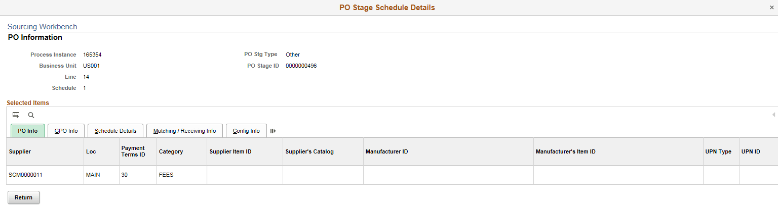

Sourcing Workbench - PO Information (purchase order information) Page
PO_STG_SCHED_DTLS
View details about the purchase order that is going to be created.

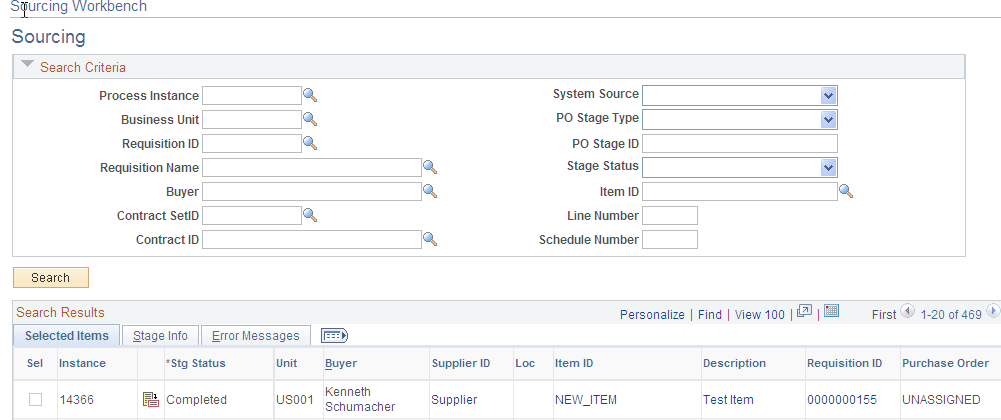

Sourcing Workbench - Sourcing Page
Use the Sourcing Workbench - Sourcing page (PO_SRC_ANALYSIS) to select sourcing criteria and view the rows of data on the PO_ITM_STG table.
Use pages to change the recommended supplier, quantities sourced to each supplier, or correct errors. Along with narrowing the search to specific criteria such as process instances, requisition IDs, purchase order ID, stages, and statuses, you can also search for specific contract SetIDs and contract IDs.
Navigation:
Purchasing, and then Purchase Orders, and then Stage/Source Requests, and then Sourcing Workbench, and then Sourcing Workbench - Sourcing
This example illustrates the fields and controls on the Sourcing Workbench — Sourcing. You can find definitions for the fields and controls later on this page.
Use this page to define the criteria that you want to use to view or update a purchase order line and its sourcing details. After defining search criteria, click the Search button to view the search results based on the criteria. The system provides the search results in the lower porting of the page and you can click on links to view vendors, items, requisition, and purchase order details. You can also select the Stage Info tab to view additional details about the staged line, including for example, the contract SetID, contract ID, and contract line if the row is associated with a contract. Finally, you select the Message tab to view messages for a row of data when its stage status is Error.

After defining selection criteria, click the Search button and the system returns the item data rows that match the criteria.
Sourcing Workbench Search Results
The system displays the search results on the Selected Item, Staged Rows, and Message tabs. Using the tabs you can link to a variety of information about the staged item. Select the Sel (select) check box to mark a specific row of data for processing. You can only select the field if the row of data is available for updating.
Along with linking to staged row details, you can use this page to purge and recycle multiple rows in a staged status. You can only perform the recycle and purge actions against those rows of data that have not been greyed out. When the staged status for a row is in a status that cannot be recycled or purged, the system provides error messages when you attempt to set the row for purging or recycling.
After making your selections and clicking the Purge or Recycle button, click Save. The system applies the changes. When you select rows, but the system does not apply an action to the rows, the system deselects the rows after you perform the action.
The system does not issue error messages for actions taken on multiple rows. Messages are only issued for single row changes.
When Order Multiples is configured on the Purchasing Attributes page, the system checks order multiples during the PO creation process. If the quantity does not meet the order multiple requirement, the system displays a sourcing error in the Sourcing Workbench and in the Procurement WorkCenter. The buyer must update the requisition quantity to a valid multiple and run the process again.

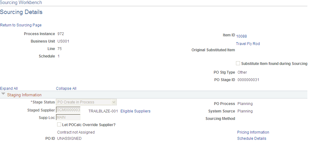

Sourcing Workbench - Sourcing Details Page
Use the Sourcing Workbench - Sourcing Details page (PO_SRC_ANLSYS_DTL) to view further details about a staged row and how to change the supplier and stage status.
Navigation:
Click the Sourcing Details button on the Sourcing Workbench - Sourcing page.
This example illustrates the fields and controls on the Sourcing Workbench - Sourcing Details page (1 of 2). You can find definitions for the fields and controls later on this page.
This example illustrates the fields and controls on the Sourcing Workbench - Sourcing Details page (2 of 2). You can find definitions for the fields and controls later on this page.
Field or Control Description

Stage Status
Select a stage status. You can change the stage status from Error to Recycle or to Reset/Purge after you have corrected the error on this row, so that the PO Calculations process can reprocess the staged row.
To recycle and purge multiple staged rows of a purchase order, click the Return to Sourcing Page link.
If the PO Calculations process fails, change the status from POCALC to Recycle as long as the process is no longer running.
If the length of federal award fields exceed the length values defined in the setup, or if you enter values into the PIID and Parent PIID is not defined, then the sourcing workbench stage status shows error.
PO Process (purchase order process)
Displays the sourcing process used to place the row of data into the staged table. Examples of the processes include contract purchase order, manufacturing load, and autoselected by the system.
Staged Supplier
Select a different supplier. This field is available for entry when the stage status is Staged, Pending (pending approval), Error, or Recycle. An item supplier relationship must exist if the Accept Any Supplier option is N (no) at the business unit or item level.
If you are using the Flexible sourcing method and have run the PO Calculations process, all eligible suppliers appear on the Eligible Suppliers page. Choose a supplier on the Eligible Suppliers page by selecting the Use This Supplier option.
To make an informed decision about the supplier selection, use the Flexible Sourcing page to view all factors involved in the selection of the recommended supplier by the PO Calculations process.
If you change the supplier for a schedule, there are other schedules on the same purchase order line, and the line is priced at the line quantity, the system issues a warning that all schedules must be priced again. If you choose to reprice the schedules, the stage status on each one changes to Recycle.
When you change the supplier, the Let POCalc Override Supplier check box is clear, to ensure that the PO Calculations process does not choose a different supplier.
Supplier Loc (supplier location)
You can enter a different supplier location under the same circumstances that you can change the supplier for this staged row.
Select to allow the PO Calculations process to override the supplier for this line. To use the supplier that you select for this line, ensure that this check box is clear.
Contract ID
Displays the contract number associated with this process instance. Click the link to view details about the contract, including its SetID, contract ID, and contract line.
Pricing Information
Click this link to access the Sourcing Workbench - Pricing Information page. The page provides details about the pricing of the item from the requisition.
See Sourcing Workbench - Pricing Information Page.
PO ID (purchase order ID)
Displays the purchase order to which this line was sourced. If the line is split sourced and multiple purchase orders are created, the Multiple link appears.
Supplier Details
Click to access the Supplier Information page where you can search for and maintain supplier details.
Eligible Suppliers
Click this link to access a secondary page with details about the supplier for this item. Included in the details are the supplier ID, whether or not its a recommended supplier, the requisition quantity and the sourcing method.
See Eligible Suppliers Page.
Schedule Details
Click this link to access the Sourcing Workbench - PO Information page where you can view details about the purchase order that is going to be created.
See Sourcing Workbench - PO Information (purchase order information) Page.
Use the Sourcing Workbench - PO Information (purchase order information) page (PO_STG_SCHED_DTLS) to view details about the purchase order that is going to be created.
Navigation:
Click the PO Schedule Information link on the Sourcing Workbench - Sourcing Details page.
This example illustrates the fields and controls on the Sourcing Workbench - PO Information page. You can find definitions for the fields and controls later on this page.
PO Stage Schedule Details page
Payment Terms ID
Identifies the payment terms that appear on the purchase order header.
UPN Type
Displays the UPN Type for the PO line.
UPN ID
Displays the UPN ID for the PO line.
GPO Info
Select the GPO Info tab.
GPO ID
Displays the group purchasing organization ID.
GPO Contract Number
Displays the group purchasing organization contract number.
Schedule Details
Select the Schedule Details tab.
Freight Terms
Identifies the freight terms code that applies to the schedules for the purchase order.
Replenish Code
Displays the PeopleSoft Inventory replenishment code for this distribution.
Inspect
If this check box is selected, indicates that inspection is required for the line.
Matching/Receiving Info
Select the Matching/Receiving Info tab.
Unit Price Tolerance and % Unit Price Tolerance
Indicates the amount and percentage variation allowed in the unit price of this item when matching the purchase order, voucher, and receipt.
Ext Price Tolerance (extended price tolerance) and % Ext Price Tolerance
Indicates the amount and percentage variation allowed in the extended price of this line when matching the purchase order, voucher and receipt. Extended price is the quantity ordered multiplied by the item unit price or the item supplier UOM price.
Rjct Ovr % (reject over percent)
Receiving cannot accept a shipment from the supplier that exceeds this percentage of quantity over shipped.
Receiving Required
Displays the receiving requirement for the item. Values are:
  • Do Not: If displayed, accounts payable matching and receipt accrual are not applicable.
  • Optional: If displayed, accounts payable will not match receipt lines and the system will not accrue the receipt.
  • Required: If displayed, accounts payable will match receipt lines and the system will accrue the receipt.
Early Ship Rjct Days (early ship reject days)
Receiving cannot accept a shipment that is received early by the number of days indicated by this value.
Config Info (configuration information)
Select the Config Info tab.
Template
The configuration code template ID appears if the item is a configured item.
Config Code (configuration code)
If this is a configured item, the configuration code appears.
