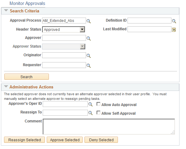

Monitor Approvals Page
Use the Monitor Approvals page (EOAW_ADM_MON_SRC) to search on approval processes and perform mass reassignments.
Navigation:
Workforce Administration, and then Self Service Transactions, and then Approvals and Delegation, and then Monitor Approvals, and then Monitor Approvals
This example illustrates the fields and controls on the Monitor Approvals page (1 of 2). You can find definitions for the fields and controls later on this page.
This example illustrates the fields and controls on the Monitor Approvals page (2 of 2). You can find definitions for the fields and controls later on this page.
For a complete description of this page, see PeopleSoft Approval Framework, "Using the Approval Monitor."
See Approval Framework: Using the Approval Monitor.
Administrative Actions
Field or Control Description
Approver's Oper ID (approver's operator ID)
Select the operator ID of the approver to whom the approval transaction is assigned.
Reassign To
Select the operator ID of the person to whom you want to reassign approval transactions for the specified approver in the Approver's Oper ID field.
Allow Auto Approval
Select to allow auto approval of approval transactions that are assigned to the specified approver.
Allow Self-Approval
Select to allow the specified approver to approve transactions on their own behalf.
Comment
Enter a comment to describe the mass reassignment. The comment becomes part of the transaction itself.
Reassign Selected
Click to reassign the approval transactions from approver in the Approver's Oper ID field to the person specified in the Reassign To field. The system reassigns only the approval transactions that you have selected in the search results.
