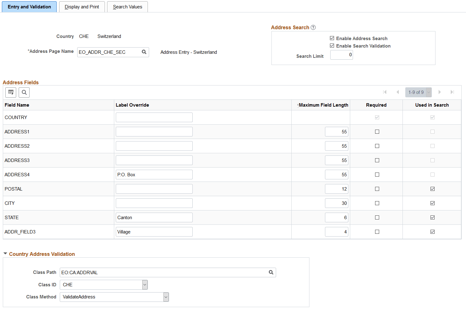

Entry and Validation Page
Use the Entry and Validation page (ADDR_FORMAT_TABLE) to set address fields and validation for a country.
Navigation:
Set Up HCM, and then Install, and then Country Address Format Table, and then Entry and Validation
This example illustrates the fields and controls on the Entry and Validation page when using the standard delivered address page for a country.

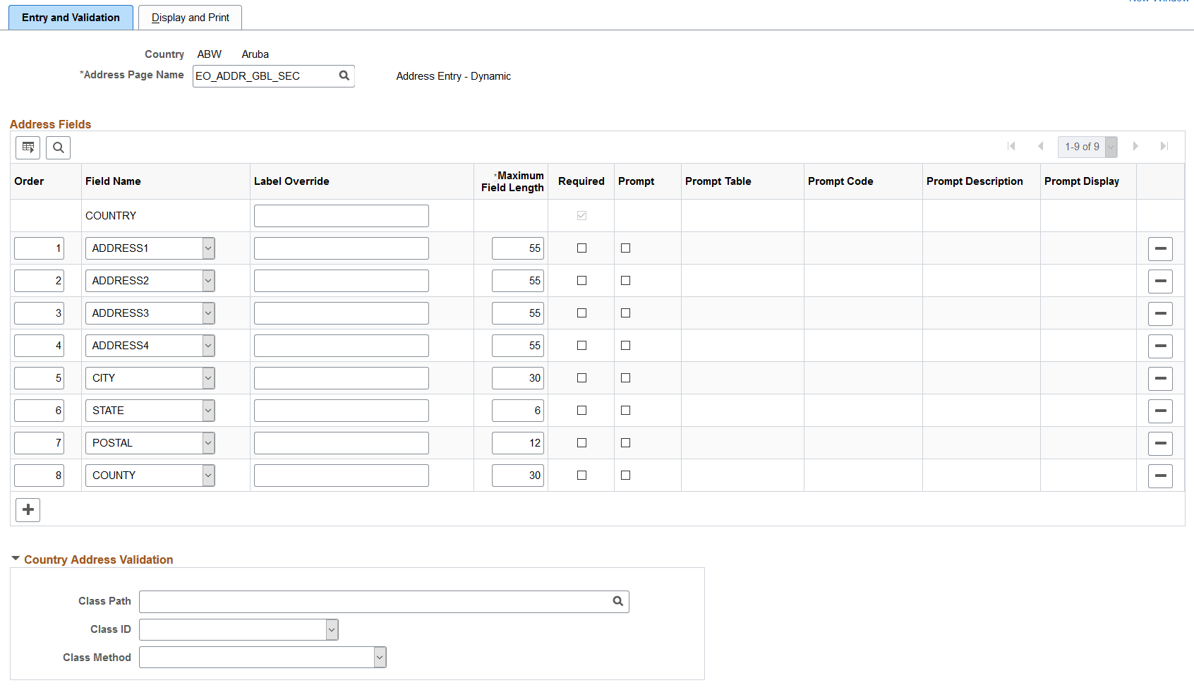

This example illustrates the fields and controls on the Entry and Validation page when using the dynamic global address page EO_ADDR_GBL_SEC.
Entry and Validation page when using the dynamic address page EO_ADDR_GBL_SEC
Field or Control Description
Address Page Name
Select an address page from the list of available options. The system will display the list of fields on that page in the Address Fields group box.
To use the global address formatting feature, enter the EO_ADDR_GBL_SEC (Address Entry - Dynamic) page to enable additional field options and add or delete fields from the address display.
Note: When using a country specific page (for example, EO_ADDR_ARG_SEC) or the Address Entry - Default page name (i.e.-EO_ADDR_DFT_SEC), you cannot add or remove the fields on this page.
Address Search
This group box is available when the country is configured to use address searching. As delivered, the page displays this group box for four country address pages: Japan, Switzerland, Italy and Netherlands.
To enable the use of address search and validation for other countries, you need to load values into the EO_ADDR_VALIDAT table for the country through a batch utility or with SQL.
Enable Address Search
Select to enable users to search for a valid value. Select this check box to enable the Used in Search column and the Search Values Page. The system provides this check box deselected by default.
Enable Search Validation
This check box is available when Enable Address Search is selected.
Select to have addresses entered by users checked against the address values on the Search Values Page. When no match is found, the system will display a warning to the user.
Search Limit
Enter a numeric value to limit the number of search results.
Address Fields
These fields are available for all address page types, unless otherwise indicated.
Field Name
Displays the address fields available in the PeopleSoft HCM based on the Address Page Name value you selected.
Note: When you add a new country, the address fields default to those of the EO_ADDR_DFT_SEC page, even though the Address Page Name defaults to EO_ADDR_GBL_SEC.
Label Override
Enter a different label to override the displayed Field Name, if required for this country. For example, you some countries may use the term Province instead of State.
Maximum Field Length
(Fluid) Enter a number to identify a field length on the Fluid pages. The field length is provided by default from the database level, which you can override and limit the visible length at runtime by styling.
Note: Updating the maximum field length here does not update the field length for the classic pages.
If the user enters more characters than the specified number, an error message is triggered, both in fluid and classic.
Required
Select if a field is required before a user can save the entry.
Used in Search
This option is available when the Enable Address Search check box is selected.
Select to have the system to use this field as a prompt when searching for a valid address.
Address Fields (Dynamic Address Page for Editing)
These additional fields are available when you use the EO_ADDR_GBL_SEC (Address Entry - Dynamic) address page.
Order
Enter the default order, lowest to highest, the address fields should appear on the data entry pages.
Note: The position of the Country field is fixed, since you need to select the country first to determined the other address fields.
Prompt
Select the Prompt check box to enable the prompt fields on this page. This will allow you to re-purpose the field by defining a prompt table.
Prompt Table, Prompt Code, and Prompt Description
Select the prompt keys which match the address field.
Prompt Display
Select if the field should be a Drop Down or a Prompt Table.
Country Address Validation
Use this collapsible section to enable country-specific address validation. PeopleSoft HCM delivers validation for 23 countries: Argentina, Australia, Belgium, Brazil, Canada, China, Czech Republic, France, Germany, Greece, Italy, Japan, Mexico, Netherlands, New Zealand, Poland, Portugal, Thailand, South Korea, Spain, Switzerland, United Kingdom and United States.
You should only need to modify this information if the existing validation is not sufficient.
Class Path
Select a path that uses a specific class within the root package.
The system delivers the classes in the EO:CA:ADDRVAL application package, but you can add formatting or validation by writing extensions of the new classes for specific address formats.
Class ID
Enter the name of the application class that contains the method to be invoked.
Class Method
Enter the name of the method to be invoked.
The framework uses the ValidateAddress method for the delivered classes.

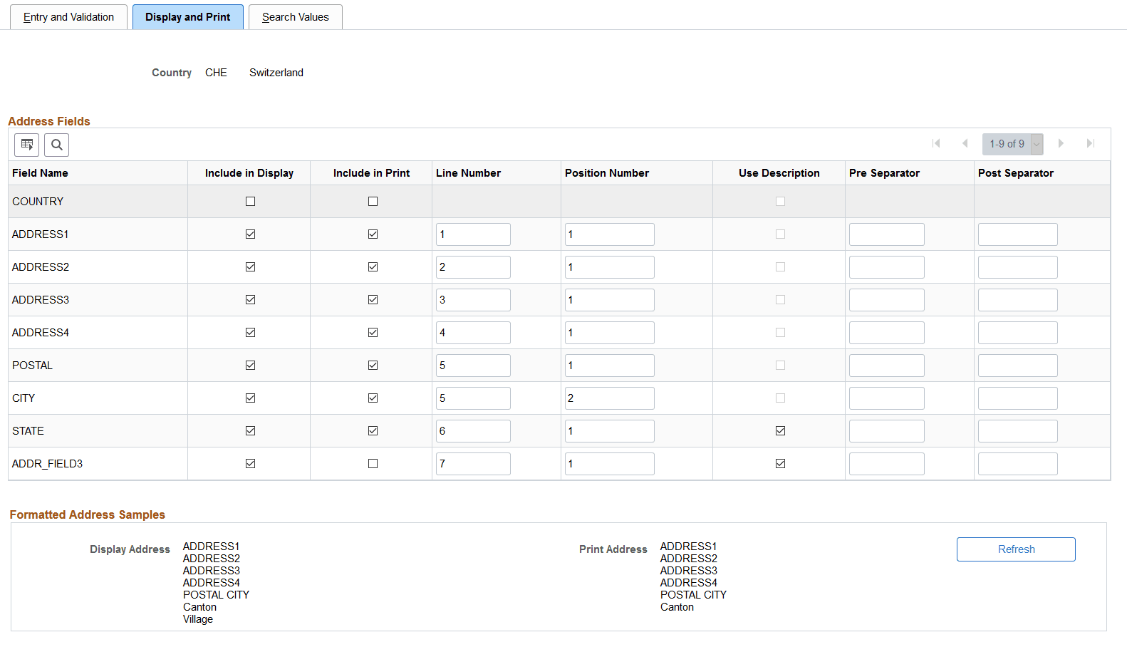

Display and Print Page
Use the Display and Print page (ADDR_FORMAT_DISP) to specify the address format for the country that is selected from the Country Table.
Navigation:
Set Up HCM, and then Install, and then Country Address Format Table, and then Display and Print
This example illustrates the fields and controls on the Display and Print page.
Address Fields
Field Name
Displays the address fields available in the PeopleSoft HCM.
Include in Display
Select to have the system include this field when an address appears in read-only mode. Deselect this check box for specific fields if your organization wants to display addresses in a format that is different from how addresses appear during data entry.
Include in Print
Select to have the system print this field whenever an address in this country will be printed.
Line Number
Enter the line on the page on which this field should appear.
Position Number
Indicate this field's position in the selected line.
Use Description
Select to have the system display a full description for this field instead of the code, where applicable.
Pre Separator and Post Separator
Enter separator characters for the address elements if applicable (for example and em dash).
Formatted Address Samples
This section shows how the address will be displayed online and in print format with the current settings.
Refresh button
Click to update the samples to the current configuration.
Note: The samples use the field's description (e.g. State) if the Use Description check box is selected. Otherwise, it uses the field name (e.g. STATE).

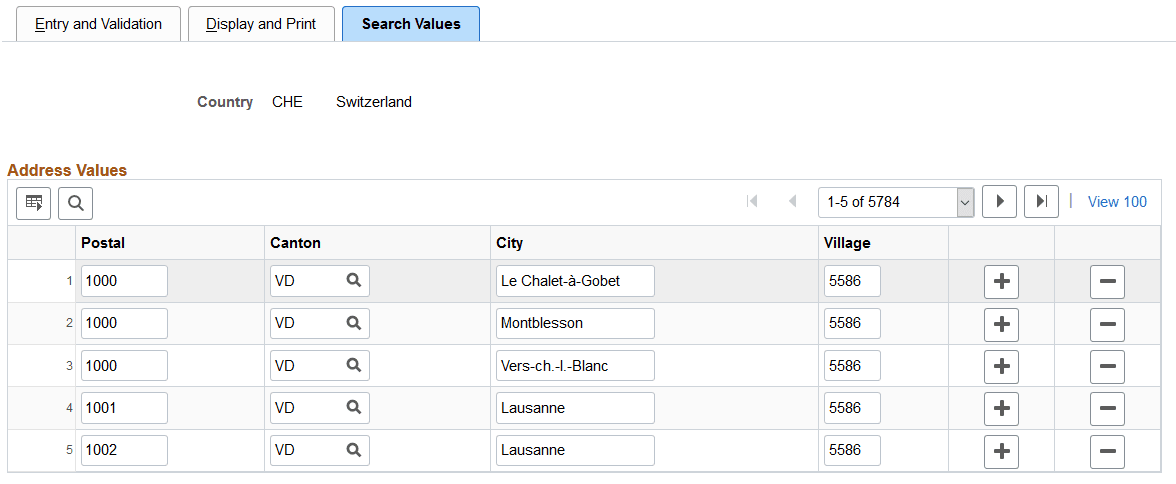

Search Values Page
Use the Search Values page (EO_ADDR_VALIDAT) to make corrections, deletions, or incremental additions to specify the valid address values for the country.
This page is available for those countries that are enabled for search validation. As delivered, this page is populated for four countries: Japan, Switzerland, Italy and Netherlands.
Navigation:
Set Up HCM, and then Install, and then Country Address Format Table, and then Search Values
This example illustrates the fields and controls on the Search Values page.
Search Values page
Addresses Values
This page stores state/province codes with corresponding cities, as entered on the State/Province page. When you select Enable Search Validation on the Entry and Validation Page, the system checks address entries against the values stored on this page to verify that the search address fields match. You can also use it to add valid combinations of address fields.
(JPN) Japanese postal data is stored in both the Postal Code Table and this table (EO_ADDR_VALIDAT). To keep this table in sync with the Postal Code Table, you must enter new postal data in the Postal Code Table page. The system will not update the Postal Code Table with values you enter on this page.
