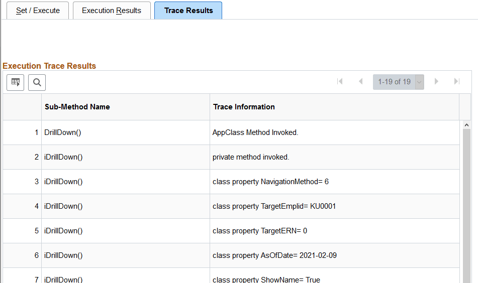

Test Direct Reports Results - Trace Results Page
HR_DRPT_API_TRACE
View the trace log of a method execution.

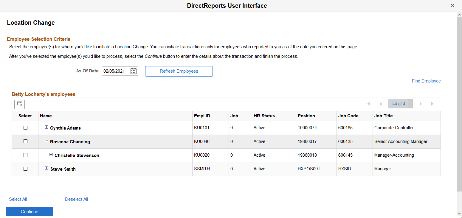

DirectReports User Interface Page
HR_DR_DIRECTREPORT
View a list of direct reports and select employees to add to the API Results list on the Invoke Direct Reports UI API page.

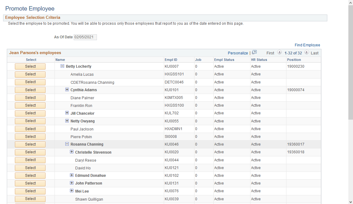

(Classic) <Transaction Name> - Employee Selection Criteria Page
HR_DR_DIRECTREPORT
View a list of your direct reports and select from these employees to perform transactions using the classic pages.

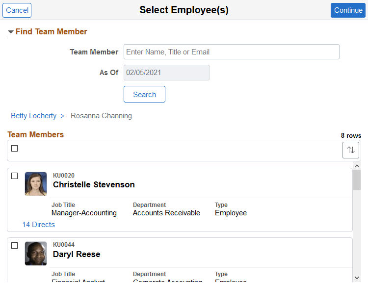

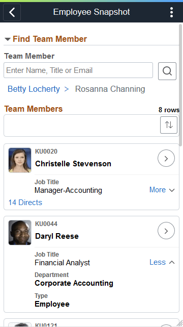

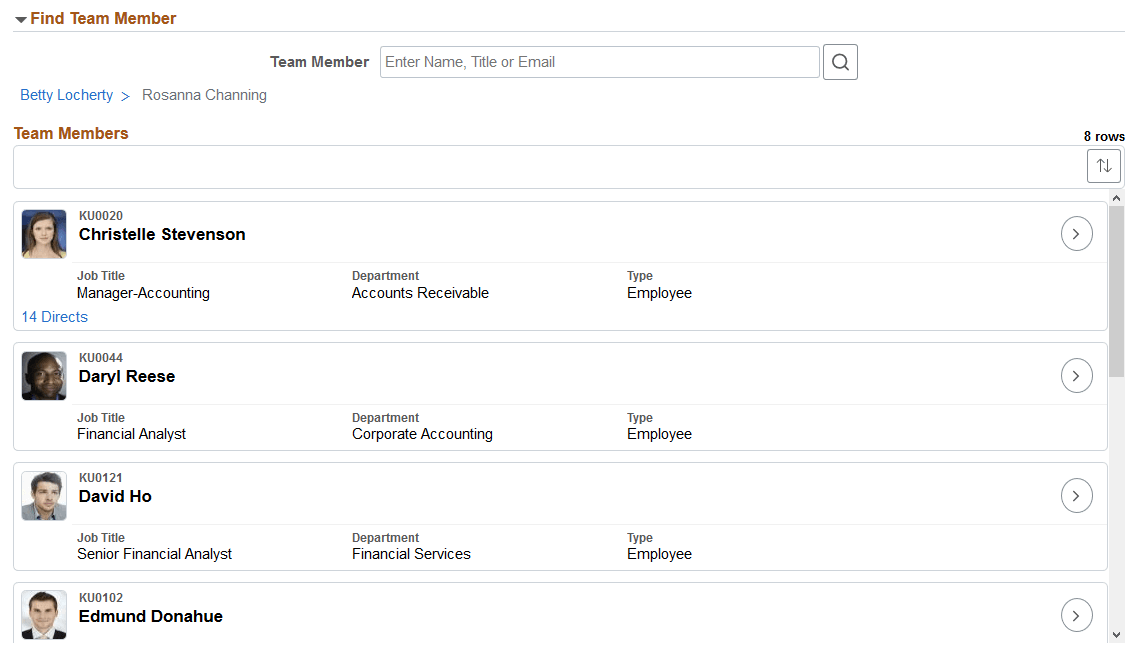

(Fluid) <Transaction Name> - Find Team Member Page
HR_PSEL_FLU
View a list of your direct reports and select from these team members to perform a transaction using the fluid pages.

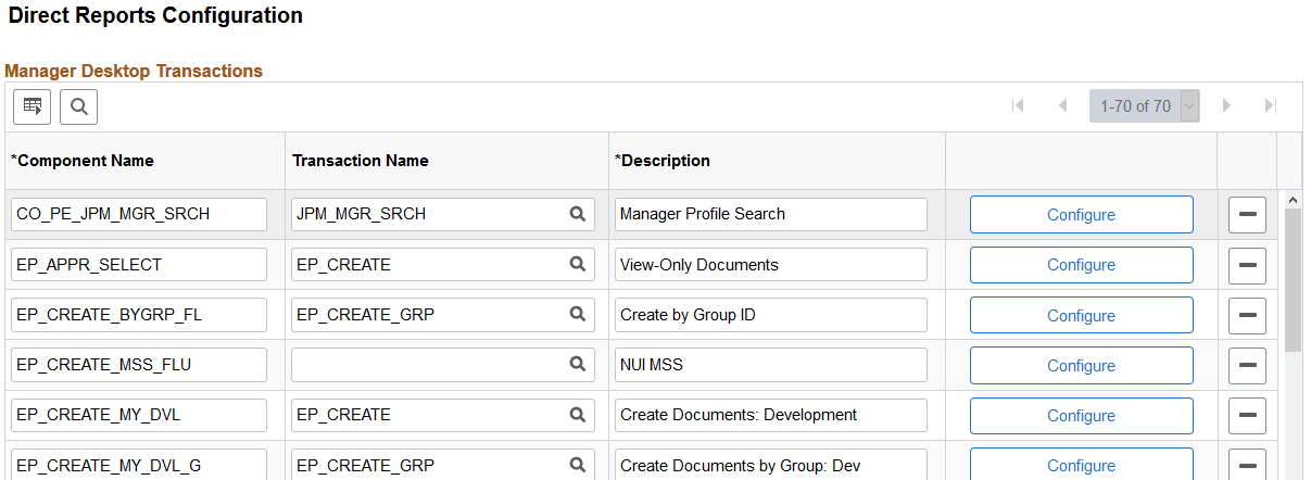

Direct Reports Configuration Page
Use the Direct Reports Configuration page (HR_DR_UI_CFG_1) to configure the components and transactions that include the direct reports data functionality.
Navigation:
Set Up HCM, and then Common Definitions, and then Direct Reports for Managers, and then Direct Reports Interface, and then Direct Reports Configuration
This example illustrates the fields and controls on the Direct Reports Configuration page. You can find definitions for the fields and controls later on this page.
Displays a list of components and transactions for which direct reports functionality is enabled. You can add a new component and transaction or click the Configure button to specify how the direct reports API and UI function within the context of the component and transaction.

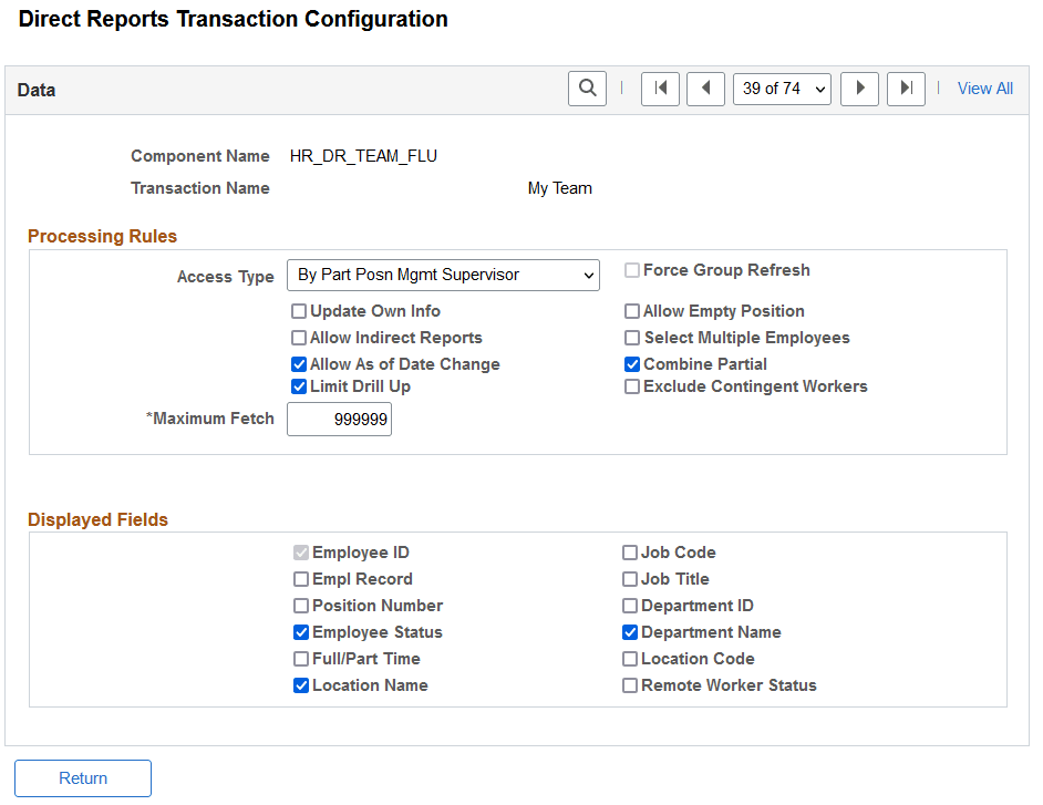

Direct Reports Transaction Configuration Page
Use the Direct Reports Transaction Configuration page (HR_DR_UI_CFG_2) to select the actions and fields that appear on the direct reports UI for a transaction.
Navigation:
Click the Configure button for an application on the Direct Reports Configuration page.
This example illustrates the fields and controls on the Direct Reports Transaction Configuration page. You can find definitions for the fields and controls later on this page.
Processing Rules
Field or Control Description
Access Type
Select the reporting relationship to use for determining who reports to whom. This field defines the reporting relationship used by the Select Employee page for this transaction component and determines which method is used to identify who approves the transaction. Available options are:
  • By Department Manager ID: Defines the reporting relationship based on information in the Manager ID field on the Department Profile page (DEPARTMENT_TBL_GBL). For users who are department managers, the system displays a list of the workers who are in the user's department.
  • By Dept Security Tree: Determines person data access using information from the security tree. The system presents the user with a list of people whose data the user has access to, based on the security tree.
  • By Group ID: Determines data access using the Group ID set up in the group build feature.
  • By Part Posn Mgmt Dept Mgr ID: Defines the reporting relationship by the Reports To field on the Work Location page (JOB_DATA1) and the information in the Manager ID field on the Department Profile page. This is designed for the organizations that use Partial Position Management. The system searches for reporting relationship based on Report To first, and then for Department Manager ID.
  • By Part Posn Mgmt Supervisor: Defines the reporting relationship by both the Reports To and the Supervisor ID fields on the Work Location page. This is designed for the organizations that use partial Position Management. The system searches for reporting relationship based on Report To first, and then for Supervisor ID.
  • By Reports To Position: Defines the reporting relationship based on information in the Reports To field on the Work Location page. The system presents the user with a list of people whose job record indicates that they report to that user's position.
  • By Supervisor ID: Defines the reporting relationship based on information in the Supervisor ID field on the Work Location page. The system presents the user with a list of people whose job records indicate that they are supervised by the user.
Update Own Info
Select to indicate that the user can update their own records. When you select this check box, the manager's information is returned in the direct reports results list along with their direct reports or management hierarchy.
Allow Indirect Reports
Select to return indirect reports of the user. This navigates down the organizational hierarchy and returns direct reports of direct reports and so forth until the lowest reporting level is reached.
Allow As of Date Change
Select to enable the ability to change the as of date.
Limit Drill Up
Select to limit the drill up.
Maximum Fetch
Enter the maximum amount of rows the system should retrieve.
Force Group Refresh
Select to run the Group Build process (GBP002) to refresh the group membership prior to displaying direct reports. If you do not select this check box, the group members as of the last scheduled run of the process appear on the page. The system only makes this check box available if you select the access type By Group ID.
Allow Empty Position
Select to return unfilled position reports. This check box is available when you select one of the position-related options as an access type.
Select Multiple Employees
Select to enable the user to select more than one worker from the search results. If this field is selected, a check box appears next to the names in the results list, otherwise a Select button appears.
Note: You should not modify this value on delivered transactions, as they are built for selection of single or multiple values and if you change the setting, the transaction as delivered might not work.
Combine Partial
Select to indicate, when using one of the partial position management navigation methods, that the secondary method be applied even if the primary method returns valid data.
Exclude Contingent Workers
Select to not include contingent workers in the direct line reporting hierarchy.
Displayed Fields
Select one or more fields to appear within the direct reports list when rendered by the application.
Options may vary based on the component.

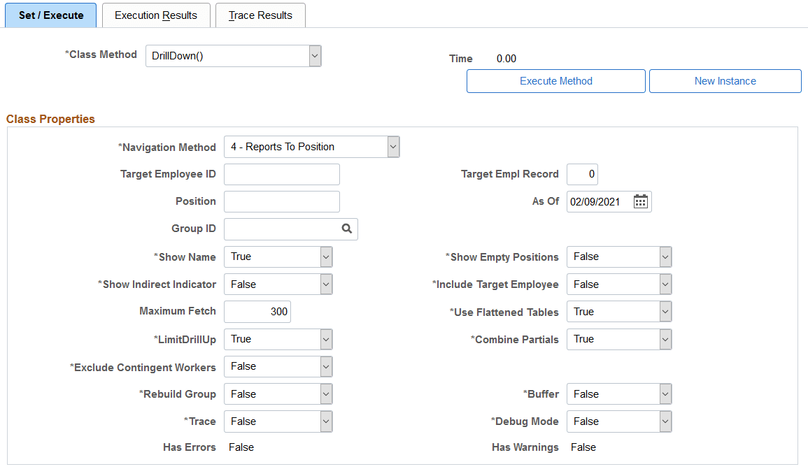

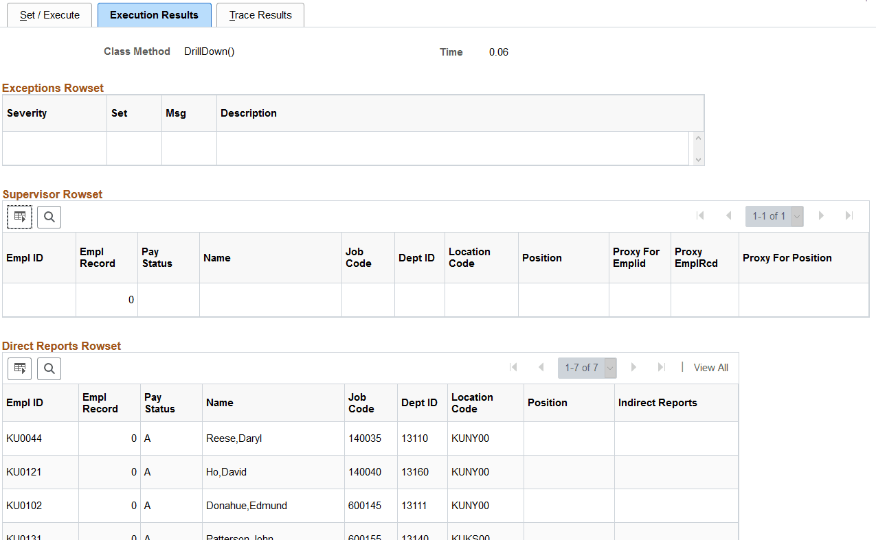

Test Direct Reports Results - Set / Execute Page
Use the Test Direct Reports Results - Set / Execute page (HR_DRPT_API_EXEC) to test the direct reports API.
Navigation:
Set Up HCM, and then Common Definitions, and then Direct Reports for Managers, and then Test Direct Reports Results, and then Set / Execute
This example illustrates the fields and controls on the Test Direct Reports Results - Set / Execute page. You can find definitions for the fields and controls later on this page.
Class Method
Select a method from the available options:
  • DrillDown()
    Logically navigates down one level in the reporting structure to expose all of the direct reports for the worker . This is the most common use of the application class — this method returns the direct reports for a worker/job.
  • DrillUp()
    Logically navigates up one level in the reporting structure to expose the worker's supervisor and all the supervisor's direct reports.

Class Properties
The properties and their default values, if any, of the selected class appear in this page region. You can change any of these before executing the method.
Navigation Method
Select the method to use when determining reporting relationships. The options are: 1 - Department Security Tree, 2 - Supervisor ID, 3 - Department Manager ID, 4 - Reports To Position, 5 - Position / Supervisor ID, 6 - Position / Dept Manager, and 7 - Group ID.
Target Employee ID
Enter the employee ID of the target employee.
Target Empl Record
Enter the employee record number of the target employee.
Position
Enter the position of the target employee.
As Of
Enter the as of date to use when determining reporting relationships.
Group ID
Enter a group ID when Navigation Method is Group ID.
Show Name
Indicate if the system should include employee names in the Direct Reports Rowset grid. The default value is True.
Show Empty Positions
Identify whether unfilled positions should be returned in the Direct Reports Rowset grid when the navigation method is position-based. The default value is False.
Show Indirect Indicator
Identify whether the Direct Reports Rowset grid should indicate whether an employee has direct reports. The default value is False.
Note: Not applicable when Navigation Method = Department Security or Group ID.
Include Target Employee
Should the target employee be filtered out of the returned Direct Reports Rowset and Supervisor Rowsets grids. When True, the target employee is not filtered out. When False (which is the default), circular reporting relationships are not shown.
Maximum Fetch
Enter the maximum number of rows to return.
Use Flattened Tables
Select True or False.
For better performance, the PeopleSoft application provides the framework for creating flattened views of reporting structures so that they can be accessed easily.
LimitDrillUp
Indicate if the user be allowed to DrillUp to a level higher than the target employee/job that was first specified. For example, when used in a manager self-service transaction, should I be able to drill down 2 levels, and then up 3 levels to expose and select my peers? On the other hand, when used in a notification process, drilling up beyond the initial target employee/job is essential. When True (which is the default), DrillUp is limited.
Combine Partials
Indicate, when using one of the partial position management navigation methods, whether the secondary method be applied even if the primary method returns valid data. The default value is True.
Rebuild Group
Specify, when the Navigation Method is Group ID, if the system should force the group to be rebuilt, even if group results for this effective date already exist.
Buffer
Indicate if the service should buffer the next level up and down to increase performance. The default value is False.
Trace
Indicate if the service should generate a trace of processing when executing class method. The default value is False.
Debug Mode
Specify, when Debug Mode = True, if any exceptions encountered during execution should be displayed prior to the results set being displayed.
Test Direct Reports Results - Execution Results Page
Use the Test Direct Reports Results - Execution Results page (HR_DRPT_API_RSLTS) to view the exceptions and data returned by a method.
Navigation:
Set Up HCM, and then Common Definitions, and then Direct Reports for Managers, and then Test Direct Reports Results, and then Execution Results
This example illustrates the fields and controls on the Test Direct Reports Results - Execution Results page. You can find definitions for the fields and controls later on this page.
This page enables you to view results of the method execution.
Use the Test Direct Reports Results - Trace Results page (HR_DRPT_API_TRACE) to view the trace log of a method execution.
Navigation:
Set Up HCM, and then Common Definitions, and then Direct Reports for Managers, and then Test Direct Reports Results, and then Trace Results
This example illustrates the fields and controls on the Test Direct Reports Results - Trace Results page. You can find definitions for the fields and controls later on this page.
Data appears on this page only if you select True for the Trace class property.
Use the DirectReports User Interface page (HR_DR_DIRECTREPORT) to view a list of direct reports and select employees to add to the API Results list on the Invoke Direct Reports UI API page.
Navigation:
Select a value from the Component Name field and click Execute API button on the Invoke Direct Reports UI API page.
This example illustrates the fields and controls on the DirectReports User Interface: <Transaction Name> - Employee Selection Criteria page through the DirectReports User Interface page access.
Where <Transaction Name> represents the name of the application page and transaction you are accessing.
This example also displays Select as a check box option, where you can select multiple team members for this transaction.
DirectReports User Interface page showing an example of the Location Change - Employee Selection Criteria page
This page displays the classic interface for any component defined with a Direct Reports Configuration. Although you can select fluid components from the Invoke Direct Reports UI API Page, you can only view it using the classic user interface from this page.
When you select the direct reports, the direct reports plug-in executes within the context of the component and returns the results to the API Results grid on the Invoke Direct Reports UI API page.
Managers will access the (Classic) <Transaction Name> - Employee Selection Criteria Page to select direct reports when using the classic pages. See this page for field definitions.
Use the <Transaction Name> - Employee Selection Criteria page (HR_DR_DIRECTREPORT) as a manager to view a list of your direct reports and select from these employees to perform transactions using the classic pages.
The page displays team members based on the direct reports configuration for the classic Transaction Name.
Where <Transaction Name> represents the name of the application page and transaction the manager is accessing.
Navigation:
As a manager, access an application transaction component where you need to select one of your employees.
This example illustrates the <Transaction Name> - Employee Selection Criteria page when a manager accesses a system transactional page that requires him or her to select one of their team members using the classic pages. This example also displays Select as a button, where you can only select one employee for this transaction.
Example of the Promote Employee - Employee Selection Criteria page where a manager selects an employee
Use this page to select the direct reports. Click the + (expand) button next to an employee’s name to drill down and view their reports. Click the - (collapse) to hide the direct reports of a person.
Field descriptions for the example, and for any <Transaction Name> – Employee Selection Criteria page (HR_DR_DIRECTREPORT), are as follows.
Find Employee link
This link appears on the right, above the grid header.
To search within your direct reports organization, click the Find Employee link, which enables you to select from the same list of direct and indirect reports as if you expanded all nodes.
Note: The Direct Reports UI setup determines which employees are available for selection and which fields appear on the <Transaction Name> - Employee Selection Criteria page.
When you select this link, the system displays the Find Employee page (HRDR_SRCH_EMPS_SEC), where you can enter search criteria. You can select an employee from this page to open in the transaction.
Note: The Find Employee page allows you to select only one employee from the search results. It does not allow you to select groups of individuals.
Select button
The Select button appears when the transaction applies to one individual. Managers click this button to be taken to the transaction page for this person.
Select check box, and Continue button
The Select check box appears for transactions where you can select groups of individuals for whom you will perform the transaction.
After selecting employees, the manager clicks the Continue button to perform the transaction for all the selected employees. For example, a manager can transfer multiple employees to a new location at the same time.
HR Status
The HR Status field appears on the Employee Selection Criteria page only if the Allow Indirect Reports check box is selected on the Direct Report Transaction Configuration page
Inactive employees can have active employees reporting to them directly or indirectly.
Use the <Transaction Name> - Find Team Member page (HR_PSEL_FLU) as a manager to view a list of your direct reports and select from these team members to perform a transaction using the fluid pages.
The page displays team members based on the direct reports configuration for the fluid Transaction Name.
Navigation:
As a manager, select a transaction component that requires you to select from a list of your team members.
This example illustrates the <Transaction Name> - Find Team Member page when using fluid.
(Tablet) Find Team Member page
This example illustrates the <Transaction Name> - Find Team Member page using a small form factor device like a smartphone.
(Smartphone) Find Team Member page
In some transaction components, the Find Team Member page is displayed as a secondary modal. The name in the banner may vary and is based on the configuration. This example illustrates the Select Employee(s) – Find Team Member secondary modal page of a transaction when using fluid. This example also displays Select as a check box option, where you can select multiple team members for this transaction.
Select Employee(s) page
This page displays all direct, and indirect reports in some cases, of the logged-in manager based on the manager’s job. Depending on the transaction page, managers can either select one or multiple employees to view or perform a transaction.
Use this page to search for and select an employee for whom you want to manage a transaction.
Find Team Member
Expand this section to use search criteria to narrow your search for team members.
Team Member
Enter a partial or full name, title, or email description to filter and narrow your search on team members.
To search within your direct reports organization, click the Find Employee link. Enter criteria on the Find Employee page (HRDR_SRCH_EMPS_SEC), and then click Search. Select an employee to open in the transaction.
As Of
This field is not available for all transactions and is based on the configuration of the transaction.
Note: When configuring the As Of field, the transaction that is using direct reports should also be designed to change the date.
Enter a date to specify the period in time you want to view your direct reports’ information.
Search button
Click this button to have the system display a list of direct (and indirect reports, if applicable) that meet the search criteria you entered in the Team Member field.
Team Members
Use this grid to view and select persons from a list of team members.
Sort or Sort Team Members button (Sort or Sort Team Members) button
Click to sort the employees by column headings. A colored sort icon button indicates that you have specified one of these grid sorts.
Select check box (Select All) or (Select this row) check box, and Continue button
(For selecting multiple employees) The Select check box appears for transactions where you can select groups of individuals for whom you will perform the transaction.
Select the check box in the header to select all team member rows.
To select a specific set of team members, select the check box for each team member row to include the employee in the transaction. Selecting an employee does not select that employee’s direct reports.
Important: If you change the team member list, either by navigating to a different level of the reporting hierarchy or by performing a search, any previous selection is cleared. This behavior keeps you from losing track of who has been selected—the only selected employees are those who are selected in the currently shown list.
After selecting employees, the manager clicks the Continue button to access the transaction for all the selected employees. For example, a manager can transfer multiple employees to a new location at the same time.
Employee Photo
Displays the photo for the employee when the Display on Self Service option is enabled on the Installation Table – HCM Options Page.
<Number> Directs link
When a person has direct reports, the number of this person’s direct reports appear as a link at the bottom left of the person’s row.
Click the link to drill down and have the page display a list of this person’s direct reports. When managers drill down into the reporting hierarchy, breadcrumbs appear above the Team Members grid to show the management hierarchy from the user to the currently displayed group of employees. Select a person’s name in the breadcrumbs to navigate back to that person’s list of direct reports.
When managers view their own direct reports, no breadcrumbs appear.
Note: Indirect report information appears if the Allow Indirect Reports option is enabled on the Direct Reports Transaction Configuration Page for the PeopleSoft Fluid User Interface - Manager Self-Service transaction.
More and Less link
(Smartphone) Click the More link to view additional job information about the employee. Click the Less link to hide the additional job information about the person.
HR Status
Select button (Select) button
(For selecting an individual employee) Click this button to access the transaction page for this person.
