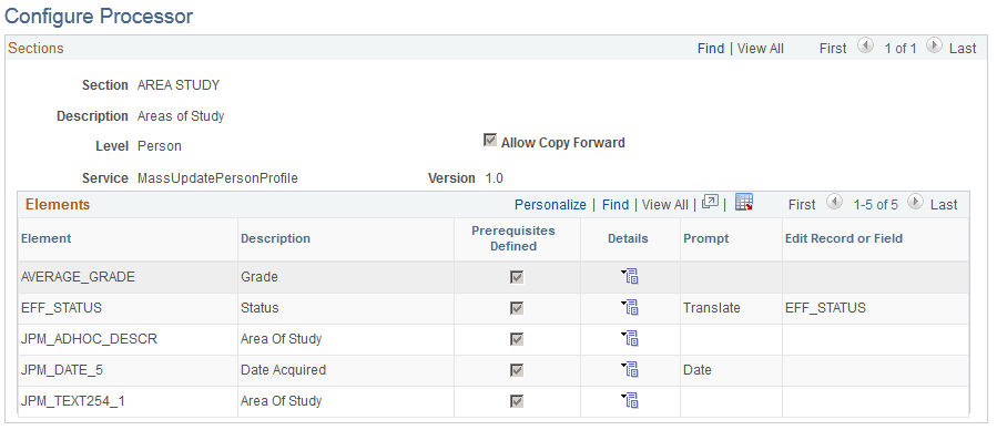

This example illustrates the fields and controls on the Configure Processor page. You can find definitions for the fields and controls later on this page.
Sections
Field or Control Description
Section
Enter the name of the section. A section is a functional group of elements and is defined within a service.
Description
Enter the description of the section. When you are defining a mass update on the define Mass Update component, the system uses the description as a prompt value for the Section field.
Level
Select whether the Component Interface is based on an Employee Record number or a Person. By default, the system selects the Person value.
When the Mass Update Manager module generates mass updates for a person, it uses the selected level to ensure that it generates these update transactions for the same person once only.
The Transaction Processor module uses the selected level to provide access to the service that contains the correct key values.
Allow Copy Forward
Select to make the Copy Forward option available for the section or service in the Define Mass Update component.
Service
Enter the service that the system uses to manage the update for the corresponding section. The service that you specify provides all the controls and defaults for mass updates that involve the section; no processing logic is within the setup itself.
PeopleSoft Human Resources delivers the following services for use with mass update processing: Job Data (which includes specifics for compensations and labor agreements), Person Data, Job Profile Manager, and Military Approval Tracking. Each service is defined using data types and uses the same base class. Each data type defines the elements that are available for the service. To manage services, use the Service Registry component.
Note: You can also build your own services and incorporate them into the Mass Update feature. To have the mass update process access data beyond the delivered services, you must define a service to manage the specific requirements, register the service, and then update the Transaction Processor setup.
Version
Enter the version of the specified service.
Elements
Element
Enter the object name of the element or data type that you want to make available for a mass update that uses this section. You can enter as a value any simple data type that is defined in the service. The elements that you list provide the information that is available for a mass update.
Description
Enter the description of the element. When you are defining a mass update on the define Mass Update component, the system uses the description as a prompt value for the Element field.
Prerequisites Defined
The system automatically selects this check box whenever you have defined prerequisites for the element.
Details
Click this button to access the Prerequisites page, where you can define prerequisites for the corresponding element.
Prompt
Select how you want to define the prompt for the element. The prompt that you select determines how you can define the value of the section and element combination on the Define Mass Updates page. Possible values are:
  • Action: When processing a mass update for this section and element combination, the system performs the specific action within the application that the element defines. For example, an element might perform the action of pressing a button or setting a default value (in that case, there is no prompt).
  • Checkbox: When you are defining a mass update for this section / element combination, the system displays a Boolean Value check box.
  • Date: When you are defining a mass update for this section / element combination, the system displays a date field.
  • Numeric: When defining a mass update for this section / element combination, the system displays a Numeric Value field.
  • Record: When defining a mass update for this section / element combination, the system displays a Character Value field that prompts against the record that you specify in the Edit Record or Field field.
  • Translate: When defining a mass update for this section / element combination, the system displays a Character Value field that prompts against the field that you specify in the Edit Record or Field field.
If you select to prompt for the element with a record, select the record. If you select to prompt for the element with a translate value, select the field name.
