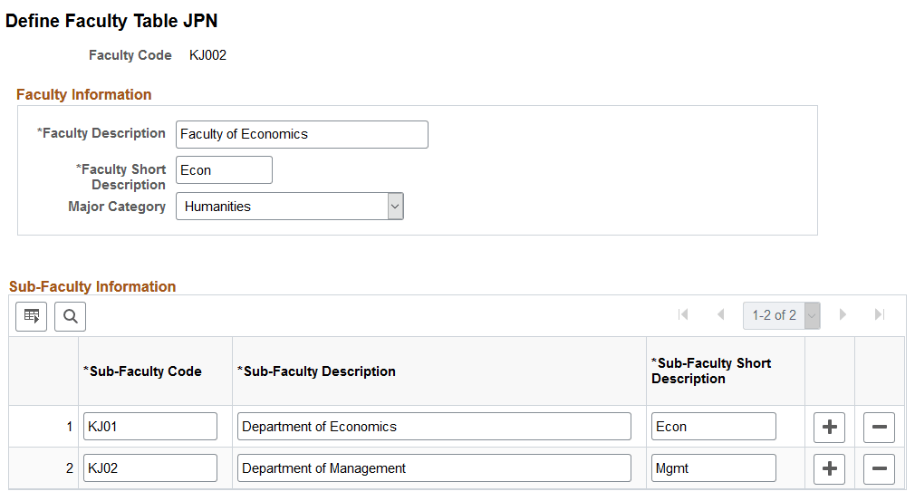

(JPN) Define Faculty Table JPN Page
Use the Define Faculty Table JPN page (FACULTY_TABLE_JPN) to define faculties and associate sub-faculties and a major category with them.
Navigation:
Set Up HCM, and then Common Definitions, and then School Information, and then Define Faculty Table JPN, and then Define Faculty Table JPN
This example illustrates the fields and controls on the Define Faculty Table JPN page. You can find definitions for the fields and controls later on this page.
Field or Control Description
Faculty Description
Enter a description of the faculty. When you enter a faculty or sub-faculty code in the profile pages, the system enters this text in the Description field as display only.
Major Category
Select a major category value.
The value that you select here is the default major category wherever you select this faculty on a profile. You can also override the default.
Sub-Faculty Code
Enter a code for the sub-faculty. You can enter multiple sub-faculties. Only sub-faculties that you enter for this faculty can be selected wherever you select the faculty on a profile.
