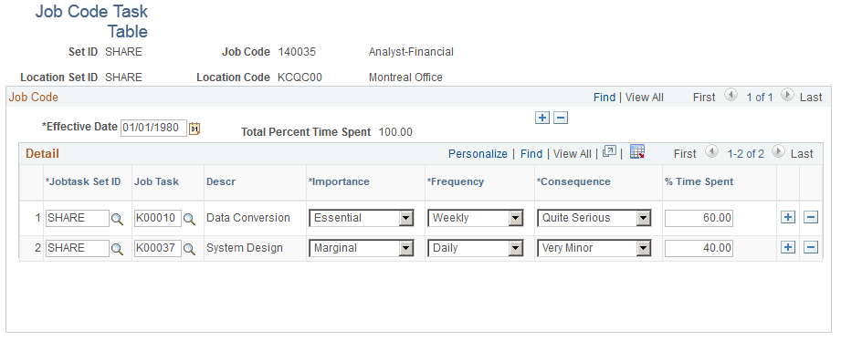

Job Code Task Table Page
Use the Job Code Task Table page (JOBCODE_TASK_TABLE) to associated job tasks with each job code.
Navigation:
Set Up HCM, and then Foundation Tables, and then Job Attributes, and then Job Code Task Table, and then Job Code Task Table
This example illustrates the fields and controls on the Job Code Task Table page. You can find definitions for the fields and controls later on this page.
Field or Control Description
Total Percent Time Spent
The system calculates and displays this when you move out of the % Time Spent field. The total cannot exceed 100%.

Jobtask Set ID
Select a job task set ID from the available options. Valid values are stored on the TableSet ID page.
Job Task
Select a job task from the available options. Valid values are stored on the Job Tasks page.
Imprtce (importance)
Select the importance of the job task to the particular job code. Valid values are in the Translate Table.
Freq (frequency)
Enter how often the job task occurs for each job code. Valid values are in the Frequency Table.
Cons (consequence)
Select the result that occurs if the job task isn't performed. Valid values are in the Translate Table.
% Time Spnt (percentage time spent)
Enter the percentage of time that is spent on the job task.
