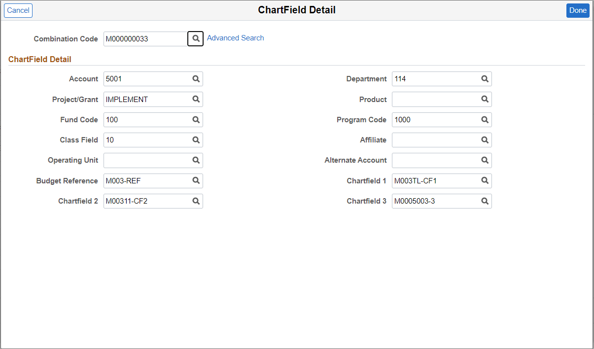

This example illustrates the fields and controls on the left side of the ChartField Details page (1 of 2). You can find definitions for the fields and controls later on this page.
Fluid ChartField Details (1_2) Page
The Advanced Search link allows you to search for more options.

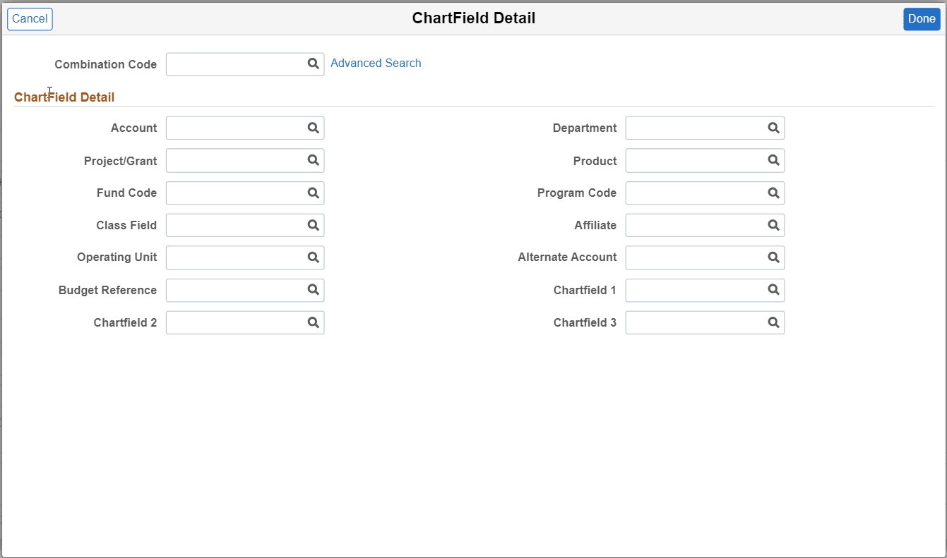

This example illustrates the fields and controls on the ChartField Detail with combination code.
ChartField Detail (2_2) Page
This page might have a more specific name, depending upon the transaction page from which you access it.
If the combination code is already entered on the transaction page, this detail page displays the associated ChartField values. If you are in correction mode or in a new effective dated row on the transaction page, then you can make changes to individual ChartField values and let the system determine if the new combination is valid. Otherwise the page is display only and you can only review the ChartField values.
If there is no combination code entered on the transaction page, all ChartField values are blank on the detail page and you can enter the specific ChartFields required.

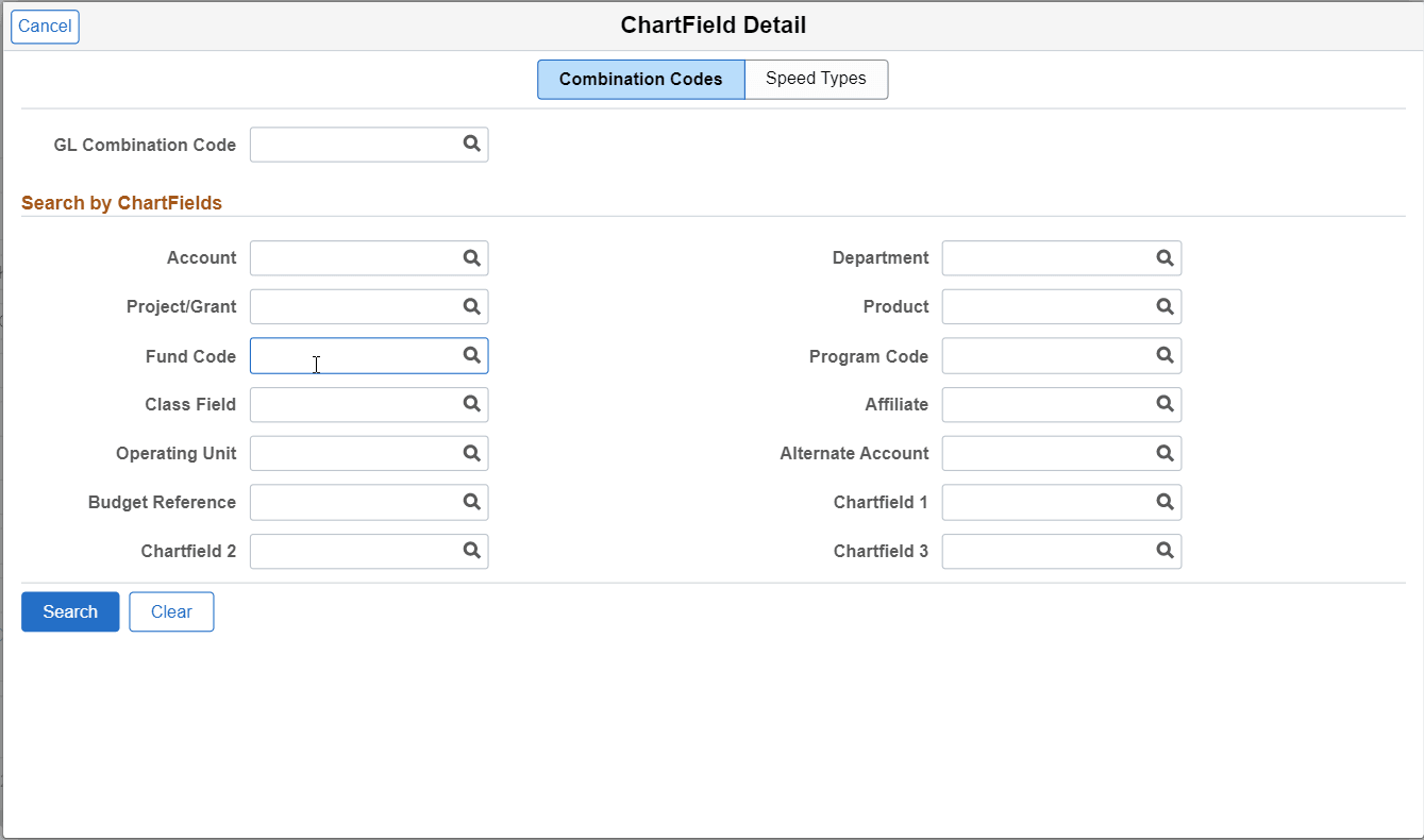

This example illustrates the fields and controls on the Search Combination Codes page. You can find definitions for the fields and controls later on this page.
Fluid Search Combination Codes Page

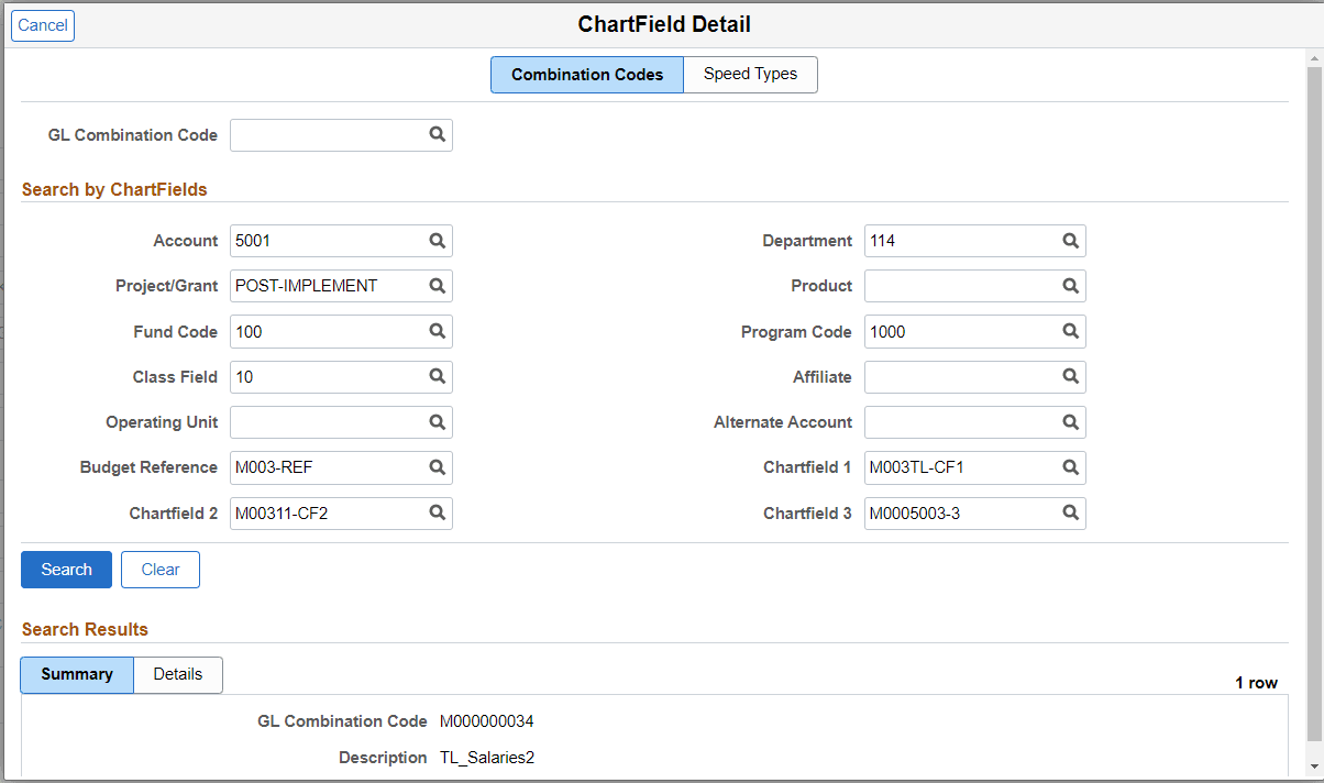

This example illustrates the fields and controls on the Combination Code Details_Summary tab.
ChartField Details_Summary tab

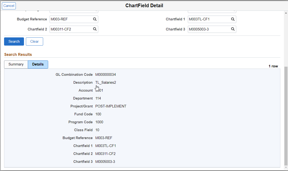

This example illustrates the fields and controls on the Combination Code_Details tab.
ChartField Details_Details tab
Only the ChartFields that are active on the Standard ChartField Configuration page are visible as fields on this page.
To search for a combination code:
  1. Enter individual ChartField values.
    The system finds all ChartField combination codes that match those ChartField values.
  2. Select the combination code that you want.
    The system returns you to the ChartField Details page with all individual ChartField values populated.

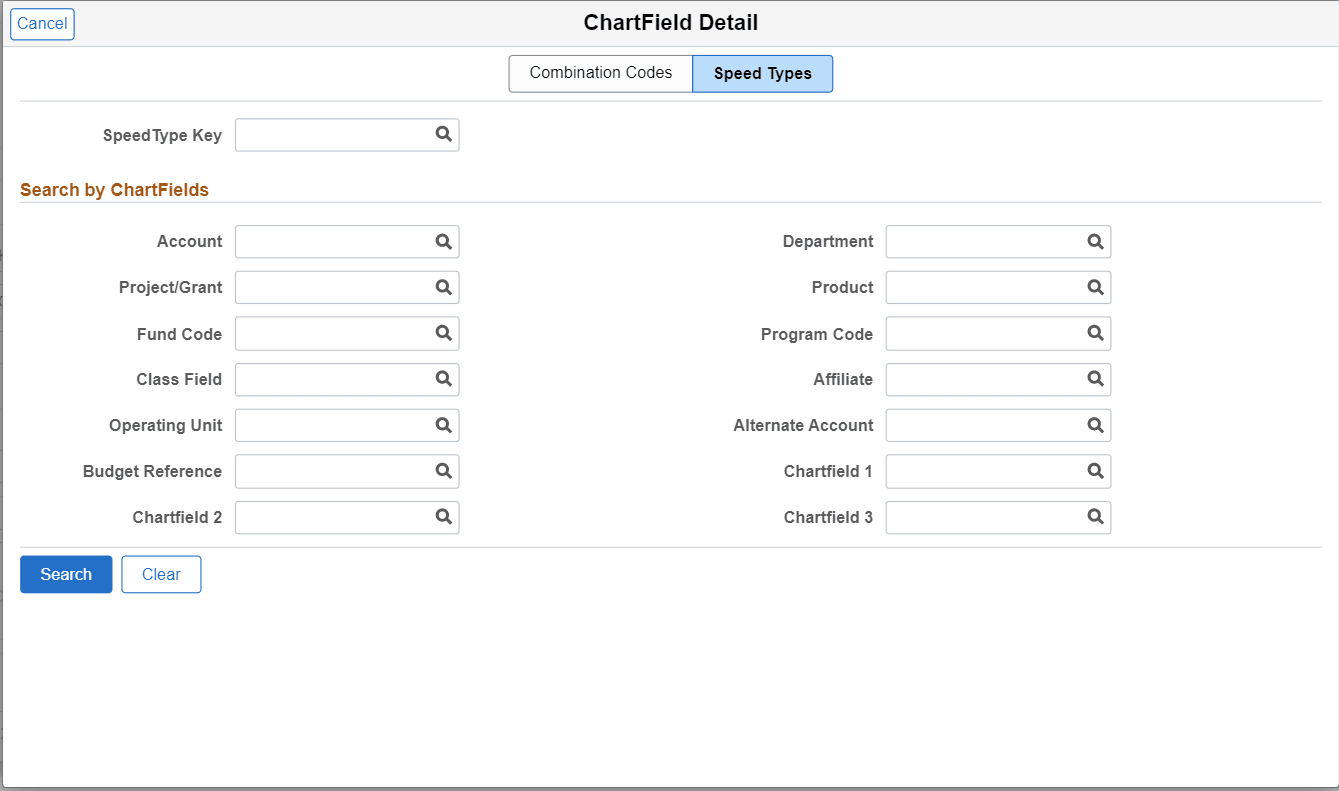

This example illustrates the fields and controls on the Search Speed Types page. You can find definitions for the fields and controls later on this page.
Fluid Search Speed Types Page
To search for a combination code using Speed Type:
    The system finds all speed types that match those ChartField values.
  2. Select the speed type that you want.
  3. Since this is selected from speed types, you might have to enter additional ChartField values to form a valid ChartField combination.
