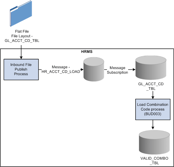

Flat File Loading
If you integrate with a financials system that does not have Integration Broker capability, you can use the Inbound Flat File process to load and maintain the Valid Combination table (VALID_COMBO_TBL).
To populate valid combination codes using the Inbound Flat File process:
  1. Create a flat file that contains valid combination data in the layout format specified by GL_ACCT_CD_TBL.
  2. Initiate the Inbound Flat File process to publish this combination data using the HR_ACCT_CD_LOAD service operation.
    When the service operation is received, the handler arranges the data in the correct layout and populates the GL_ACCT_CD_TBL
  3. Run the Load Combination Code SQR process (BUD003) to populate the Valid Combination table.
This diagram illustrates importing valid combination codes using a flat file as discussed above:
Importing valid combination codes using a flat file

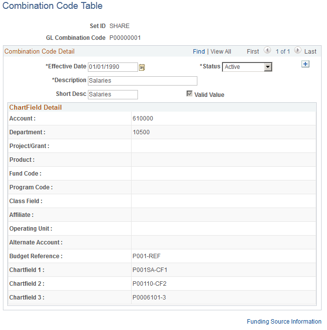

Combination Code Table Page
Use the Combination Code Table page (VALID_COMBO_TBL) to review all combination codes imported into HCM and loaded by the Load Combination Code process (BUD003) Manually define and review valid combinations of ChartField values if not importing them.
Navigation:
Set Up HCM, and then Common Definitions, and then ChartField Configurations, and then Combination Code Table, and then Combination Code Table
This example illustrates the fields and controls on the Combination Code Table page. You can find definitions for the fields and controls later on this page.
You cannot change the ChartField values for combination codes imported from Financials, but you can change the description and make it active or inactive.
Field or Control Description
GL Combination Code (general ledger combination code)
Enter this code on the HCM pages to use this combination of ChartFields in a transaction.
The system generates the combination code sequentially based on the Installation table's Last Combination Code Assigned field under these conditions:
  • The ChartField combination is received from Financials by Integration Broker.
  • The GL Combination Code value is not supplied on the inbound flat file.
  • You manually add the ChartField combination and do not pre-assign the GL Combination Code value.
Valid Value
This field is available for entry when entering the ChartField combination for the first time for the setID. Select it if the ChartField combination is valid. If the combination already exists with the same setID, this field is populated based on the value of the preexisting combination and is unavailable for change.
Funding Source Information
Click this link to view the Funding Source Information page, which displays the default funding end date. The Manage Commitment Accounting business process uses the default funding end date in department budgets and in encumbrance definitions.
See PeopleSoft Human Resources Manage Commitment Accounting: Funding End Dates and Multiyear Encumbrances.
ChartField Detail
If you're setting up combination codes manually, enter the ChartField value for each ChartField that applies to this ChartField combination.
Only the ChartFields that are active on the Standard ChartField Configuration page are visible on this page.
