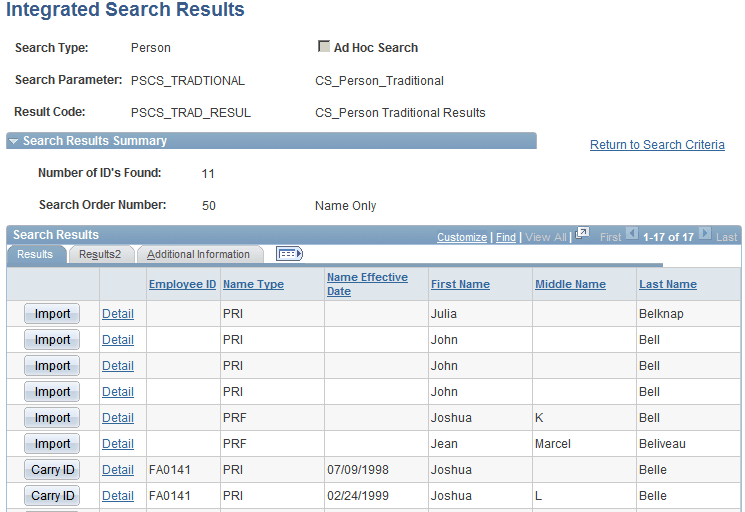

This example illustrates the fields and controls on the Integrated Search Results page: Results tab. You can find definitions for the fields and controls later on this page.

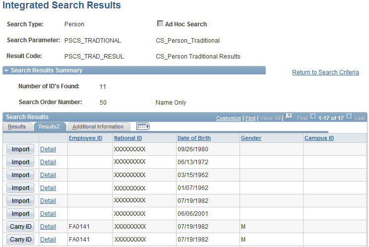

This example illustrates the fields and controls on the Integrated Search Results: Results2 tab. You can find definitions for the fields and controls later on this page.
Integrated Search Results page: Results2 tab

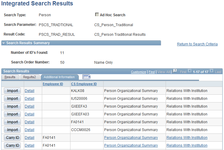

This example illustrates the fields and controls on the Integrated Search Results page: Additional Information tab. You can find definitions for the fields and controls later on this page.
Many fields on this page are the same as those on the Search Results page. However, there are some important distinctions:
  • Records with no HCM employee IDs appear first in the Search Results group box.
  • Records with no HCM employee IDs are assigned an External Sys ID..
  • Where an HCM employee ID exists, the Detail link accesses a page where you can view details of the ID record from the HCM system.
  • Where no HCM employee ID exists, the Detail link accesses a page where you can view details of the data from the external system.
  • The Import button appears when a person meets the criteria in the external system.
  • The external system ID column appears based on the settings defined on the Search Match Options for External Systems page. The column heading depends on the Display Name that is defined for the Universal ID column, in this case CS Employee ID.
  • Masking configuration is in effect for all matching individuals, even those with no employee ID.
  • For matching person records found by External Search/Match, this page displays information that is not necessarily stored inside the external system (for example, Campus SolutionsAid Year).
A column with the external system IDs appears on the Additional Information tab when a Universal ID static column to display is selected on the Search Match Options for External Systems page. The column heading depends on the Display Name defined, in this case CS Employee ID.
