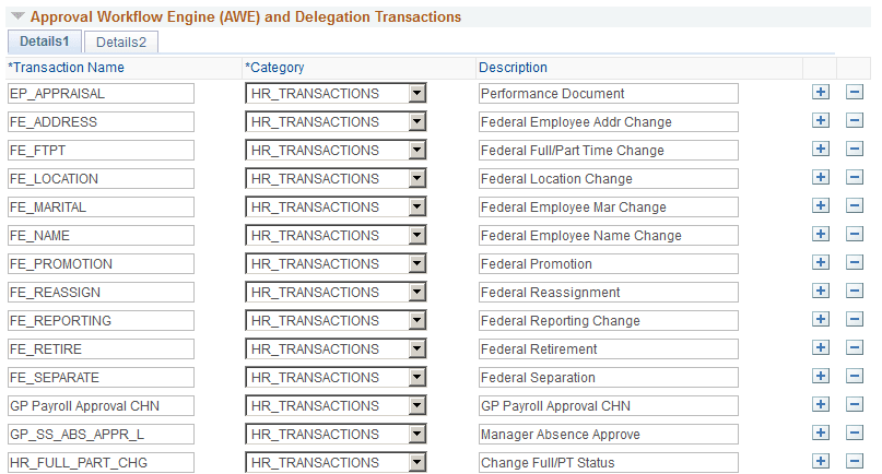

This example illustrates the fields and controls on the Workflow Transactions page (Approval Workflow Engine (AWE) and Delegation Transactions grid: Details1 tab). You can find definitions for the fields and controls later on this page.

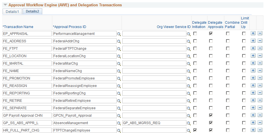

This example illustrates the fields and controls on the Workflow Transactions page (Approval Workflow Engine (AWE) and Delegation Transactions grid: Details2 tab). You can find definitions for the fields and controls later on this page.

Approval Process ID
When implementing the Approval Framework, you define a unique transaction registry ID, called a process ID, for each of your HCM self-service transactions on the Register Transactions page. Select the approval process ID that you have defined for this self-service transaction. By creating this link between the self-service transactions and the Approval Framework, the self-service transactions can dynamically retrieve this approval process ID by transaction name and thus invoke the Approval Framework. The Approval Framework requires this parameter during processing.
Delegation Initiation
Select to enable delegation of transaction initiation for the corresponding self-service transaction that uses the Approval Framework. The transaction then becomes available for configuration as an initiate-type delegation transaction. Configure delegation transactions on the Configure Delegation Transaction page.
Delegate Approvals
Select to enable delegation of transaction approval for the corresponding self-service transaction. The transaction then becomes available for configuration as an approval-type delegation transaction. This functionality is available only for transactions that you register with the Approval Framework in the lower grid.
If you select both the Delegation Initiation and the Delegate Approvals check boxes, you can configure the transaction for delegation of initiations and approvals. Configure delegation transactions on the Configure Delegation Transaction page.
Combine Partial
Select to have the system continue searching for a department manager even after it has found a partial position reports to manager. Deselect to have the system stop searching for the manager ID once it is found by one of the access types.
Limit Drill Up
Select to enable the system to continue to drill up an access type until a manager is found. Deselect this check box to allow the system to go up to the next level only.
