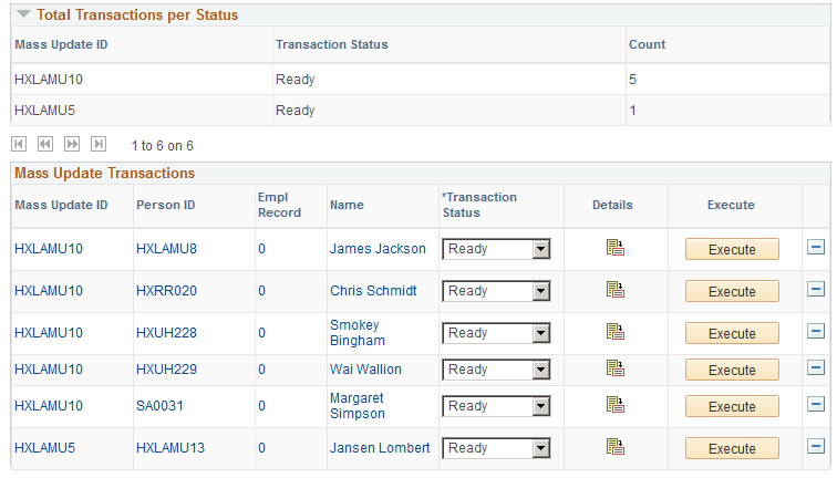

Total Transactions Per Status
Use this group box to view statistics that are related to the mass update transactions in your search results. The system displays a list of the mass update definitions in your search results, the status of each definition, and the transaction count for each definition.
Mass Update Transactions
Field or Control Description
Mass Update
The system displays the ID for each of the mass update definitions that meet your search criteria with a separate row for each employee who has a transaction based on the definition. Click the ID to access the Define Mass Update component, where you can review the details of the mass update definition.
Person ID
The system displays the ID of the person that is involved in each of the mass update transactions that meet your search criteria. Click the Person ID link on a row to access the Personal Data component, where you can review the personal data record for the individual.
Note: This link provides access to personal information, but the mass update transaction itself might not relate to personal data.
Empl Record (employee record number)
The system displays the employee record number of the person that is involved in each of the mass update transactions that meet your search criteria. Click the employee record number link on a row to access the Job Data component, where you can review the person's job data record.
Note: This link provides access to job data, but the mass update transaction itself might not relate to job data.
Name
The system displays the name of the person that is involved in each of the mass update transactions that meet your search criteria. Click the name link on a row to access the personal data for the individual.
Transaction Status
The system displays the status of each mass update transaction. Possible values are:
  • Cancel: A user has canceled the mass update transaction.
  • Failure: The Mass Update process cannot successfully process the transaction. View messages and exceptions to details about the failure.
    You can change this status to Cancel to cancel the transaction. Note however that this action is irreversible after it has been processed.
  • Ready: The transaction has been created during the selection phase and is ready to be processed.
  • Success: The Mass Update process has successfully processed the transaction and performed the update.
  • Warning: The transaction has been created during the selection phase and is ready to be processed. However, a conflict occurred during transaction creation. For the shown employee record number, the employee is eligible for more than one additional population. The system has assigned the employee to the latest population.
    You can change this status to Cancel to cancel the transaction. Note, however, that this action is irreversible after it has been processed.
When you change transaction statuses and save the page, the system updates the status of the mass update definition accordingly. If all transactions for a mass update definition have a status of Cancel or Success and no transactions have a status of Ready, Warning or Failure, then the system changes the status of the mass update definition to Closed. The Mass Update process processes only transactions with a status of Ready or Failure. It does not process transactions with any other status.
Details
Click to access the Transaction Details page, where you can view details of the mass update transaction and its execution log.
Execute
Click this button for a row to process the corresponding mass update transaction online individually. You can process only transactions with a status of Ready or Failure. The system triggers the Transaction Processor to process the transaction. The Transaction Processor then updates the statuses of the transaction and the mass update definition. Note that processing individual transactions online is especially useful for troubleshooting.

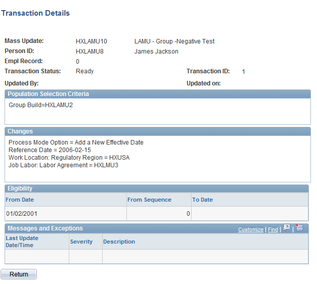

Manage Mass Updates - Transaction Details Page
Use the Manage Mass Updates - Transaction Details page (MU_MANAGE_DETAIL_S) to review details of the mass update transactions.
This page includes high-level details of the transaction as well as information about population selection criteria, changes, eligibility, messages, and exceptions.
Navigation:
Click the Details button for a row on the Manage Mass Updates page.
This example illustrates the fields and controls on the Manage Mass Updates - Transaction Details page. You can find definitions for the fields and controls later on this page.
Population Selection Criteria
Review the population selection criteria that the system used when generating the mass update transaction. This includes criteria for common changes and additional changes.
Eligibility
Review the date range for which the transaction is eligible for the mass update.
Messages and Exceptions
Review the messages and exceptions that the Transaction Processor generated for the mass update transaction during processing. The system displays in sequence the date and time of the last update in which the Transaction Processor generated the message or exception, the severity, and the description.
