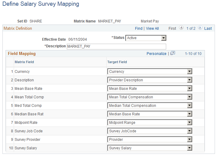

Define Salary Survey Mapping Page
Use the Define Salary Survey Mapping page (SP_SURV_MAP_TBL) to map market pay matrix fields to existing salary survey fields.
Navigation:
Set Up HCM, and then Product Related, and then Compensation, and then Market Pay, and then Define Salary Survey Mapping, and then Define Salary Survey Mapping
This example illustrates the fields and controls on the Define Salary Survey Mapping page. You can find definitions for the fields and controls later on this page.
The MARKET_PAY and WFR_SURVEY_DATA matrices are delivered with the system. You can also define configurable matrices to include market pay survey data.
See PeopleSoft Human Resources Manage Base Compensation and Budgeting: Defining and Maintaining Configurable Matrices.
Field or Control Description
Matrix Field
The system displays the values from the Matrix Definition page.
Target Field
Select a value. These values come from the Job Code table.

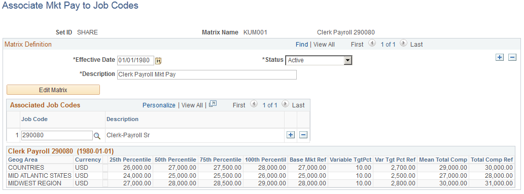

Associate Mkt Pay to Job Codes Page
Use the Associate Mkt Pay to Job Codes page (SP_SAL_SURV_TBL) to associate market pay matrices to specific job codes.
Navigation:
Set Up HCM, and then Product Related, and then Compensation, and then Market Pay, and then Associate Mkt Pay to Job Codes, and then Associate Mkt Pay to Job Codes
This example illustrates the fields and controls on the Associate Mkt Pay to Job Codes page. You can find definitions for the fields and controls later on this page.
Click the Add button to create a new association between market pay data and job codes. Click Search to find existing values.
Edit Matrix
Click this button to access the Data Content page in the Matrix Definition component, where you can add, modify, or delete the Matrix Data field information.
Job Code
Select the job codes to which you want to associate the market pay matrix. You may link multiple job codes to one market pay matrix. However, a single job code can only be associated to one market pay matrix at a given time.

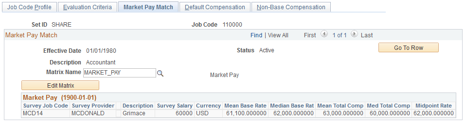

Market Pay Match Page
Use the Market Pay Match page (JOBCD_MP_SAL_SURV) to associate a market pay matrix to a specific job code using the Job Code table.
Navigation:
Set Up HCM, and then Foundation Tables, and then Job Attributes, and then Job Code Table, and then Market Pay Match
This example illustrates the fields and controls on the Market Pay Match page. You can find definitions for the fields and controls later on this page.
Job Code Table - Market Pay Match page
You must be in Correct History mode to see new effective-dated matrix data for a job code. You can have only one market pay matrix associated with a single job code at a given time.
Matrix Name
Select the market pay matrix that you want to associate with this job code.
Edit Matrix
Click this button to access the Data Content page on the linked matrix, where you can view and edit values associated with this matrix.
See PeopleSoft Human Resources Manage Base Compensation and Budgeting: Data Content Page.

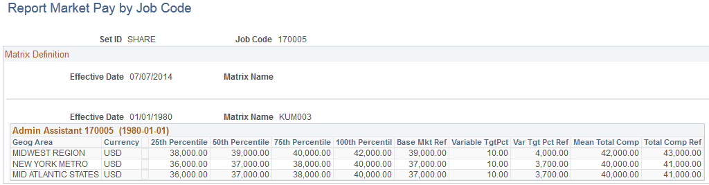

Report Market Pay Data by Job Code Page
Use the Report Market Pay by Job Code page (SP_MPAY_RPT_TBL) to run this effective-dated report that displays all the market pay definitions ever associated with a particular job code.
Navigation:
Set Up HCM, and then Product Related, and then Compensation, and then Market Pay, and then Report Market Pay Data by Job Code, and then Report Market Pay Data by Job Code
This example illustrates the fields and controls on the Report Market Pay by Job Code page. You can find definitions for the fields and controls later on this page.
This page displays the current market pay data as well as previous and future market pay data when available.
