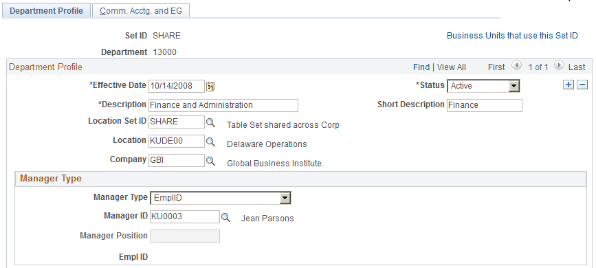

An example of a control table that is associated with multiple set IDs is the Departments component (DEPARTMENT_TBL). The record for the component, DEPT_TBL, has two set IDs: the set ID for the department and the set ID for the department's location. The set ID for the location prompt comes from the LOCATION_TBL record.
This example illustrates the Department Profile page.
In this situation where this is a department set ID and a location set ID, you can set up the component so that the system makes available in the Location field:
  • All locations from all set IDs.
  • Locations that share the same set ID and the department's set ID.
Making all locations available may cause problems if a user creates a department with a location in a set ID that is not used by any business unit with access to the department's set ID. Making only one location set ID available could cause problems if business units with access to the department's set ID use different location set IDs.
