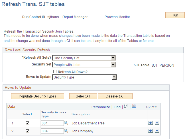

Refresh Trans. SJT tables Page
Use the Refresh Trans. SJT tables page (SCRTY_SJT_RC) to refresh some or all of the data in the transaction-based security join tables to capture data changes that were not automatically loaded into the table.
Navigation:
Set Up HCM, and then Security, and then Core Row Level Security, and then Refresh Trans. SJT tables, and then Refresh Trans. SJT tables
This example illustrates the fields and controls on the Refresh Trans. SJT tables page. You can find definitions for the fields and controls later on this page.
Field or Control Description
Refresh All Sets?
Select All Security Sets to refresh all security sets.
Select One Security Set to refresh one security set.
Security Set and SJT Table
If you are refreshing one security set, select the set. The system displays the transaction security join table associated with the security set.
Refresh All Rows?
Select to refresh every row in the security join table.
Deselect to refresh select rows in the security join table. The system displays the Rows to Update grid.
Rows to Update
Select the rows to update. The options available are the ones you selected for the security set on the Security Sets component.
Rows to Update
The fields and buttons in the Rows to Update grid will vary depending on the rows you select to update in the Rows to Update field. Enter the rows of data you want to update.
For example, if you select Security Type in the Rows to Update field, select the security types whose transaction data you want to refresh.

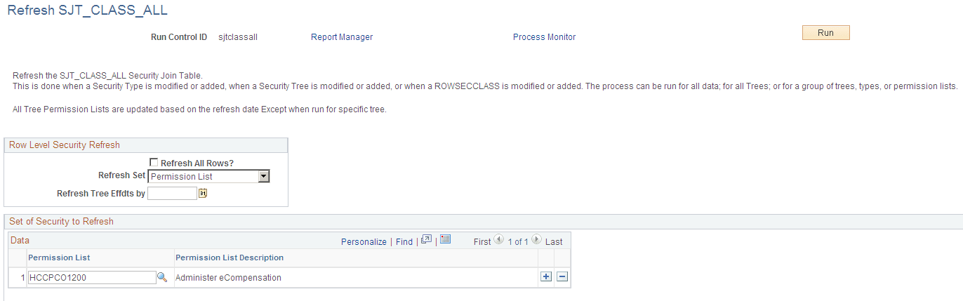

Refresh SJT_CLASS_ALL Page
Use the Refresh SJT_CLASS_ALL page (SCRTY_OPR_RC) to refresh some or all of the data in the SJT_CLASS_ALL table to capture changes to permission lists that were not automatically loaded into the table.
Navigation:
Set Up HCM, and then Security, and then Core Row Level Security, and then Refresh SJT_CLASS_ALL, and then Refresh SJT_CLASS_ALL
This example illustrates the fields and controls on the Refresh SJT_CLASS_ALL page. You can find definitions for the fields and controls later on this page.
Row Level Security Refresh
Refresh All Rows?
Select to refresh every row in SJT_CLASS_ALL.
Deselect to refresh selected rows. The system displays the Refresh Set field.
Refresh Set
Select the set of rows to refresh. The system displays the Set of Security to Refresh grid.
You can select to refresh:
  • All Trees.
  • Permission List
  • Security Type
  • Specific Tree
Refresh Tree Effdts by (refresh tree effective dates by)
Select the date as of which you are refreshing the table. The process will refresh the table with the security data that is effective as of this date.
Select the values to refresh.
For example, if you've modified a row security permission list, rather than refreshing the entire table, select Permission List in the Refresh Set field and select the permission list you modified here.
If you've modified a specific tree, select Specific Tree in the Refresh Set field and select the setID's to refresh for that tree.
