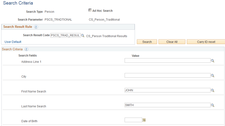

This example illustrates the fields and controls on the Search Criteria page (1 of 2). You can find definitions for the fields and controls later on this page.

Field or Control Description
Search Type
The system displays the search type (Person) selected to access the page. If you have licensed PeopleSoft Talent Acquisition Management, you could have selected Applicant, and if you have licensed PeopleSoft Campus Solutions, you could have selected Organization.
Search Parameter
Displays the parameter code selected to access the page. The search parameter prompt on the search dialog page enables you to select only the search parameters to which your security roles permit you access.

Search
Click this button to launch a search on all of the values that you entered and to retrieve results for the most restrictive search order number defined in the Search Parameter that you selected. When the search is complete, the system transfers you to the Search/Match Results page.
Note: When you click Search, the system searches only for the data specified. It filters the search orders that are defined for the Search Parameter that you selected. For example, if Search/Match finds at least one potential matching ID at search order number 10, it will stop the search and display the results obtained at search order number 10. If no potential matching IDs are found, the search continues to the next search order number, and so on. If you want to search using a specific Search Order number, use the Selective Search button for that order number.

Search Criteria
Search Fields
The system displays each of the search fields associated with the search parameter that you selected.
Operand
These fields appear only when the search parameter permits ad hoc searches. When the parameter permits ad hoc searches, the system selects the Ad Hoc Search check box and hides the Search by Order Number area of the page.
Select the operand to perform the search. The valid values are Begins With, Contains, and Equals. These values are delivered as translate values and should not be changed.
Value
For each search field that you specify, enter the value to search for. If predefined values are available (such as for gender), you can select from them from the prompt. If no predefined values exist, you can type the data directly into the value field.
