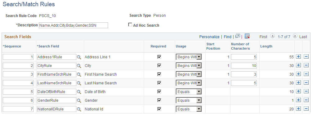

Search/Match Rules Page
Use the Search/Match Rules page (HCR_SM_RULE) to define sets of fields to search for and identify how to search for them.
Navigation:
Set Up HCM, and then System Administration, and then Utilities, and then Search/Match, and then Search/Match Rules, and then Search/Match Rules
This example illustrates the fields and controls on the Search/Match Rules page. You can find definitions for the fields and controls later on this page.
Field or Control Description
Ad Hoc Search
Select to permit ad hoc searches from this search rule.
An ad hoc search enables users to bypass the institution's predefined search standards to perform a configured search without predefined operands and without limiting the characters to evaluate. For example, an ad hoc search might be first name equals John; whereas, a non-ad hoc search might be set to search only on the first three characters of the first name (in this case, Joh).
Search Fields
Search fields are delivered with your system.
WARNING:
Adding new search fields require significant programming effort and is not recommended.
Sequence
Enter the order in which you want the search fields to appear when used inside a search parameter.
Search Field and Field Description
Select each search field that you want to assign to this search rule code. When you exit the field, the system displays the associated description. Search fields are the fields on which users are permitted to search.
Search fields are delivered with your system. Adding or modifying a search field value requires a significant programming effort. Do not attempt to delete a search field.
Note: When you include name, national ID, phone, email, or address fields in the rule without the types (Name Type, National ID Type, phone type, email type or address type), the system searches on all national IDs, phones, emails or addresses in the system for that individual.
Required
Select this check box to require a value in the search field to find a potential match on this search rule. Selecting this check box is useful for making the rule more restrictive.
If the check box is not selected, the system accepts blank or nonexistent for this field inside this search rule. For example, if all the fields inside a search rule are marked as required, the user must provide data for each of those search fields to find a match on this rule. However, if the Required check box is not selected, for example, for Date of Birth, the user can still search on that search rule without specifying a date of birth.
Usage
Identify how you want the search to evaluate the field value:
Begins With: The value must begin with this data. When you select this value, the Start Position field appears with a default value of 1, and the Number of Characters fields are available for you to define. You cannot modify the start position default value.
Contains: The value must contain this data but can be preceded or followed by other data. When you select this value, the Start Position field appears with a default value of 1, and the Number of Characters fields are available for to you define.
Equals: The value must be exactly equal to this data.
Not Used: Do not use this field value in this search.
Start Position and Number of Characters
Enter the character position where you want the compare to start, and enter the number of characters from that start position to include in the compare.
For example, if the usage selected for National ID is Contains, and you enter a start position of 3 and the number or characters of 5, the system compares against the 3rd, 4th, 5th, 6th, and 7th characters in the field value. It will return matching IDs for which the National ID contains these 5 characters.
If the usage selected was Begins With, the start position is has a default value of 1 and you need to specify how many characters from the first character that Search/Match should use to perform the search.
Length
Indicates the number of characters in the search field. When you exit a particular field in the Search Field column, the system displays the total number of characters in the associated field.
See Understanding Search/Match.

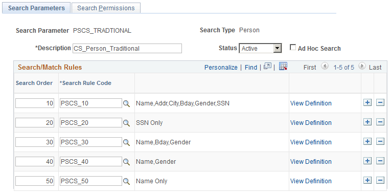

Search Parameters Page
Use the Search Parameters page (HCR_SM_PARM) to combine and order search rules.
The combination (called the search parameter) is what the users select prior to performing a search to determine the search fields that they are permitted to search on.
Navigation:
Set Up HCM, and then System Administration, and then Utilities, and then Search/Match, and then Search/Match Parameters, and then Search Parameters
This example illustrates the fields and controls on the Search Parameters page. You can find definitions for the fields and controls later on this page.
Ad Hoc Search
Select to permit only ad hoc searches from this search parameter.
An ad hoc search enables users to bypass the institution's predefined search standards to perform a configured search without predefined operands and without limiting the characters to evaluate. For example, an ad hoc search might be first name equals John; whereas, a non-ad hoc search might be set to search only on the first three characters of the first name (in this case, John).
Note: Automatic search cannot be performed from a search parameter set to permit ad hoc searches.
Search/Match Rules
Search Order
Enter the order in which to apply the search rule codes of this search parameter. Enter the most restrictive search rule in the lowest order number and the least restrictive search rule in the highest order number.
You can reorder the search rules at any time. When you reorder the rules and save the page, the system displays the rules in the most recent numerical order that you entered.
Search/Match processes the lowest order search rule first; if it finds one or more possible matches, it stops the search and returns the results. If it finds no results, it continues to the next search rule, and so on.
In the search results, the system displays the search order number that corresponds to the search rule where potential matching IDs are found.
You can use only one search rule for an ad hoc search; therefore Search Order fields do not appear when theAd Hoc Search check box is selected.
Search Rule Code and Rule Code Description
Enter the search rule code to use. When you exit the field, the system displays the search rule description. You must enter at least one search rule to create a valid search parameter.
View Definition
Click this link to access the Search/Match Rules page on which you can view or edit the rule definition.

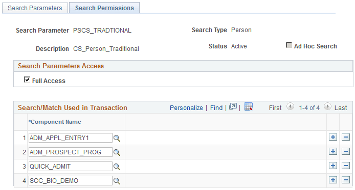

Search Permissions Page
Use the Search Permissions page (HCR_SM_PERM) to identify who can use the search parameter to perform the search.
Also identify which component names, if any, should use the search parameter as part of saving a new ID in the database.
Navigation:
Set Up HCM, and then System Administration, and then Utilities, and then Search/Match, and then Search/Match Parameters, and then Search Permissions
This example illustrates the fields and controls on the Search Permissions page. You can find definitions for the fields and controls later on this page.
Search Parameters Access
Full Access
Select to enable all users to use the search parameter code.
Restricted Security Access
This area appears only when the Full Access check box is not selected.
Role Name and Role Description
Restrict the use of this search parameter code to users that have specific roles inside their security profile.
Search/Match Used in Transaction
Component Name and Component Description
If you want to enforce the use of Search/Match when adding a new ID, select the component name where adding a new ID occurs. The system will then initiate Search/Match when a user enters the data to create a new ID and saves the transaction. You can restrict the search to specific components whether you give permissions to all roles or only to specific roles.
Note: A component name can be associated with only one search parameter. However, the same search parameter can be used inside several component names. Select all components where the search parameter should be used.
Note: This field is available only when the Search Type is Person or Organization.

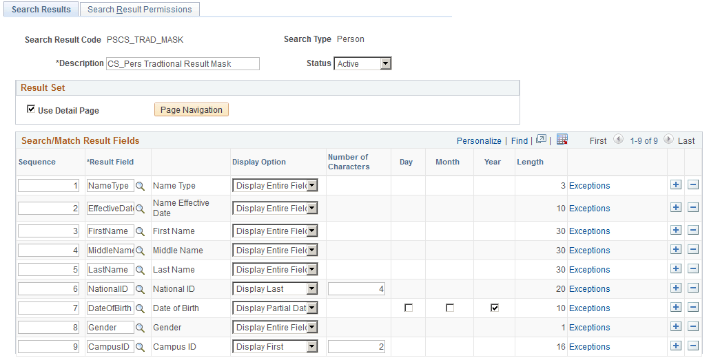

Search/Match Results - Search Results Page
Use the Search Results page (HCR_SM_RESULT) to specify which result fields to include in the search results and control how to display their values.
Be careful not to confuse this page with the page also called Search Results with a similar object name (HCR_SM_RESULTS), which is the page on which Search/Match displays returns from a search.
Navigation:
Set Up HCM, and then System Administration, and then Utilities, and then Search/Match, and then Search/Match Results, and then Search Results
This example illustrates the fields and controls on the Search/Match Results - Search Results page. You can find definitions for the fields and controls later on this page.
Result Set
Use Detail Page
Select this check box to display a Detail link beside each ID returned from a search.
When you select Use Detail Page, the Page Navigation button appears.
Page Navigation
This button appears only when the Use Detail Page check box is selected.
Click to access the Search Results Detail page, on which you can define the page to which you want users to be directed to see more details about a specific ID.
Note: To be transferred to the page that you define here, the user must have security access to the page.
Search/Match Result Fields
Sequence
Enter the order by which the system displays results in the in the Search/Match results grid. You can reorder the result fields at any time. When you reorder the fields and save the page, the system displays the result fields in the most recent numerical sequence that you entered.
Result Field and Field Description
Select the data to return with the search results. Fields used to perform the search (search fields) can be different from the fields needed to review the results (result fields).
The result fields are defined in the Search/Match Result Fields page.
Display Option
Displays the default display control for that field. You can override this. Select Display Entire Field or Mask Entire Field to display or hide the entire field value respectively . The other options are:
Display First: Displays the first specified number of characters of the field value. When you select this, the Number of Characters field appears. You must enter the number of characters to display from the beginning of the field value.
Display Last: Displays the last specified number of characters of the field value. When you select this, the Number of Characters field appears. You must enter the number of characters to display from the end of the field value.
Display Partial Date: Displays the specified parts of a date field value. When you select this, the Day, Month, Year check boxes appear. You must select which parts of the date to display. For example if you select Year, only the year will appear.
Enter the number of first or last characters of a field value to display.
Day, Month, Year
Select the parts of the date to display for a date value.
Length
Displays the number of characters possible for the field value.
Exceptions
Click this link to access the Exceptions page, on which you can define field-level exceptions to these results.
Note: Search/Match returns all potential matching IDs regardless of data permission security. You must use field-level security to mask or partially mask sensitive data.
See Understanding PeopleSoft Security and Understanding Data Permission Security for HCM.

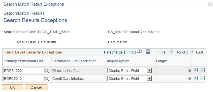

Search/Match Results - Search Results Exceptions Page
Use the Search/Match Results - Search Results Exceptions page (HCR_SM_RESULT_EXCP) to define field-level security exceptions to the data display control that is set on the Search Results Permissions page.
Navigation:
Click the Exceptions link on the Search Results page.
This example illustrates the fields and controls on the Search/Match Results - Search Results Exceptions page. You can find definitions for the fields and controls later on this page.
You can define exceptions to the search results that you set up on the Search Results page. For example, you might have partially masked the birth date field in your search results, but you want the entire field to appear for those who have a need to know. Using primary permission lists, you can set those exceptions here.
See PeopleTools: Security Administration
Field Level Security Exceptions
Primary Permission List and Permission List Description
Select the primary permission lists of the users who will be exceptions to the result field selected. When you exit the field, the system displays the permission list description.
Display Option
Select the display option to use as the exception to the display option selected on the Search Rules page.
