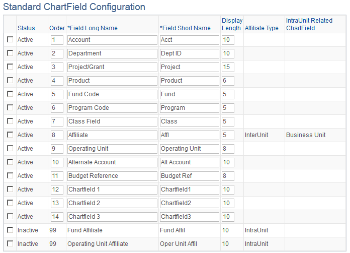

Standard ChartField Configuration Page
Use the Standard ChartField Configuration page (STANDARD_CF_TMPLT) to activate ChartFields to make them available on the ChartField Values page.
This page is not available for entry if you are integrating with PeopleSoft Financials.
Navigation:
Set Up HCM, and then Common Definitions, and then ChartField Configuration, and then Standard Configuration, and then Standard ChartField Configuration
This example illustrates the fields and controls on the Standard ChartField Configuration page. You can find definitions for the fields and controls later on this page.
The Standard ChartField Configuration page initially displays the ChartFields as delivered by PeopleSoft.
Field or Control Description
Status
An active ChartField displays on pages, reports and prompt lists. An inactive ChartField is not displayed on pages, reports and prompt lists, but it is not removed from records and pages.
Fund Affiliate, Operating Unit Affiliate, and the Project Costing ChartFields are delivered inactive but can be activated if the delivered active ChartFields are not sufficient for your requirements.
Note: Do not change the status of a ChartField after you have run the full configuration and are using the system in production. Status determines whether ChartFields are displayed on pages, reports and prompt lists throughout the system.
Order
Change the order of display by changing the sequence of order numbers in this field. Inactive ChartFields have the order value of 99. Active ChartFields require an order number. When you activate an inactive ChartField, the system assigns it the next available number, which you can change to place the newly activated ChartField in any desired sequence.
When you save the page, the system completes the final reordering to remove gaps or duplicates in the numbering sequence.
Note: Project costing ChartFields are always the same in relationship to the position of the Project/Grant ChartField. When changing the field display order, all project costing ChartFields move together in a block.
Field Long Name and Field Short Name
Enter a new long name and short name to relabel the description of a ChartField. These names are displayed on pages, reports and prompt lists rather than the database field name of the ChartField.
Display Length
Enter a new value to change display length on pages. The display length cannot be greater than the actual field length of the ChartField.
Affiliate Type
An Affiliate ChartField is either an InterUnit or IntraUnit affiliate. Standard ChartFields have no affiliate type.
IntraUnit Related ChartField
A unique intraunit related ChartField of the same or smaller ChartField length must be specified for each intraunit affiliate ChartField that is active. (Business Unit is required for the InterUnit Affiliate ChartField.)
Activate
To activate an inactive ChartField, click the check box next to the field you want to activate and then click the Activate button.
Inactivate
To inactivate an active ChartField, click the check box next to the field you want to inactivate and then click the Inactivate button.
Note: Do not inactivate a ChartField if you have transaction data posted to that ChartField. If you do, you will not be able to view that ChartField on pages and reports.
Impact
Click to run the ChartField Configuration PSJob process (PYCONFIG) in report mode to analyze the ChartFields changes and determine the impact of applying the new template.
Configuration Status
Click to access the Action Status page where you can view the standard ChartField activity log and pending changes, including changes that have been subscribed to from Financials but not yet applied.
Before applying the subscribed changes, view their impact by clicking the Impact button.
If you have saved changes but want to cancel them before applying them, use the Configuration Status - Action Status page to cancel the undesired configuration actions. This resets the ChartField to its previous configuration.
Apply
Click to run the ChartField Configuration PSJob process (PYCONFIG) in update mode to apply the ChartField configurations changes.
Note: If you make any changes to the Standard Configuration pages, you must run the ChartField Configuration process in update mode to apply those changes before they take effect.
After you apply your changes, the system displays only the active ChartFields. ChartFields display in the order and with the labels defined in this standard configuration.
