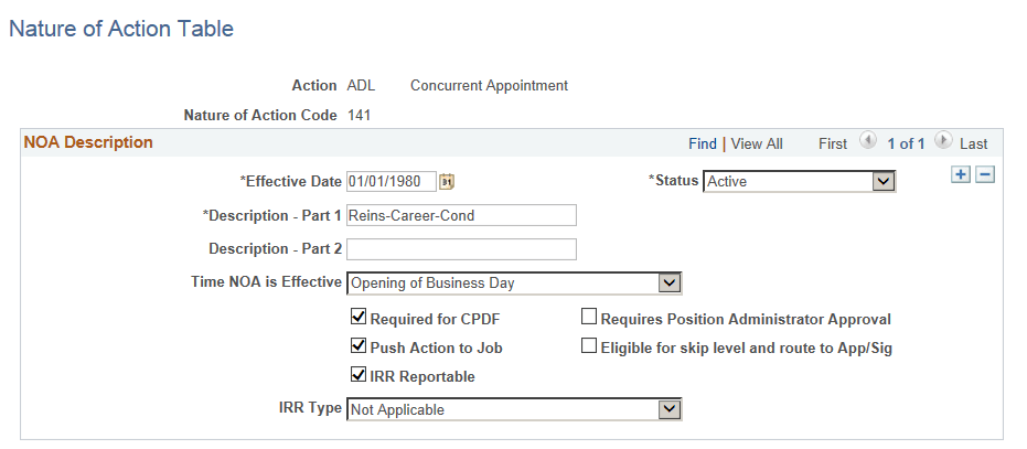

Nature of Actions USF Page
Use the Nature of Actions USF page (GVT_NOAC_TBL) to review, add, and update codes.
This table defines the Nature of Action codes that are used in PeopleSoft Human Resources.
Navigation:
Set Up HCM, and then Product Related, and then Workforce Administration, and then Workforce Data USF, and then Nature of Actions USF , and then Nature of Actions USF
This example illustrates the fields and controls on the Nature of Actions USF page. You can find definitions for the fields and controls later on this page.
Field or Control Description
Nature of Action Code
Every Personnel Action Request (PAR) requires a Nature of Action (NOA) code, so every personnel action is described in this table and assigned an NOA code.
PeopleSoft delivers the NOA codes, but you can add or update entries as needed. The first digit of the nature of action code specifies the action type.
  • 100 series — appointments
  • 200 series — returns to duty from nonpay status
  • 300 series — separations
  • 400 series — placements in nonpay or nonduty status
  • 500 series — conversions to appointment
  • 600 series — (reserved for Office of Personnel Management use)
  • 700 series — position changes, extensions, and miscellaneous changes
  • 800 series — pay changes and miscellaneous changes
  • 900 series — (reserved for use by agencies)
When entering NOA codes for your agency's internal use, PeopleSoft suggests that you use codes in the 900 series. Use the 900 series of numbers to document personnel matters relevant to your agency that are not required by Standard Form 50.
The second and third digits specifies the particular action, such as a promotion or resignation.
Effective Date
When you add a Nature of Action code to this table, select an effective date that is early enough to accommodate your organization's oldest historical record to which it applies. Add data rows to maintain history data for information that changes over time for the NOA code.
Time NOA is Effective (time nature of action is effective)
This field designates when the personnel action should take effect. Select Opening of Business Day (the default) or Close of Business Day.
If you select (none), the system uses the default, Opening of Business Day.
In PeopleSoft, all actions are normally assumed to take place at the beginning of business on the effective date. This isn't always the case with the federal government. With Termination/Non-Pay actions (NOAs that are in the 300 series and 400 series), the action is effective at Close Of Business Day on the effective date. Any personnel action defined with Close of Business Day increments the Job effective date by one. The Federal (GVT_JOB) effective date is not affected.
Required for CPDF (required for central personnel data file)
Select if the NOA code is reportable to the Office of Personnel Management (OPM) from CPDF reports.
Push Action to Job
Select if the nature of action is to be applied to the core PeopleSoft job record (JOB) from the federal government side after saving the personnel action.
IRR Reportable (individual retirement record reportable)
Select if an NOA code is to be reported to OPM on the IRR. This indicates that an IRR-related NOA code is part of an IRR control record when a separation personnel action is saved.
IRR Type
Select the type of IRR to be generated. Values are Retirement, Transfer/Resignation, and Supplemental.
Requires Position Administrator Approval
Enable the check box in case a particular nature of cation code requires position administrator to be incorporated in the approval chain and make updates to position data.
Eligible for skip level and route to APP/Sig
Select if the specific action request needs to be routed directly to the approve and sign authority. This allows to skip the first authorization and second authorization level.

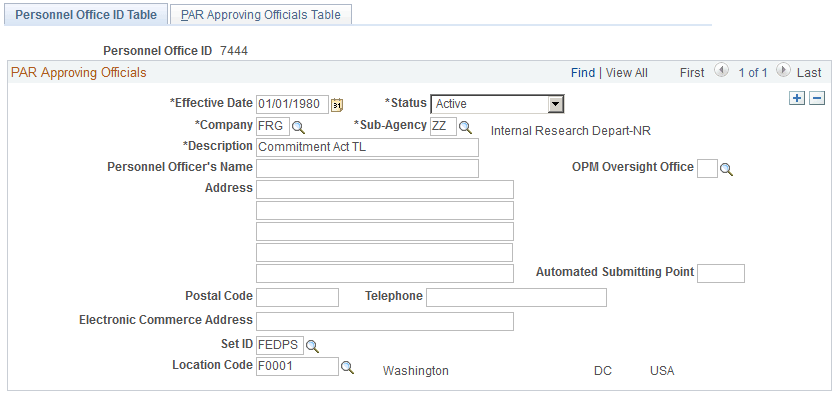

Personnel Office ID Table Page
Use the Personnel Office ID Table page (GVT_POI_TABLE1) to assign an identification number to every personnel office in your agency.
Much of the information that you enter is printed on the personnel action requests.
Navigation:
Set Up HCM, and then Product Related, and then Workforce Administration, and then Workforce Data USF, and then Personnel Office ID, and then Personnel Office ID Table
This example illustrates the fields and controls on the Personnel Office ID Table page. You can find definitions for the fields and controls later on this page.
Sub-Agency
Select the sub-agency code.
Personnel Officer's Name
Enter the name of the person who is responsible for personnel actions for this office.
OPM Oversight Office (office of personnel management oversight office)
Select the OPM Oversight Office to which you report personnel actions from the available values. The values are stored on the Translate table. To change or add values, inform your project management office of the updates you require.
Automated Submitting Point
The automated submitting point is an informational field and isn't used during PeopleSoft HCM processing. However, it is required on the OPM form that is used to communicate the establishment of or changes to a Personnel Office Identifier for currently operating personnel offices.
Electronic Commerce Address
This address is for your agency's information only. For example, this might be an email address or a government network ID.

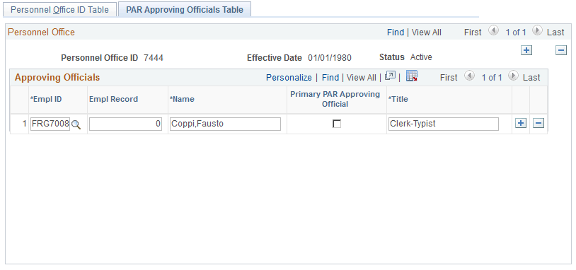

PAR Approving Officials Table Page
Use the PAR Approving Officials Table page (GVT_POI_TABLE2) to enter the names that appear in the routing process section of the PAR.
Navigation:
Set Up HCM, and then Product Related, and then Workforce Administration, and then Workforce Data USF, and then Personnel Office ID, and then PAR Approving Officials Table
This example illustrates the fields and controls on the PAR Approving Officials Table page. You can find definitions for the fields and controls later on this page.
Empl ID (employee ID)
Enter an employee ID for each official who approves personnel actions. When you move out of the field, the system populates the Empl Record, Name, and Title fields. You can edit these fields.
Primary PAR Approving Official (primary personnel action request approving official)
Select if applicable. This check box is for your information only.
