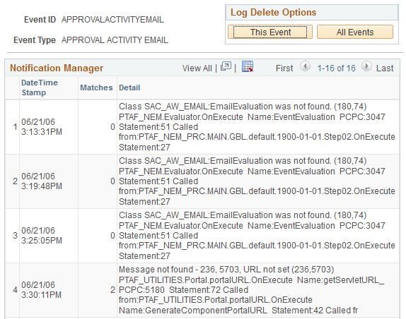

Event Status Page
Use the Event Status page (EOAW_NEM_STATUS) to view the status of an event.
Navigation:
Set Up HCM, and then Common Definitions, and then Approvals, and then Notification and Escalation, and then Event Status, and then Event Status
This example illustrates the fields and controls on the Event Status page. You can find definitions for the fields and controls later on this page.
Event Status page
Log Delete Options
Field or Control Description
This Event
Click to delete all notification event logs for the event ID that you selected.
All Events
Click to delete all notification event logs for all events.
Notification Manager
DateTime Stamp
Used in the Status record to track the results of each instance run.
Matches
Displays the number of rows that are returned from a row set.
Detail
Displays detailed status messages for each notification event.
