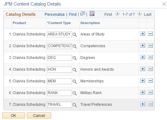

The system enables you to control the content types published to Clairvia, based on the primary person profile type defined on the Assign Profile Type Defaults page. Use the JPM Catalog Details page to select the content types published to Clairvia.
Use the JPM Catalog Details page (INSTALL_CATTYP_SEC) to define which content types to publish to Clairvia.
Navigation:
Click the Add JPM Content Catalog Details link on the Installed Integration Products page.
This example illustrates the fields and controls on the JPM Content Catalog Details page. You can find definitions for the fields and controls later on this page.
Field or Control Description
Content Type
Select the Profile Management content type to publish to Clairvia.

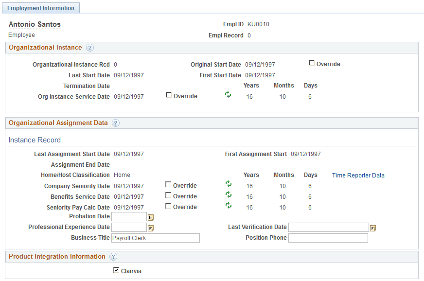

In order to send information to Clairvia, you must select the Clairvia field in the Product Integration Information region of the Job Data component for each Clairvia employee.
Use the Employment Information page (EMPLOYMENT_DTA1) to enroll the selected employee in Clairvia.
Navigation:
Click the Employment Data link at the bottom of any page in the Job Data or Current Job Data component:
Workforce Administration, and then Job Information, and then Job Data
Workforce Administration, and then Job Information, and then Current Job
This example illustrates the fields and controls on the Employment Information page, showing the Product Integration Information group box.
Clairvia
Select to enroll the employee in Clairvia.
Since basic HCM data flows only from PeopleSoft to Clairvia, you must add new employees to PeopleSoft before adding them to Clairvia.

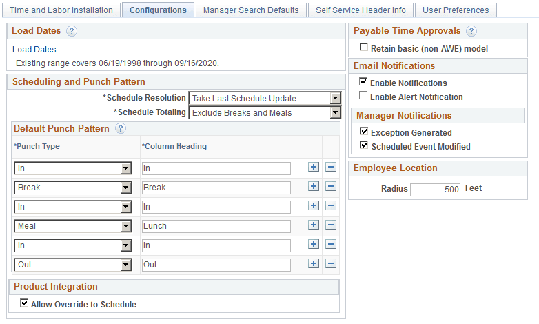

You can specify whether a manager can override the schedules sent from Clairvia. Enabling schedule overrides allows a manager to make ad hoc changes to schedules and create personal schedules for specific employees.
Use the Configurations page (TL_INSTL_PUNCH) to set up schedule total options, schedule resolution options, and punch pattern defaults for your Time and Labor application.
Navigation:
Set Up HCM, and then Install, and then Product Specific, and then Time and Labor, and then Configurations
This example illustrates the fields and controls on the Configurations page, showing the Product Integration group box. You can find definitions for the fields and controls later on this page.
Allow Override to Schedule
Select to enable a manager to change or override a Clairvia schedule for the employee and employee record combination on the Manage Schedules page. Deselect this field to prevent manager overrides of Clairvia schedules on the Manage Schedules page.
