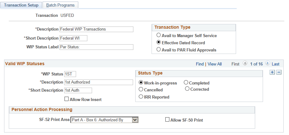

Transaction Setup Page
Use the Transaction Setup page (GVT_WIP_RECORD1) to define WIP statuses and associate status types for the USFED or Federal eApps transactions.
Navigation:
Set Up HCM, and then Product Related, and then Workforce Administration, and then Workforce Data USF, and then Approval Transaction setup, and then Transaction Setup
Select USFED as the Transaction value in the search page.
Select any other value starting with FE_ for Federal eApps for Self Service transactions.
This example illustrates the fields and controls on the Transaction Setup page. You can find definitions for the fields and controls later on this page.
Because the WIP setup is delivered with your system, we describe the page controls that appear on this page as they apply to our sample database. You can change the values in the USFED transaction to correspond to the setup that you require for your agency.
Field or Control Description
WIP Status Label
Enter a WIP status label. This label is for referencing the WIP status on various human resources pages. For example, for referencing the WIP status on the Administer Workforce request pages, the label in our sample system is Par Status (personnel action request status).
Avail to Manager Self-Service (available to manager self-service)
Select this option only when setting up approvals for self-service transactions.
Effective Dated Record
Select if the record is to be effective-dated. This must be selected for the USFED transaction.
Avail to PAR Fluid Approvals
Select this option only when setting up approvals for PAR transactions in fluid.
Valid WIP Statuses
WIP Status (work-in-progress status)
Add or modify the three-character status codes as necessary. Each WIP status represents a step in the approval process.
Description and Short Description
The system displays the description or short description on HCM pages when you select the three-character PAR Status that corresponds to the WIP status.
Allow Row Insert
Select this option if you want users to be allowed to insert a new row from a personnel transaction with the selected status.
For example, the Data Control page in Administer Workforce enables users to enter new effective-dated rows and add new data, creating a history of the changes. These types of pages are part of the WIP processing pages and depend on the WIP control configuration to designate the WIP status in which a user can enter a new row.
Status Type
Select the status type to be linked to the WIP status. Valid status types are:
  • Work-in-progress.
  • Completed.
  • Canceled.
  • Corrected.
  • IRR Reported (individual retirement record reported).
These status codes are defined in the overview to this topic.
See Understanding WIP Status Codes and Status Types.
Personnel Action Processing
In this group box, enter details related to printing forms from a page with the selected status.
SF-52 Print Area
Select the area where the name is to appear on the actual form; for example, Part A - Box 6: Authorized By.
Allow SF-50 Print
Select if you want the SF-50 button to be enabled. This allows the SF50 form to be printed for a personnel transaction with this status.
Reviewing all Data Rows
Continue reviewing and modifying data in the delivered data rows on the page. Add additional data rows if required.

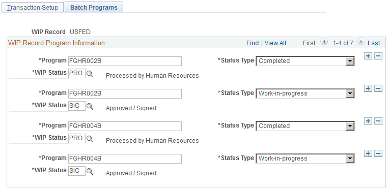

Batch Programs Page
Use the Batch Programs page (GVT_WIP_RECORD2) to specify WIP status and type for related batch processes.
This page appears only for the USFED transaction.
Navigation:
Set Up HCM, and then Product Related, and then Workforce Data USF, and then Approval Transaction setup, and then Batch Programs
This example illustrates the fields and controls on the Batch Programs page. You can find definitions for the fields and controls later on this page.
Batch Programs page
Program
Enter the name of the SQR, COBOL, or Application Engine process that inserts a new row. The row that the system inserts is the highest effective-dated row with the status type that is specified in the Status Type field on this page.
Add rows as necessary to add programs.
Status Type
Specify the status type for which a new row is to be inserted by the program. Options are as follows:
  • Completed: The system searches for both Completed and Corrected.
  • WIP: The system searches for Work-in-progress, Completed, and Corrected.
WIP Status
Select the WIP status to be inserted on the new row.
Example
For example, based on the exhibit above, the FGHR002B process inserts the highest effective-dated row with the status type Completed and displays PRO (Processed by Human Resources) in the WIP Status field.
