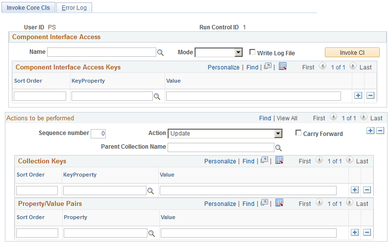

This example illustrates the fields and controls on the Invoke Core CIs page. You can find definitions for the fields and controls later on this page.
Component Interface Access
Field or Control Description
Name
Select the name of the component interface you want to test.
Mode
Select one of the following access modes:
  • Create: Select to create a new row of data in the component with the key values that you enter in the Component Interface Access Keys grid.
  • Find: Select to find a list of data rows that match the search criteria you enter in the Component Interface Access Keys grid.
  • Get: Select to find a single row of data that match the search criteria you enter in the Component Interface Access Keys grid.
Write Log File
Select to create a log file of the component interface test.
Invoke CI
When you've entered all of the necessary information, click to invoke the CI and test it using the information entered on this page.
Sort Order, KeyProperty, and Value
The component interface's key properties are the search keys of the underlying component's search record. Select with key fields to use in the search in the KeyProperty field and enter the value of the field to use in the search in the Value field.
If you are searching by more than one key field, indicate the order in which the system should sort the results.
If you are testing the CI using the Create action mode, use all the key properties.
Actions to be Performed
Sequence Number
Indicate the order in which the system should process this action using the component interface.
Action
Select the action to invoke using the CI:
  • Delete: Select to delete data rows that match the values you enter in this group box.
  • Get: Select to retrieve data rows that match the values you enter in this group box.
  • Insert: Select to insert a new data row with the values you enter in this group box.
    For example, if the current row is dated November 12, 2005 and you want to enter a row effective January 1, 2004 while still maintaining the November row as the current row, select this option.
  • Invoke Method:
    Select to run the method for the CI. A method, for instance, can process PeopleCode. For example, in Salary Planning, the calculation of the salary increase of each employee can be performed on-line or using a batch program. The batch program will process the method CI_SALARY_PLAN_GRP.Methods.SalPlanGrp.
  • Update: Inserts a new, effective dated row in effective-dated components or updates the data in components that are not effective dated.
  • Update no Insert: Select to update the existing row of data.
Carry Forward
Select this option to update any rows in the component that are more current than the row you are inserting using the CI.
Parent Collection Name
Select the collection (which corresponds to a record) in which you want to update data.
(Collection Keys) Select the key field or fields for the scroll and enter the value of the row upon which you want to perform the action.
Sort Order, Property, and Value
(Property/Values Pairs) Select the fields in the collection and the field values that you want to use in the action.
