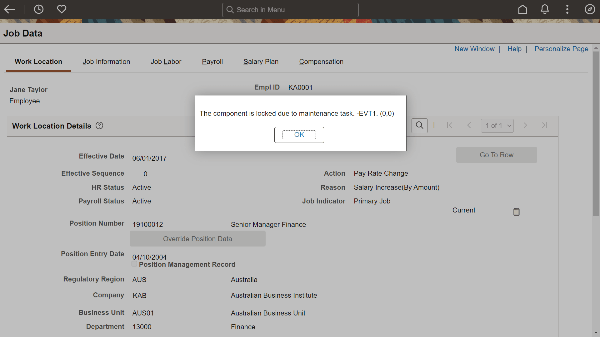

When you access a component while it's locked down, the system displays a configurable message stating that you can’t make any updates. When you click ok in the message, the component appears in read-only mode.
This example illustrates the lockdown message.
