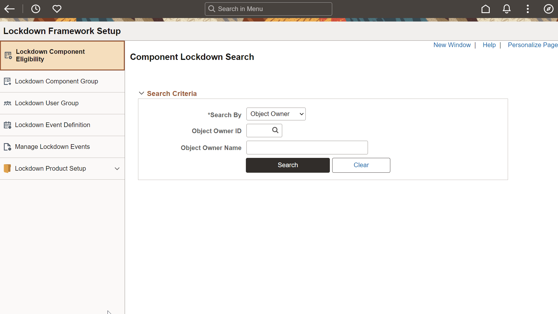

This example illustrates the pages that are displayed on the Lockdown Framework Setup start page.
Component Lockdown Search

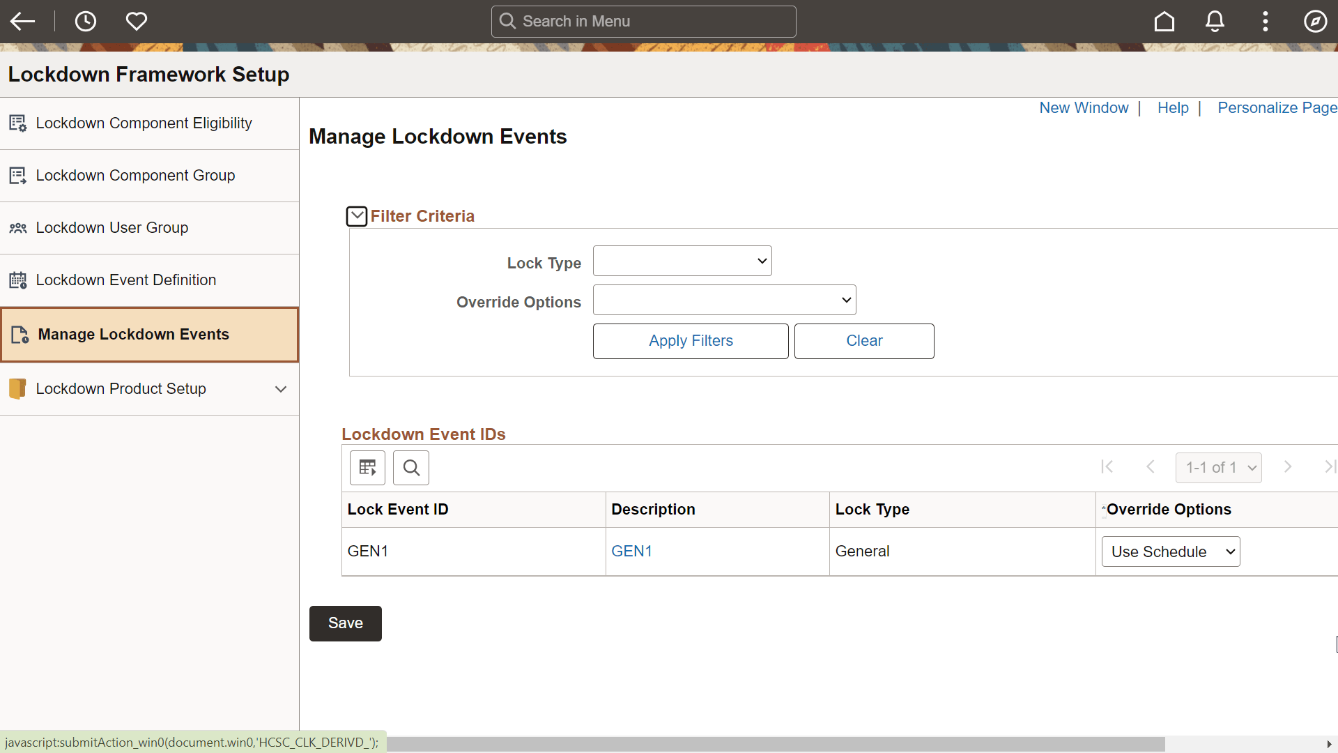

Manage Lockdown Events Page
HCSC_CLK_EVENTID_S
To view and on-demand lock or unlock an Event Definition.

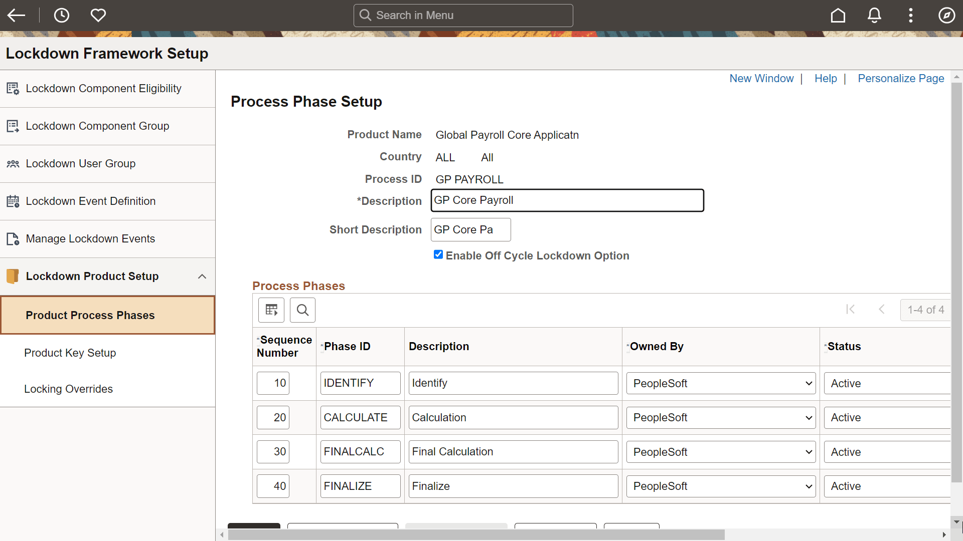

Process Phase Setup Page
HCSC_CLK_PRCPHASE
To setup the different processes and phases for a product or country based on which the components are locked down.

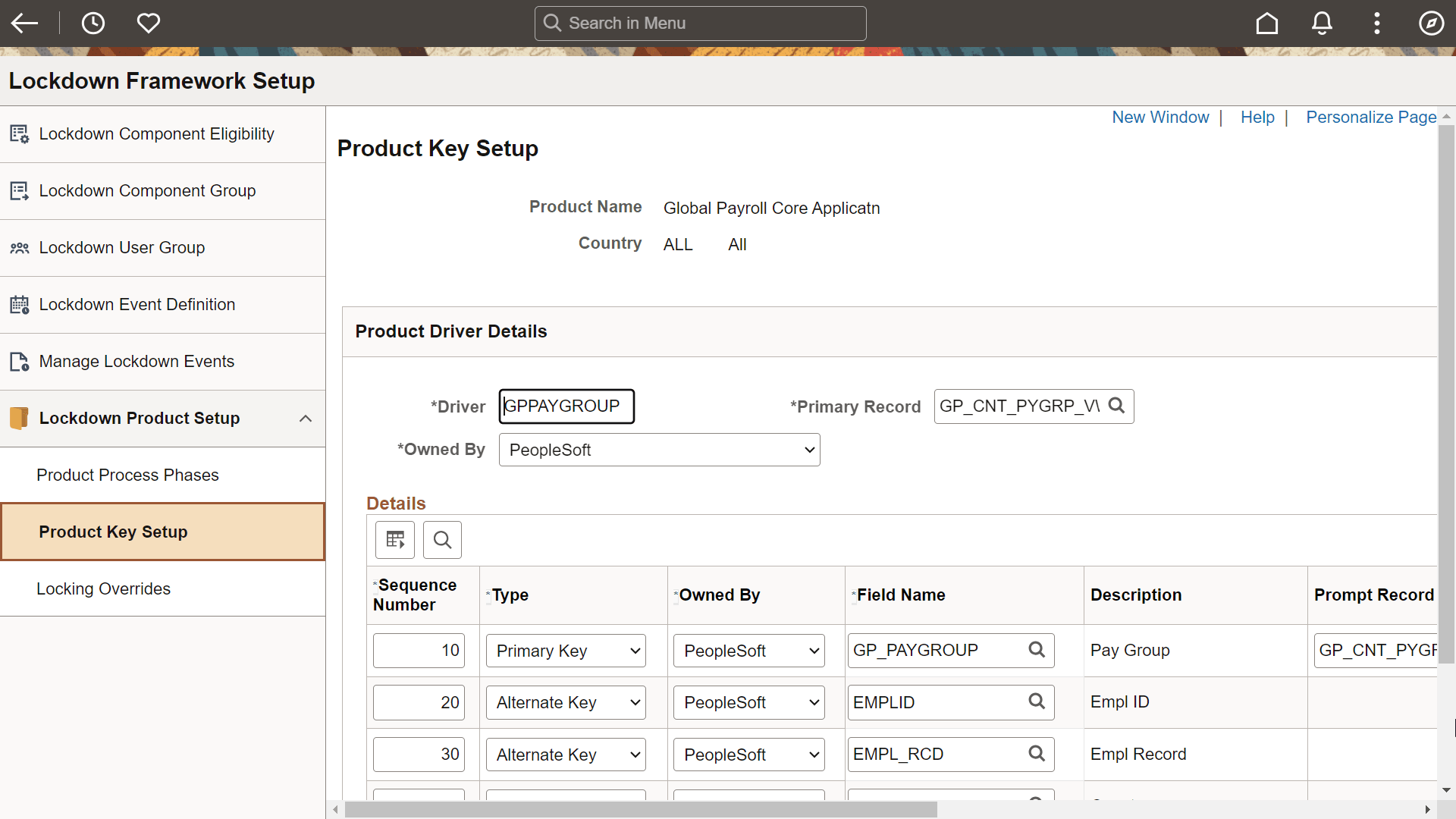

Product Key Setup Page
HCSC_CLK_PRD_LVKEY
To define key fields (drivers) to help define groups for lockdown beyond users and roles.

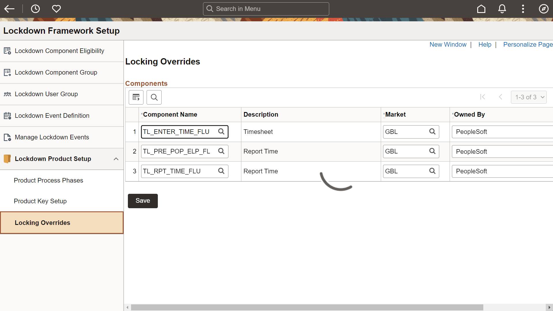

Locking Overrides Page
HCSC_CLK_LCKOVRIDE
To override standard Event Mapping definitions, which occur when the Component Eligibility table is updated and saved.

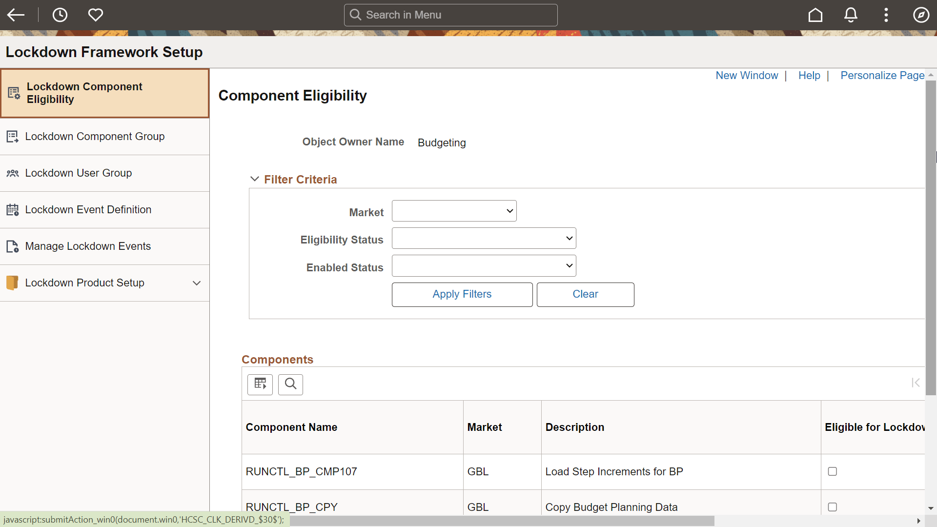

Component Eligibility Page
Use the Component Eligibility page (HCSC_CLK_COMP_ELIG) to define which components are Eligible for a Lockdown Event.
The user can search components based on Object Owner ID or Component Name. Clicking the Component in the search result displays the Component Eligibility page listing all components for the chosen Object Owner ID with the chosen component as the first row. The searched component is displayed as the first row only if search is based on Components.
Navigation:
Set Up HCM, and then Common Definitions, and then Lockdown Framework, and then Lockdown Framework Setup, and then Lockdown Component Eligibility
This example illustrates Component Eligibility page.
Filter Criteria
Use the Filter Criteria section to filter the rows to make sure that all the components are set up correctly. You can refine the search based on Market, Eligibility Status and Enabled Status.
Components
The Components grid lists all the components based on selected Filter criteria.
Field or Control Description
Component Name and Market
These fields uniquely identify a component.
Description
Displays the component description as defined in PeopleTools.
Eligible for Lockdown
Select this check box to indicate that the component is eligible for a lockdown. These are the only components that will be available to add to component groups. You cannot deselect this check box for a component that is already part of a component group. If you try, a message tells you which groups the component needs to be removed from.
The Eligible for Lockdown field will remain ON if the Event Mapping fails when trying to disable a component.
Lockdown Enabled Status
Displays the component lock enabled status.
Available values are:
  • Enabled: This status indicates that the component was marked eligible for lockdown and the event mapping was successful.
  • Not Enabled: This status indicates the component has not been made eligible for lockdown.
  • Failed: This status is displayed if the Event Mapping (or Un Mapping) fails for some reason.
  • New: This status is displayed when the component Eligibility page is launched for the first time for a product or if a component has been newly added to a product.

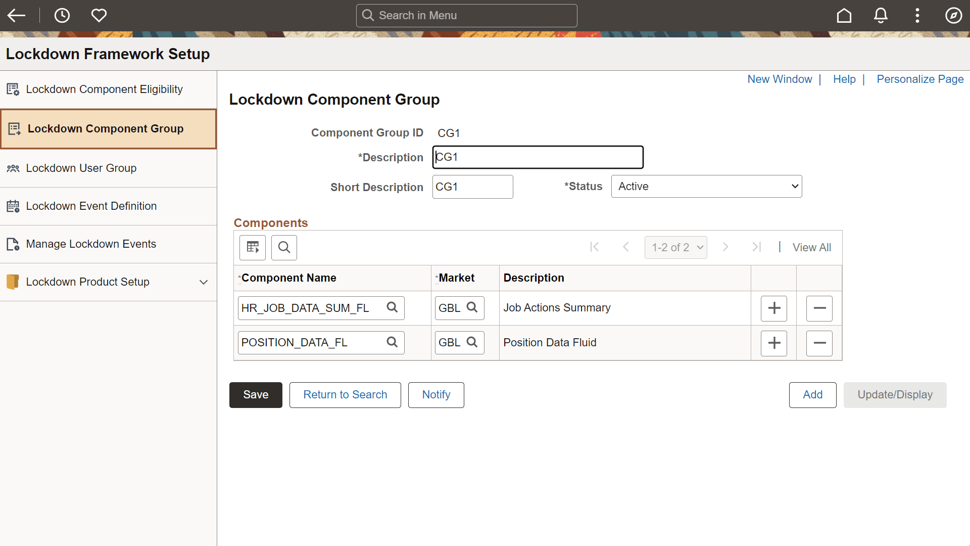

Lockdown Component Group Page
Use the Lockdown Component Group page (HCSC_CLK_COMP_GRP) to group components that are eligible for lockdown.
Navigation:
Set Up HCM, and then Common Definitions, and then Lockdown Framework, and then Lockdown Framework Setup, and then Lockdown Component Group
This example illustrates the Lockdown Component Group page.
Lockdown Comp Group
Component Group ID
Unique ID of the component group.
Description
Meaningful description of the component group description.
Short Description
Short description of the component group.
Status
Status of the component group. An inactive component group in Event definition will show a message with the Event IDs that need to be removed.
Component Name
Select a component to include in the group. The component’s object name and market uniquely identify the component.
You can only select the components that have the Enabled for Lockdown check box selected on the Component Eligibility page.
Market
Select the component market. As CAN and USA are not separate products, you can specify either CAN or USA as the market.
Components
Use the Components grid to list the components in the group.

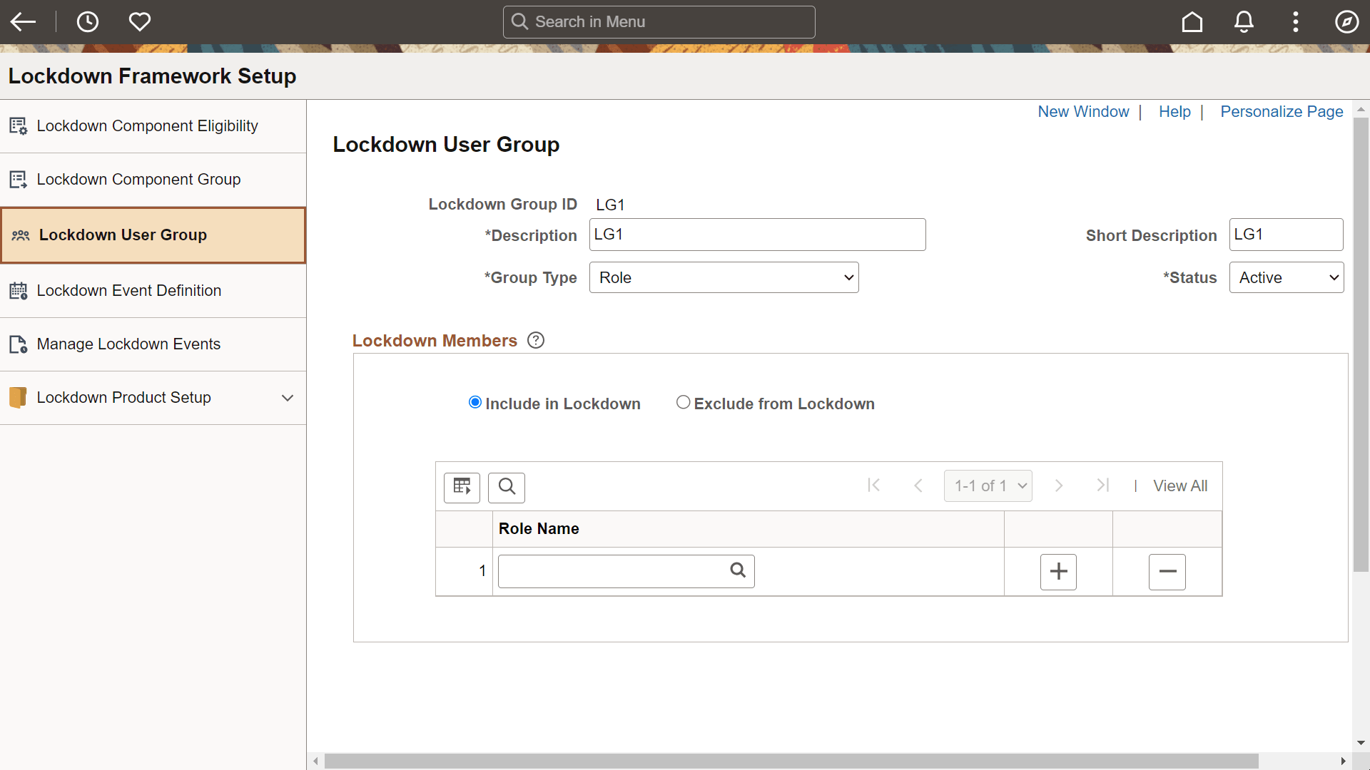

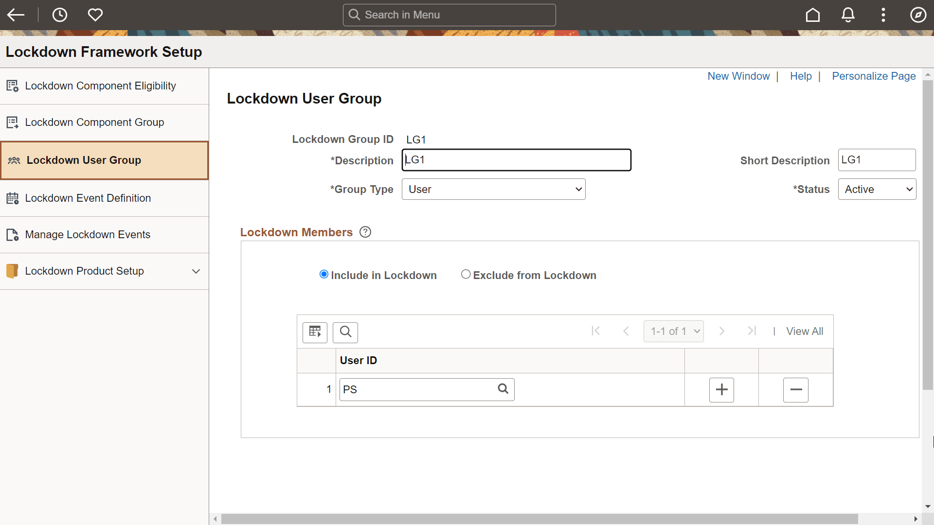

Lockdown User Group Page
Use the Lockdown Group page (HCSC_CLK_LOCK_GRP) to set up lockdown groups. The lockdown group specifies who should be impacted by the locking. You can group users, roles, or product keys for lockdown.
Navigation:
Set Up HCM, and then Common Definitions, and then Lockdown Framework, and then Lockdown Framework Setup, and then Lockdown User Group
This example illustrates the Lockdown User Group page for User group type.
Lockdown User Group
This example illustrates the Lockdown User Group page for Product Key group type.
Lokdown User Group_PdtKey
This example illustrates the Lockdown User Group page for Role group type.
Lockdown User Group_Role
Lockdown Group ID
Unique ID of the lockdown group.
Description
Enter a meaningful description of the lockdown group.
Short Description
Enter a short description of the lockdown group.

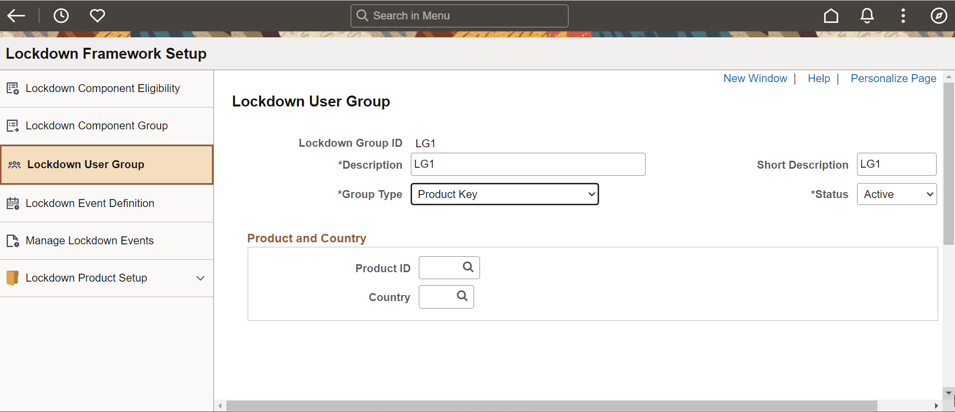

Group Type
Select the required group type based on which the lockdown group is created.
  • Product Key: Lockdown group is set up based on products (Global Payroll, Payroll for North America, Absence Management).
  • Role: Lockdown group is set up based on roles.
  • User: Lockdown group is set up based on users.
Status
Status of the lockdown group.
Available options are:
  • Active
  • Inactive
Product and Country
The Product and Country section is displayed only when the value selected in the Group Type field is 'Product Key'.
Product ID
Unique ID of the product.
Country
Specifies the country for which you are defining the lockdown group.
Lockdown Members
The fields in the Lockdown Members grid vary dynamically based on the primary key field defined for a product key driver in the Product Key Setup page. For example if Product is Payroll for North America the grid will contain Company and Pay Group. If Product is GP Payroll or Absence Management the grid will contain Pay Group.
Include in Lockdown
Select this option if you want to include the selected members in the lockdown group.
Exclude from Lockdown
Select this option if you want to exclude the selected members in the lockdown group.
Applies to ALL
Select this option if you wish to add all driver key field values under the selected product to lockdown group. When this option is selected, the lock group values are retrieved from the primary record specified in the Product Key Setup page.
If this option is selected, the Lockdown Members grid is cleared and disabled.
Note: This field is displayed only when the value selected in the Group Type field is Product Key.
User ID
Enter the required user you wish to add to the lockdown group.
Note: This field is displayed only when the value selected in the Group Type field is User.
Role Name
Enter the required user roles you wish to add to the lockdown group.
Note: This field is displayed only when the value selected in the Group Type field is Role.
Driver
This field is available only if group type is Product Key. This field is loaded with Driver values defined in the product key setup.
Primary Key <1 to n>
This field is dynamic and its label depends on the product key definition.
For example, if you select the Product ID as GP or AM, this field name is displayed as Pay Group. You can enter the required pay groups you wish to add to the lockdown group.

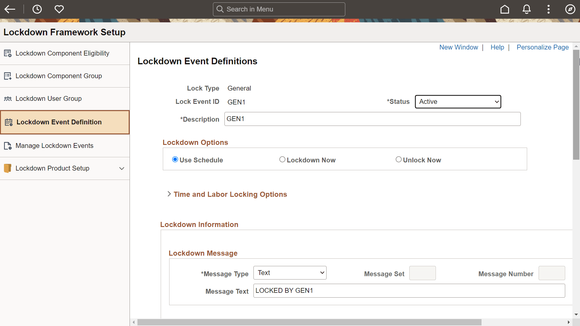

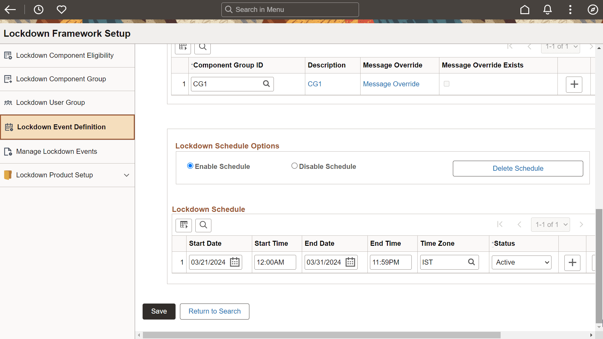

Lockdown Event Definition Page
Use the Lockdown Event Definition page (HCSC_CLK_EVENTDEFN) to define Lockdown Event; to specify what, why, when and for whom the components should be locked.
Lockdown events can be defined in two ways:
  • Process based lockdown: In Process Based Lock event, Product Process phases are added to indicate the different Phases WHEN the lockdown should occur. For example, GP - Identify, Calculate and Finalize Phases. When these Phases are running the component will be locked for the specified lock groups.
  • General lockdown (Non Process): In General Based Lock event, a lockdown schedule is added which indicates Start and End date/Time WHEN the lockdown should occur. For example, components will be locked-down during a particular period of time for the specified lockdown group.
Navigation:
Set Up HCM, and then Common Definitions, and then Lockdown Framework, and then Lockdown Framework Setup, and then Lockdown Event Definition
Lockdown Event Definition - General Events
Use this page to create general lockdown event definitions.
This example illustrates the Lockdown Event Definitions page for a General based Lockdown Event (1 of 3).
Lockdown Event Defn1
This example illustrates the Lockdown Event Definitions page for a General based Lockdown Event (2 of 3)
lockdown Event Defn2
This example illustrates the Lockdown Event Definitions page for a General based Lockdown Event (3 of 3).
Lockdown Event Defn3
Lock Type
Type of lockdown event. That is, whether the events are generated based on Process based lockdown or General lockdown.
Lock Event ID
Unique ID of the lockdown event definition.
Status
Status of the lockdown event definition.
Description
Meaningful description of the event definition.

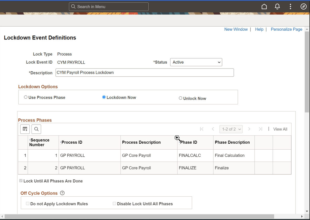

Lockdown Options
Use the Lockdown Options section to lock or unlock an event.
Use Schedule
This is the default value and simply indicates that the lockdown event is using the schedule that is entered. This option only applies when Lock Type is General.
Lockdown Now
Select this radio button to immediately lock down the system, regardless of whether a process is running or regardless of the schedule for general lockdown.
If Lockdown Now option is selected:
  • For General Lockdown: User is allowed to edit the Lockdown Message, Lockdown User Group, and Lockdown Component Group sections. The Lockdown Schedule Options and Lockdown Schedule Grids are display only as the Lockdown Now functionality ignores the Lockdown schedule information.
  • For Process Lockdown: User is allowed to edit the Lockdown Message, Lockdown User Group, and Lockdown Component Group sections. The Process Phase grid is display only.
Note: Lockdown Now solely applies to the components and users specified in the event definition.
Unlock Now
Select this radio button to stop any active lockdowns. This option is mainly used:
  • If a process based event is running, and got aborted.
  • If the process based event is running and you want to unlock the system for any reason.
Note: The Unlock Now option takes precedence over the Lockdown Now option.
Note: Unlockdown Now solely applies to the components and users specified in the event definition.
Time and Labor Locking Options
Use the Time and Labor Locking Options to lockdown a prior period or both the prior and current period time reporting components.

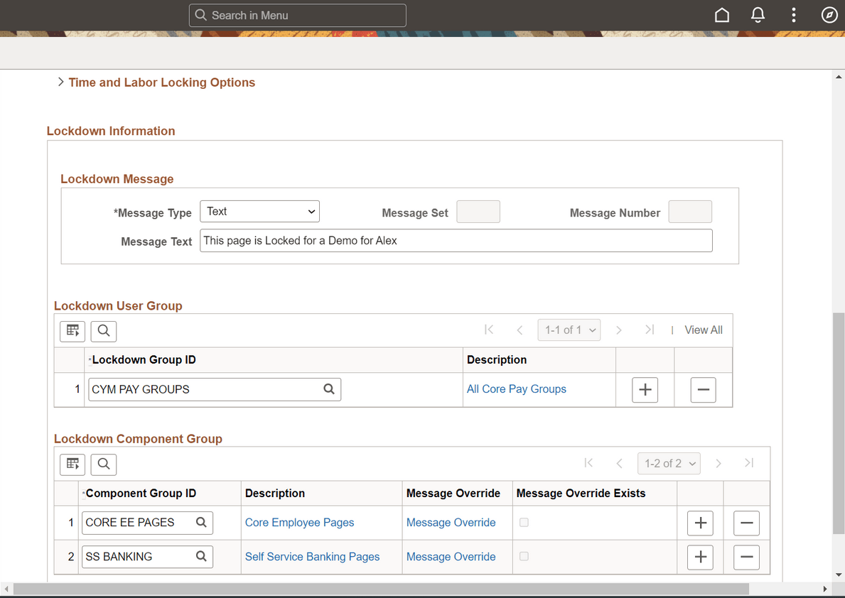

Lockdown Message
In the Lockdown Message grid, you can specify what the online message will be when a user attempts to access a locked component. Messages can be defined in two ways:
  • The default message can be used by all defined Component Groups.
  • On the Component Group section, you can override this default message.
Message Type
Select the required message type.
  • Message Catalog: If Message Catalog is selected, you must enter values in Message Set and Message Number fields.
  • Text: If Text is selected, you must enter value in Message Text field. Translations are not supported for this message type.
Message Set
Select the required message set number.
Message Number
Select the required message number.
Message Text
Enter the message text.

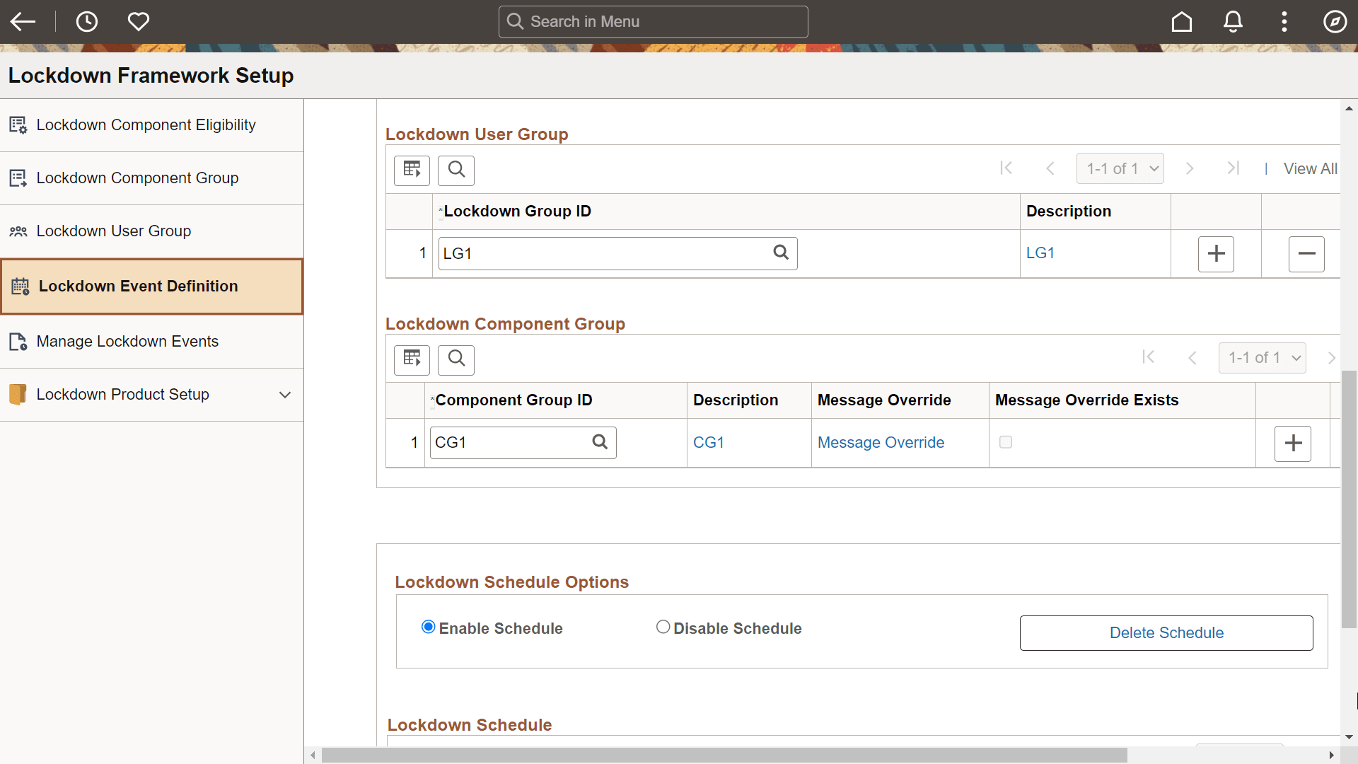

Lockdown User Group
The Lockdown User Group grid is used to define who gets locked out.
Lockdown Group ID
Select the lockdown group ID which you want to map to the event definition. Only Active Lockdown Groups can be selected.
Description
Description of the lockdown group. Click the hyperlink to access the Lockdown Group page corresponding to the selected lockdown group ID.
The Lockdown Component Group grid is used to select the component group IDs you want to map to the event definition. A Component Group Id determines which components are locked out.
Component Group ID
Select the required component group ID you want to map to the event definition. Only active components can be selected.
Description
Description of the component group. Click the hyperlink to access the Lockdown Component Group page corresponding to the selected component group ID.
Message Override
This option allows the user to define a unique message for a specific Component Group, instead of the default message. Click the Message Override link to define the message.
Message Override Exists
The message override checkbox indicates whether the user has defined a message override for a specific component group.
Use the Lockdown Schedule Options grid to enable, disable or delete the lockdown schedules.
Enable Schedule
Select this radio button to enable the schedule, which means the schedule is active.
Disable Schedule
Select this radio button to temporarily disable the lockdown schedule. By selecting this radio button, the Lockdown Schedule grid is disabled.
Delete Schedule
Select this button to delete the current and future dated schedule rows.
Lockdown Schedule
Use the Lockdown Schedule grid to create lockdown schedules.
Start Date
Schedule start date.
Start Time
Schedule start time.
End Date
Schedule end date.
End Time
Schedule end time.
Time Zone
Select the required time zone.
This start and end times are determined by the time zone you have selected. Users' access times are determined by their timezone preferences.
Status
Status of the schedule.
  • Active: Select this option to enable the schedule.
  • Inactive: Select this option to temporarily disable the schedule.
The components are not locked if the user does not enter any Lockdown Schedule information or Lockdown Schedule is disabled.
Lockdown Event Definition - Process based Events
Use this page to create process based lockdown events.
This example illustrates the Lockdown Event Definitions page (1 of 2) with lockdown type as Process.
Process Lockdown Event Definition1
This example illustrates the Lockdown Event Definitions page (2 of 2) with lockdown type as Process.
Process Lockdown Event Definition2
Lockdown Options
Use Process Phase
Select the Use Process Phase radio button to create rules based on a Process Phase (such as Calculation and Confirm).
Lockdown Now
Select this value if you want to immediately lockdown the system.
Unlock Now
Select this value to stop any lockdown that is currently in effect. This is typically used when an abort occurs during a Process Based Event. If you have a process-based event in place and simply do not want to lockdown the system, you can select this option.
Process Phases
The Process Phases grid allows you to indicate the process/phase(s) that are included in the lockdown, per Sequence Number.
The Process Phase grid is displayed only for Process based Events.
Sequence Number
Enter the sequence number of the process/phase.
Process ID
Select the unique id of the process/phase setup component. If the Phases from different process IDs are added, a warning message is displayed, to make sure that the keys of all processes are same.
Process Description
Displays description of the selected process.
Phase ID
Select the required phase ID.
Phase Description
Displays description of the selected phase.
Lock until all Phases are Complete
Select this checkbox if you want to lock down the system between phases, such as between Final Calculation and Confirm/Finalize, or from Finalize to Banking. The system will stay locked until all the phases are complete.
Off Cycle Options
The Off Cycle options are displayed only when Enable Off Cycle Lockdown Option field is checked in the Process Phase Setup page.
Do Not Apply Lockdown Rules
Select this checkbox to indicate if the system should ignore lockdown rules, for an off cycle run.
Disable Lock Until All Phases
Select this checkbox to indicate if the system should ignore Locking Until All Phases, for an off cycle run.
This option is available only when Lock until allPhases are Complete check box is selected .It is not possible to select the Disable Lock until All Phases option if the Do not Apply Lockdown Rules option is selected.
For details on the rest of the grids available in the Lockdown Event Definition page, see the Lockdown Event Definition page for General Process.
Use the Manage Lockdown Events page (HCSC_CLK_EVENTID_S) to to lock or un-lock event definitions on-demand. You can also view/update the Lockdown Event Definition.
Navigation:
Set Up HCM, and then Common Definitions, and then Lockdown Framework, and then Lockdown Framework Setup, and then Manage Lockdown Events
This example illustrates the Manage Lockdown Events page.
Use the Filter Criteria section, to filter the lockdown events based on Lock Type and Override Options.
Lock Event ID
Displays unique ID of the active lockdown events.
Description
Description of the lockdown event definition. Click this link to access the Lockdown Event Definition page, where you can edit the required details.
Lock Type
Displays the lockdown type of the the event.
Override Options
Select the required value from the drop-down list. You can override the lockdown options corresponding to the selected lockdown event without accessing the Lockdown Event Definition page.
Values in the list are:
  • Lockdown Now: You can select this value if you want to immediately lockdown the system.
  • Unlock Now: You can stop any lockdown that is currently in effect by selecting this value. This is typically used when an abort occurs during a Process Based Event. If you have a process-based event in place and simply do not want to lockdown the system, you can select this option.
  • Use Schedule: Indicates that the events are locked down based on schedules. This value is displayed for general based lockdown event.
  • Use Process Phase: Indicates that the events are locked down based on process phases. This value is displayed for process based lockdown events.
Use the Process Phase Setup page (HCSC_CLK_PRCPHASE) to setup the different processes and phases for a product or country based on which the components are locked down. The lockdown components use this setup to capture phases; which will then appear in event definitions.
Navigation:
Set Up HCM, and then Common Definitions, and then Lockdown Framework Setup, and then Lockdown Product Setup, and then Product Process Phases
This example illustrates the fields and controls on the Process Phase Setup page.
Process Phase Setup
Product Name
Displays the name of the product.
Country
Displays the country name.
Process ID
Displays the unique ID of the process that triggers the lockdown. Delivered processes are: GP PAYROLL: for the GP Payroll process; ABSENCE. For the Absence Management process; PNA PAYROLL: For the PNA Payroll process.
A technical brief with detailed instructions on how to add your own processes is posted to My Oracle Support. To access this technical brief, search for Doc ID 2963239.1.
Description
Enter a meaningful description of the process.
This field determines whether off cycle options appear on a Process Based Lockdown Event.
Sequence Number
Displays sequence number of the product phase.
Phase ID
Unique identifier for each phase of the selected product.
Description
Enter a meaningful description of each phase.
Owned By
Select whether the phase is owned by PeopleSoft or Customer. If the customer adds any new phase, then the value of the Owned By field will be set to Customer. In the Customer environment, this field is set to display only. Users cannot modify or delete PeopleSoft owned phases.
Status
Select the required status to be assigned to each phase. Available options are Active and Inactive.
If a phase is marked as inactive; it cannot be selected when creating a Process Based Event Definition.
Use the Product Key Setup page (HCSC_CLK_PRD_LVKEY) to define key fields (drivers) to help define groups for lockdown beyond users and roles. This table is delivered by PeopleSoft based on the unique driver(s) for each Process supported by PeopleSoft.
Navigation:
Set Up HCM, and then Common Definitions, and then Lockdown Framework Setup, and then Lockdown Product Setup, and then Product Key Setup
This example illustrates the Product Key Setup page.
Product Key Setup
Driver
Enter the primary key field which drives your product.
Primary Record
Select the Primary key record; that returns all the primary key values for the product and country.
Note: Primary key values are retrieved from this record with the option 'Applies to All' in the lockdown group.
Owned By
This field is displayed as PeopleSoft for PeopleSoft delivered keys. If the database is owned by the customer, this field displays the value Customer for newly added keys.
Sequence Number
Sequence number of the primary key field applicable for the key value.
Type
Select the type of the key field.
  • Primary Key: Primary keys are the fields that drive the entire lockdown process for a product/country. The primary keys defined here will be used in the Lockdown Group Definition.
  • Alternate Key: Alternate keys are fields that are not primary and could be used as search keys for many components.
Owned By
Field Name
Select the key field name.
Description
Description of the selected field.
Prompt Record
Prompt record for the primary keys. Prompt records should contain the corresponding primary key field.
SQL Object Identifier
Unique ID of the SQL object. For Alternate key fields, it is mandatory for the user to enter the SQL Id. This SQL Id will be used to derive the Primary driver key values for the chosen alternate key value.
View SQL
Click View SQL link to access the View SQL Definition modal window, where you can the SQL statement text. This link is displayed if a SQL Id is entered by the user.
Use the Locking Overrides page (HCSC_CLK_LCKOVRIDE) to override standard Event Mapping definitions, which occur when the Component Eligibility table is updated and saved.
Navigation:
Set Up HCM, and then Common Definitions, and then Lockdown Framework Setup, and then Lockdown Product Setup, and then Locking Overrides
This example illustrates the Locking Overrides page.
Locking Overrides
Component Name
Select a component for which default event mapping needs to be skipped.
Market
Select component market for which default event mapping needs to be skipped.
Owned By
Select the required value from the Owned By field.
  • PeopleSoft
  • Customer
