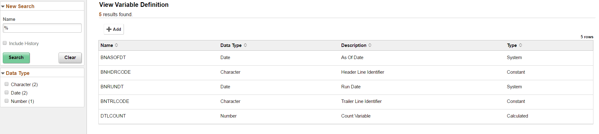

Variable Definition Setup Page
FF_VARIABLE_DTL_FL
Create variables for the file definition.

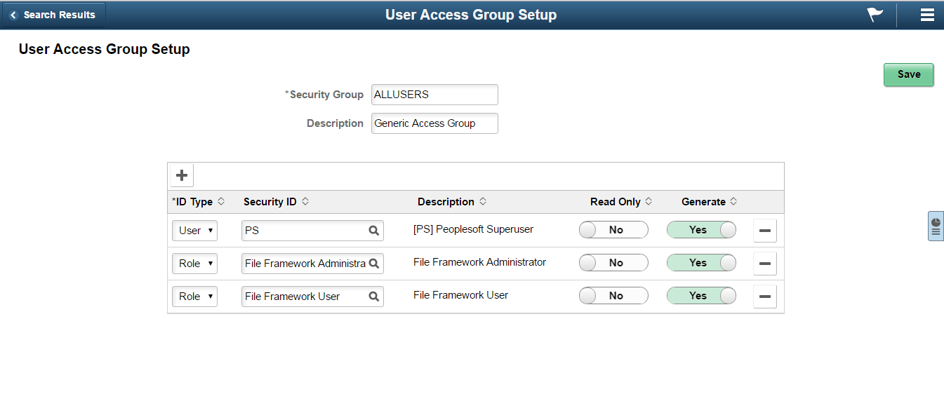

User Access Group Setup Page
Use the User Access Group Setup page to set row level security for each file definitions.
Navigation:
Set Up HCM, Common Definitions, File Integration Framework, User Access Group Setup
The fields and their description are given later in this page.
Field or Control Description
Security Group
Access ID for a group to which a set of security permissions can be set.
Note: The members of the security group need the following permissions to the file integration pages: File Integration Administrator, File Integration User. If users needs to view the activity guide, then they need the File Framework Viewer permission.
Description
Description of the Security Group.
ID Type
Select the ID type of User ID or Role to grant authorization to.
Security ID
Select the authorized editor’s security ID based on the ID type.
Description
This is a read-only field that indicates the related display value for the security ID.
Read Only
Option to whether the User ID or Role can edit the configuration or can only view it. By default they can edit the configuration.
Generate
Option to whether the User ID or Role can generate the flat file. By default they can generate the flat file.

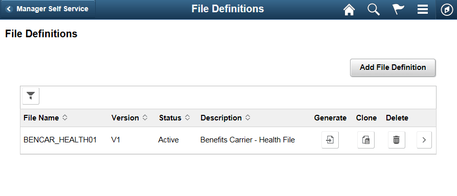

File Definitions Page
Use the File Definitions page (FF_SETTING_SRCH_FL) to view the file definitions and to create new definitions.
Navigation:
Set Up HCM, Common Definitions, File Integration Framework, File Definitions.
Users can filter for a file definition using the filter option. The fields and their description are given later in this page.
File Name
Name of the flat file definition.
Version
Version of the file definition.
Status
The status of the file definition. The available statuses are Active, In Progress and Inactive. Only Active file definitions can be selected at runtime.
Description
Description of the file definition.
Generate
Generate the flat file. This can be done only if the Status of the file definition is Active.
Clone
Clone the file definition.
Delete
Delete the file definition.

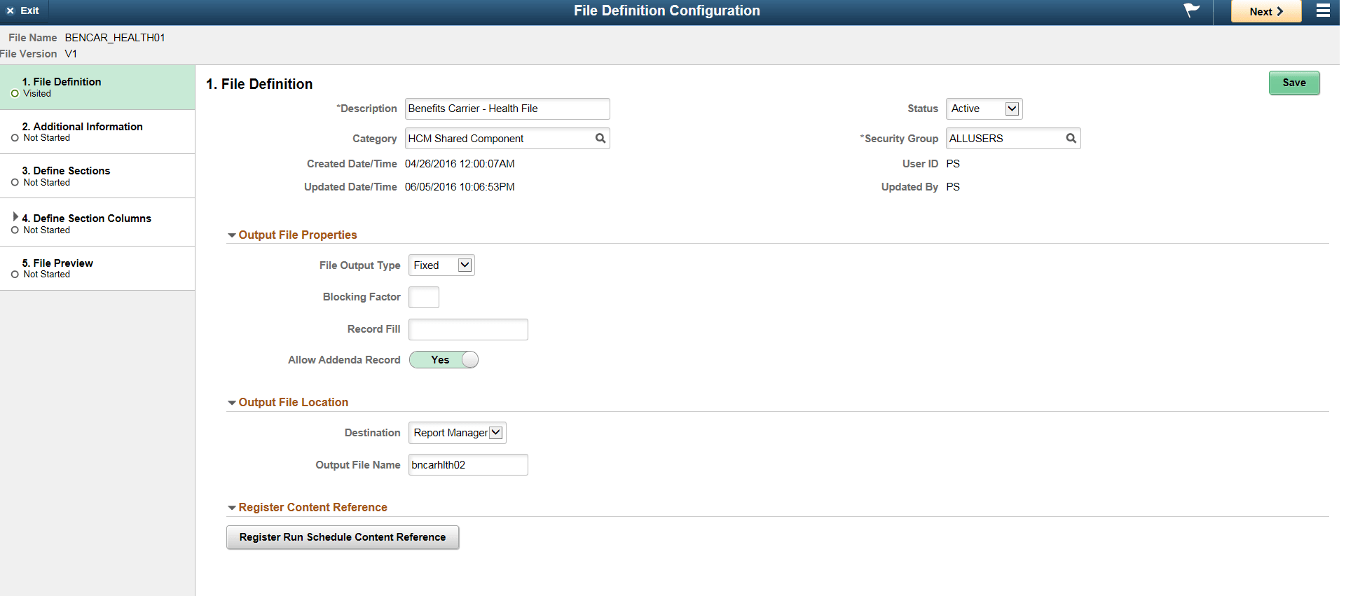

File Definition Configuration - File Definition Page
Use the File Definition Configuration - File Definition page (FF_SETTINGS_FL)to set general definitions for the file.
File Definition Configuration - File Definition Page.
Description
Status
Status of the file definition. The available statuses are Active, In Progress and Inactive.
Category
Choose the Category.
Security Group
Security group for the file definition. with this user can control the members who can view or edit the file definition.
File Output Type
Specify the whether the file output is Fixed or Delimited.
Blocking Factor
For Fixed output file, if required, specify the blocking factor. i.e. the number of records of a file that make a block. The total number of records in the flat file should be evenly divisible by the blocking factor.
Record Fill
For fixed output file, specify the record fill if the actual number of records is not evenly divisible by the blocking factor.
Delimiter
For delimited files, specify the delimiter. Available delimiters are Comma, Other, Semi Colon, Space, Tab. Comma is the default delimiter. If Other is selected, then a character input text box is displayed to define the delimiter.
Qualifier
For delimited files, specify the qualifier.
Allow Addenda Record
Option to add additional record based on certain conditions. This is done while defining the section columns.
Destination
Destination for the output file. Available destinations are File Path, Report Manager, URL.
Output File Name
Name of the output file. This can be changed during file generation.
Register Run Schedule Content Reference
Creates a direct link to run the file definition.

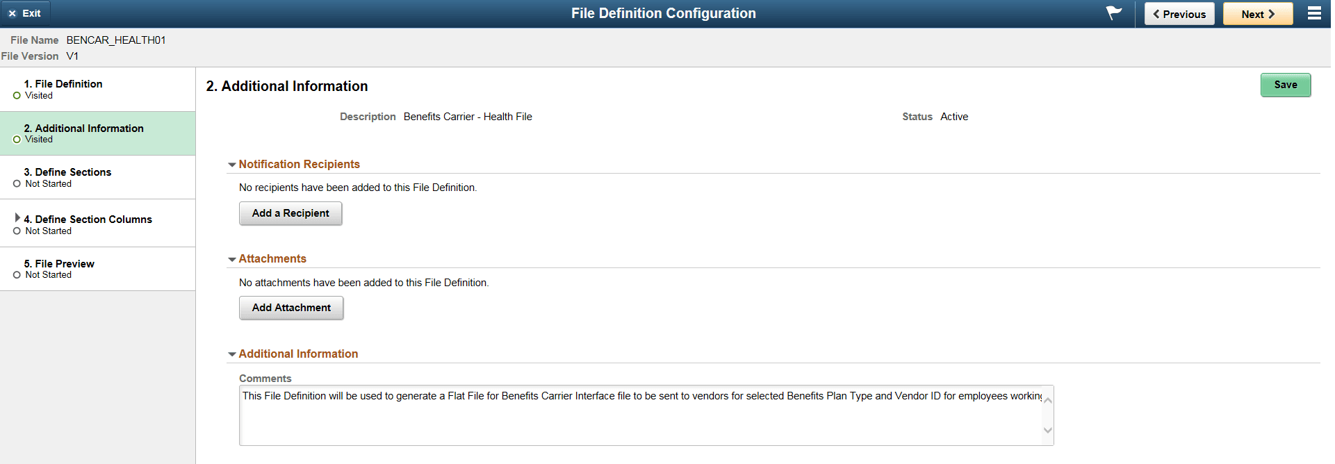

File Definition Configuration - Additional Information Page
Use the File Definition Configuration - Additional Information page (FF_SETTING_ADDL_FL) to set additional definitions for the file.
Add a Recipient
Add the recipients that need to be notified during file generation.
Add Attachment
Add any supplementary file attachment for the recipients.
Add additional comments for the recipients.

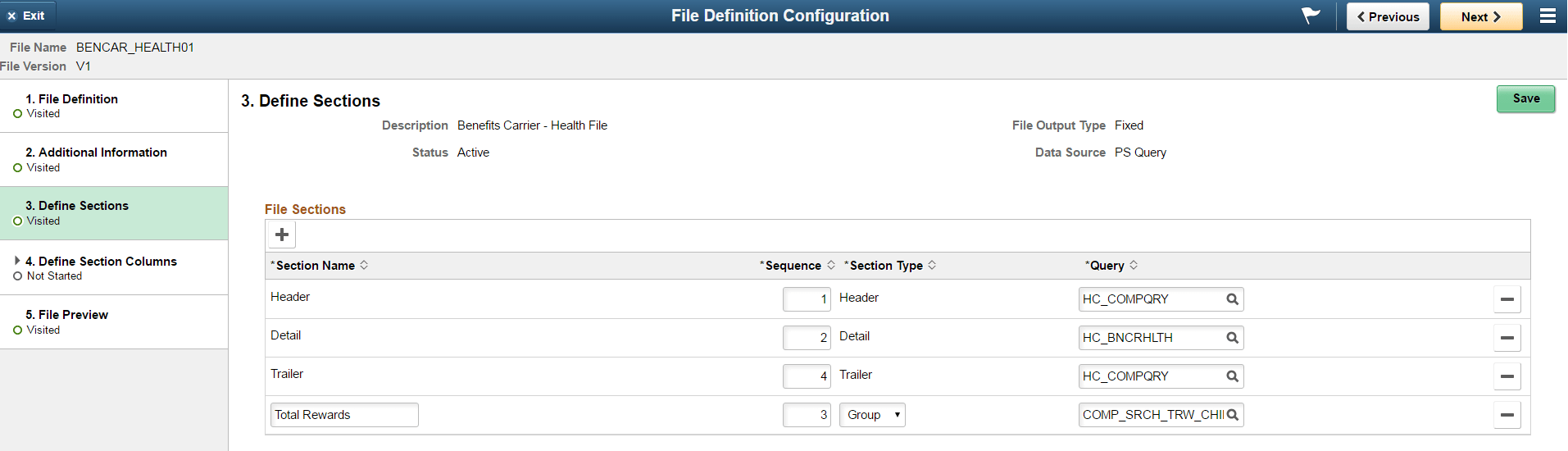

File Definition Configuration - Define Sections Page
Use the File Definition Configuration - Define Sections page (FF_SECT_DETAILS_FL) to define the sections for the file.
Section name
Name of the section.
Sequence
The sequence in which the sections should be arranged.
Section Type
The type of sections. Available section types are Header, Detail, Trailer, Group.
Note: The Group section enables users to group the output based on particular criteria. e.g. Company, Department etc.
Query
Choose the associated PS Query for the section.
The Types of section available are Header, Detail, Trailer and Group.
Group Section
This section is used when the user wants to group the generated output. The output for a group section is generated from a single data source where the group header and trailer information is common to all detail rows in the output. e.g. User wants to generate the employee payment details for a particular paygroup, but would want the output to be grouped by company.

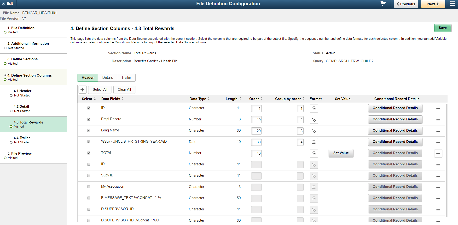

File Definition Configuration - Define Sections Columns Page
Use the File Definition Configuration - Define Sections Columns page (FF_COLUMN_DETLS_FL) to configure the columns for the sections.
File Definition Configuration - Define Sections Columns Page.
Select
Select the data fields to be included in the output file.
Data Fields
Name of the data field.
Data Type
Data type of the field.
Length
Length of the data source field.
Order
Enter a sequence for the Section column. This field determines the order in which the data field appears in the output file.
Group by order
Group the detail rows based on the Group by order columns and in the order of sequence specified.
Format
The format of the data field.
Set Value
If additional variables have been added from the Variable Definition page, set the value of the variable. For more details, see Variable Definition Setup Page
Conditional Record Details
Specify the conditional record details. This field is displayed only if user has selected Allow Addenda Record in the File Definition page.
In addition to the data populated from a query, administrators can also add variables that would be displayed in the output file. Administrators would not be allowed to delete the data source columns that are populated from data source query, but they can delete the manually added variables from the list. User defined variables of type Calculated can only be added to Header, Trailer or a Group section and would not be available for Detail sections.
Set Value for the Variable
For adding a Constant Variable, a free text field is displayed to enter the value for the constant variable.
A System variable is used to add current system information to the output file. The following options are available for System variable:
  • As Of Date
  • Current Date
  • Current DateTime
  • Current Time
  • UserId
  • Sequence number
Set a calculated value.
Set Value
A Calculated variable is used to display aggregates of data source in the file output. Users can specify the type of aggregate (Avg, Count, Max, Min and Sum).
Format
The Format option is enabled for the data field that the user chooses to include as part of the file definition.
Format Column
Format Column

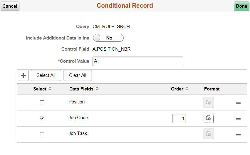

This field is displayed if user has selected Allow Addenda Record in the File Definition page. User can specify the condition based on which a particular additional record should be displayed.
Conditional Record
Query
The Query for the conditional record.
Include Additional Data Inline
Whether to display the conditional data in the same line as the main record.
Control Field
The control field for the conditional data.
Control value
The value based on which the conditional data is displayed.
Select
The data field for which conditional data is displayed.
Data Fields
Order
Order in which the conditional data should be displayed.
Format
Format of the conditional data.

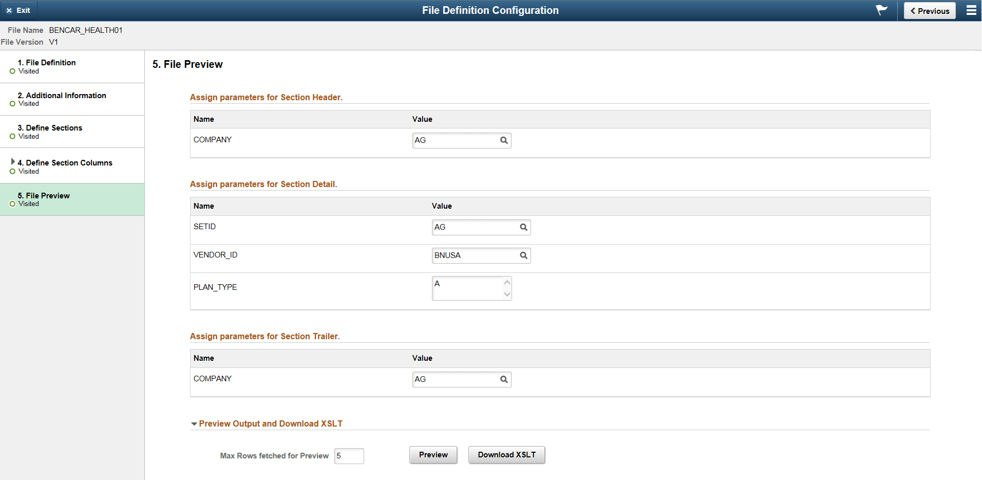

File Definition Configuration - File Preview Page
Use the File Definition Configuration - File Preview page (FF_PREVIEW_FL) to preview the file.
File Definition Configuration - File Preview Page.
Enter the variables for the file definition. Users can choose to set maximum the rows to be displayed for the preview. Users can download and view the XSLT to process the query input.
Use the Variable Definition Setup page (FF_VARIABLE_DTL_F) to create additional variables for the file. The defined variables are used to set values in the File Definition Configuration - Define Sections Columns Page
Navigation:
Set Up HCM, Common Definitions, File Integration Framework, Variable Definition Setup.
Variable Definition Page
Name
Name of the variable.
Data Type
Data type of the variable. Available data types are Character, Date, DateTime, Number, Time.
Description
Description of the variable.
Type
Type of variable. Available types are Calculated, System, Constant.

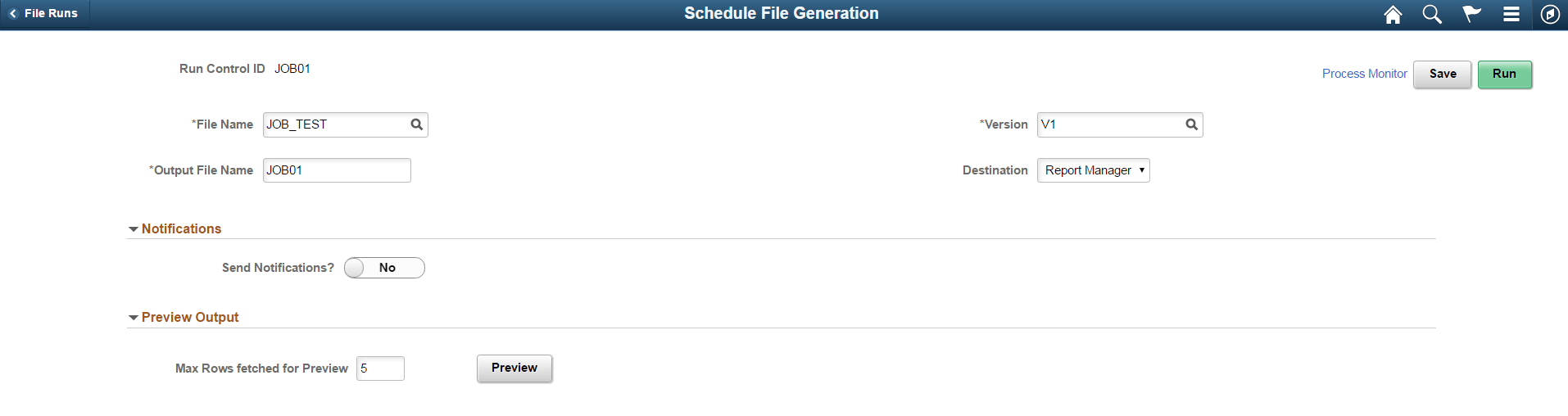

Schedule File Generation Page
Use the Schedule File Generation page (FF_RUNCNTL_FL) to run the file definitions.
Navigation:
Set Up HCM, Common Definitions, File Integration Framework, Schedule File Generation.
Run Control ID
Run Control ID for this definition.
File Name
Name of the file definition to be run.
Version
Version of the file.
Output File Name
Choose the name of the output file.
Destination
Choose the destination of the output file.
Send Notifications?
Choose whether recipients need to be notified during file generation.
Max Rows fetched for Preview
Specify the maximum rows to display for the preview of the file
Preview
Preview the file
Run
Run the file definition.
Process Monitor
Link to the Process Monitor page.
