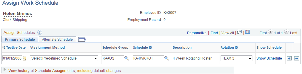

This example illustrates the fields and controls on the Assign Work Schedule page.
Primary Schedule Tab
Field or Control Description
Assignment Method
Select from the following options:
  • Create Personal Schedule: Select to create an effective-dated schedule for this payee. When you select this option, the Create Schedule link appears.
  • Select Predefined Schedule: Select a schedule group and schedule ID to associate with the payee.
  • Use Default Schedule: Select to assign the default schedule for the payee's pay group.
Schedule Group
If the assignment method is Select Predefined Schedule or Create Personal Schedule, select the schedule group to assign to the payee. Each schedule group is associated with a SetID that determines which schedules you can associate with the payee (if you are assigning a predefined schedule) or which predefined workdays and shifts you can use (if you are creating a personal schedule).
If the assignment method is Use Default Schedule, the system displays the schedule group that the payee inherits from the pay group.
Schedule ID
If the assignment method is Select Predefined Schedule, select the schedule to assign to the payee.
If the assignment method is Use Default Schedule, the system displays the schedule ID that the payee inherits from the pay group.
If the assignment method is Create Personal Schedule, the system populates this field with the payee's employee ID and five zeros. For example, if the payee's employee ID is KA3007, the schedule ID is KA300700000.
Rotation ID
This field appears if the selected schedule is a rotating schedule. It is used to determine the relative day in the schedule to which the payee should be assigned.
Show Schedule
This link appears if the assignment method is Use Default Schedule or Select Predefined Schedule. Click to access the Schedule Calendar page where you can view the schedule as of the effective date of the schedule assignment. For rotating schedules, you can click a link on the Schedule Calendar page to compare rotations.
Create Schedule
This link appears if the assignment method is Create Personal Schedule. Click to access the Personal Schedule Definition component where you can define a schedule for this payee.

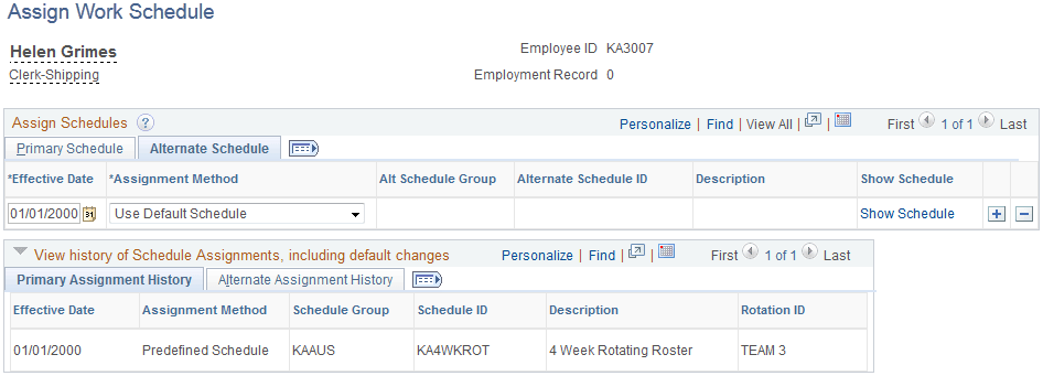

Alternate Schedule Tab
Select the Alternate Details tab.
This example illustrates the fields and controls on the Assign Work Schedule page: Alternate Schedule tab.
Use this tab to assign an alternate schedule to a payee. The fields on this tab are similar to the fields on the Primary Details tab.
Viewing the History of Schedule Assignments
When you click the link to expand the history section of the page, the system displays all of the schedule assignments, including any changes to the default schedule assigned to the payee's pay group.

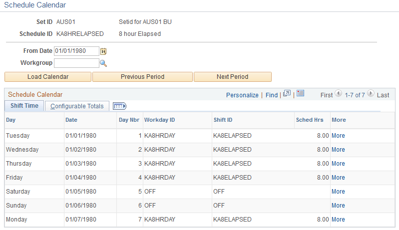

This example illustrates the fields and controls on the Schedule Calendar page.
The displayed schedule pattern is the length of the actual schedule. For example, if the schedule is 28 days, that is the actual pattern that displays.
