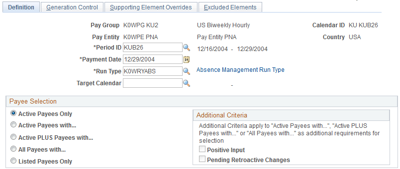

Calendars - Definition Page
Use the Calendars - Definition page (GP_CALENDAR1) to link together the pay group, period ID, run type ID, target calendar ID, and payee selection criteria associated with a calendar.
Navigation:
  • Global Payroll & Absence Mgmt, and then Absence and Payroll Processing, and then Define Calendars, and then Calendars, and then Definition
  • Set Up HCM, and then Product Related, and then Global Payroll & Absence Mgmt, and then Framework, and then Calendars, and then Calendars, and then Definition
This example illustrates the fields and controls on the Calendars - Definition page.
Field or Control Description
Period ID
Enter the absence period the calendar represents. The corresponding dates appear in the Begin Date and End Date fields.
Payment Date
Enter the date when payees are paid. In certain countries, this date is important for tax calculations.
Run Type
Enter the run type that identifies the process list to be used for this calendar run. (The run type also identifies whether retroactive triggers are to be processed.)
<run type description>
Click to access the Run Types page, where you can specify the process list to be used, whether to process retroactive triggers, and other processing parameters.
See Run Types Page.
Target Calendar
Enter a target calendar ID if you're defining an absence processing run or any processing run that generates positive input. Identifies the target calendar for the daily data or positive input being generated. Absences cannot be targeted back in time, so the target calendar end date cannot be earlier than the end date of the current period ID. Target calendar is only required when using Absence Management as a stand alone application or along with Global Payroll. If your generated positive input is to be sent to Payroll for North America or to a third-party payroll application, then you don't need to define a target calendar.
Payee Selection
Identify which payees in the selected pay group to include in the calendar that you're defining. You can have the system identify the payees, or you can list the payees manually. Active payees are those who were active in the pay group for at least one day during the absence period.
The information that you enter here gives the system basic information about which payees to process for a particular calendar.
A calendar created for active payees must be unique based on the combination of pay group, period ID, and run type, reducing the possibility of duplicate calculations.
Active Payees Only
Select to include all active payees with no other qualifying criteria.
Active Payees with...
Select to include only those active payees who have pending retroactive triggers. If you select this option, you must select the Pending Retroactive Changes check box.
Active PLUS Payees with...
Select to include all active payees and payees who were ever active in the pay group, but only if they have pending retroactive triggers. . If you select this option, you must select the Pending Retroactive Changes check box.
All Payees with...
Select to include only those payees who have pending retroactive triggers. If you select this option, you must select the Pending Retroactive Changes check box.
Listed Payees Only
Select to list payees for processing, rather than have the system identify them automatically. The Payee List group box becomes available.
You can use this option to pay one payee or a small group of payees.
Positive Input
This check box is not applicable to Absence Management.
Becomes available if you select Active Payees with..., Active PLUS Payees with...., or All Payees with.
If you select this check box and Active Payees with..., the calendar processes active payees who have pending retroactive triggers.
If you select this check box and Active PLUS Payees with..., the calendar processes active payees or payees who have pending retroactive changes.
This check box enables you to include inactive payees in an active-only run based on the occurrence of a retroactive change that affected the inactive payee.
