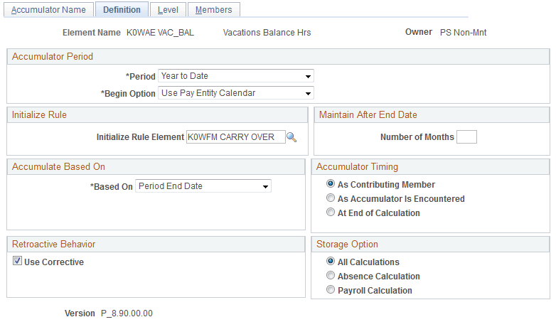

Accumulators - Definition Page
Use the Accumulators - Definition page (GP_ACCUMULATOR_2) to define the period information and indicate the timing of the accumulator's resolution.
Navigation:
Set Up HCM, and then Product Related, and then Global Payroll & Absence Mgmt, and then Elements, and then Supporting Elements, and then Accumulators, and then Definition
This example illustrates the fields and controls on the Accumulators - Definition page.
Accumulator Period
An accumulator period is the period for which an accumulator collects and accumulates amounts.
Field or Control Description
Period
Select from the following options:
Segment: Represents one segment. If there's no segmentation, a segment period and a absence period are identical.
Calendar Period: The period begin and end dates come from the current calendar period.
Month to Date: The system collects information monthly.
Quarter to Date: The system collects information quarterly.
Year to Date: The system collects information yearly.
Custom Period: A custom period enables you to create an accumulator that's completely open-ended—an end date is not required, as might a custom period to track an employee's lifetime wages. When you select this option, the Date field appears for the begin date. Select the element type from the list in this new field.
Begin Option
Select the accumulator's starting point. This field appears if you select Month to Date, Quarter to Date, or Year to Date in the Period field. Values are:
Specify Date: The Begin Month and the Begin Day fields appear. Enter the day and month or select variables to return these values.
Use Paying Entity Calendar and Use Paying Entity Fiscal: The system uses the defaults set on the Pay Entity Processing Details page.
Initialize Rule
Initialize Rule Element
Enter a formula element to be invoked when a new instance of an accumulator is created for a new period. This formula must also be a member of the accumulator for its results to be added to the accumulator. For example, at the beginning of a calendar year, you might want to have a YTD accumulator that contains accrued vacation time carry over the previous year's value, with certain limits. The formula that you select here can serve this purpose. When the accumulator for the new year is created, the formula is invoked. If you leave this field blank, no special processing occurs.
Maintain After End Date
Number of Months
Specify how long an accumulator remains in the output results table after its stop date. You can use this to access a previous accumulator value for a current calculation.
Note: If you select Segment in the Period field, this field becomes unavailable.
Custom Period End Date Options
These fields are only available for custom period accumulators.
The two fields in this group box work independently.
Set End Date If Zero
Select this option to set the accumulator's end date to the segment end date in the period when the accumulator value equals zero. This lets the system display the accumulator's value when it reaches zero and then cease storing this value in the subsequent period.
For example, when tracking entitlement for vacations, you could use this field to display the balance until it reaches zero. If you select this check box, the system populates the Duration in Months field to 999 by default (equivalent to no end date).
Duration in Months
Enter the accumulator's length of duration. The custom period ends after this duration. For example, when tracking maternity leave, you could use this field to display the accumulator for a set entitlement number of months. You should not enter a value in this field if you select the Set End Date if Zero check box. If you select the Set End Date If Zero check box, the system will overwrite any value you enter in the Duration in Months field with a value of 999 (equivalent to no end date).
Accumulate Based On
Based On
Select the calendar period date to use when determining the correct period for recording accumulators. Select from Period Begin Date, Period End Date (default), Payment Date, or Specified Date. Specified Date is commonly used in absence situations. An absence is often linked back to its initial date, even if that was in another period.
Example:
A certain monthly accumulator has one member: E1.
A weekly pay group has these period dates:
Begin Date = January 26, 2005
End Date = February 3, 2005
Payment Date = February 4, 2005
E1 = 10
The Based On field value tells the system whether the 10 of E1 is added to the monthly value for January or February. If you select Period Begin Date, the 10 is added to the January balance. If you select Period End Date, (or Payment Date), the 10 is added to the February balance.
Note: This field is available only if you select Month to Date, Quarter to Date, or Year to Date in the Period field.
Retroactive Behavior
Use Corrective
Select this check box. (This option has added functionality for PeopleSoft Global Payroll.)
Note: This check box must be selected to correctly process retroactivity in Absence Management.
Accumulator Timing
Select the method for resolving the accumulator. Every accumulator has a list of elements associated with it (defined on the Accumulator Elements page). If you reference the accumulator during processing, the value of the accumulator varies, depending on the time that you specify for the accumulation.
As Contributing
As each contributing element is resolved, the accumulator is updated to reflect the new value. The system adds the value of an element—such as an earning or an entitlement—to the accumulator as the system calculates the element. The accumulator doesn't need to appear on the process list.
As Accumulator is Encountered
The accumulator is resolved whenever it is encountered, for example, within a formula. The accumulator does not need to appear on the process list to be resolved. When a contributing element to an accumulator is resolved, the accumulator itself is not automatically updated with the new value.
At End of Calculation
The accumulator is not updated during the main calculation process, but maintains the value loaded from the end of the last finalized segment. Only after all other elements are resolved does the system update the accumulator to reflect the new, current values of its contributing members. This is done automatically: the accumulator does not need to be on the process list. By default, auto-generated accumulators are defined as at end of calculation.
Storage Option
Storage Option
Select the run types during which you can change and store accumulators. Options are:
  • All Calculations: The accumulator value can be changed during any run type. The value is stored after every run.
    Note: Select this option only if truly necessary. Storing values after every run can consume significant storage space.
  • Payroll Calculation: This option applies only when using Global Payroll with Absence Management.
  • Absence Calculation: The accumulator value can be changed during an absence run only. The value is only stored after an absence run.
The system displays an error message if an accumulator is updated during the inappropriate run type. The error message appears, for example, if you attempt to update an absence accumulator in a payroll run.
WARNING:
You should select the storage option before performing batch processing. This is to ensure that the method the batch system uses to load accumulator balances is consistent with the results already generated.

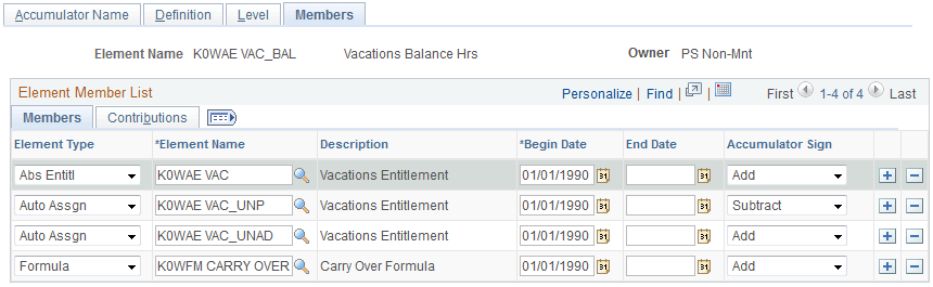

Accumulators - Members Page
Use the Accumulators - Members page (GP_ACCUMULATOR_3) to define the list of elements that contribute to an accumulator.
Navigation:
Set Up HCM, and then Product Related, and then Global Payroll & Absence Mgmt, and then Elements, and then Supporting Elements, and then Accumulators, and then Members
This example illustrates the fields and controls on the Accumulators - Members page: Members tab.
Members
Select the Members tab.
Use the fields on this tab to specify which elements contribute to the accumulator's total.
Element Type
Select from the list of element types. Values are Abs Entitl, Array, Auto Assgn, Bracket, Deduction, Duration, Earnings, Formula, Seg. Accum, System Elem, and Variable.
Element Name
Select elements that contribute to the accumulator's total. An element can accumulate to multiple accumulators; accumulators can contribute to other accumulators.
Begin Date and End Date
Tell the system when a member must start and stop calculating an accumulator.
If this field is blank, the system continues updating the accumulator indefinitely while the elements remain valid.
Accumulator Sign
Select Add or Subtract to indicate if the element adds to or subtracts from the accumulator.

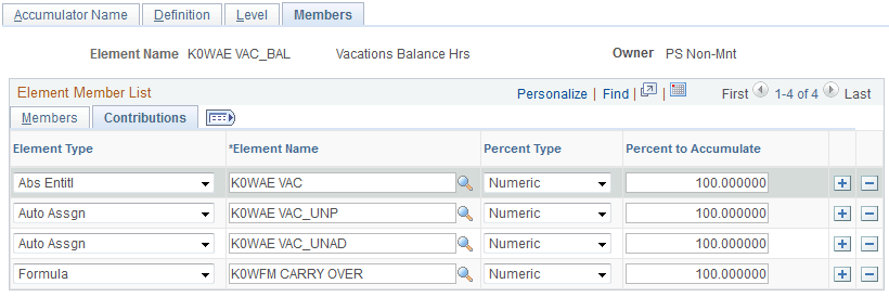

Contributions
Select the Contributions tab.
This example illustrates the fields and controls on the Accumulators - Members page: Contributions tab.
The system lists the elements that you selected on the Members tab.
Percent Type and Percent to Accumulate
Specify the portion of the element's value that the system contributes to or subtracts from the accumulator. Values are:
Numeric: Select to specify a percentage of up to 100 percent. Enter the percentage in the Percent to Accumulate field.
Variable or Formula: Select to have a variable or formula element return the value to accumulate or subtract. Select the variable or formula name in the Element Name field.
