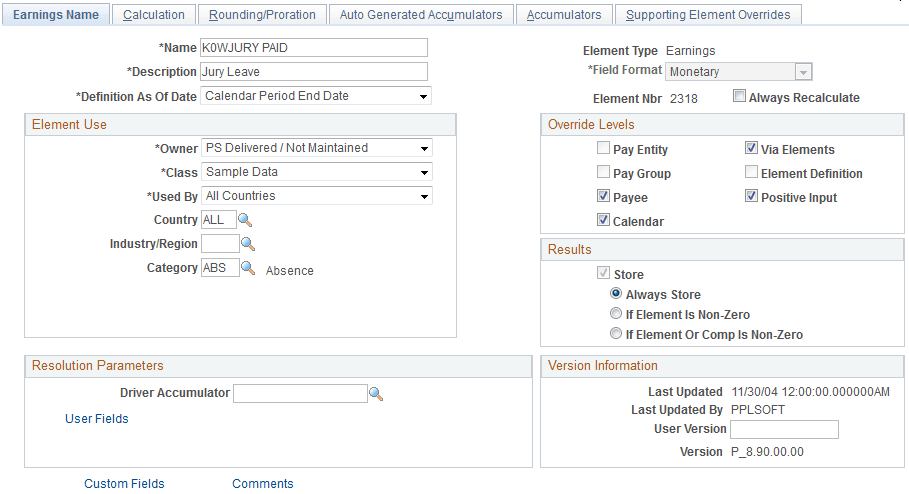

Earnings Name Page
Use the Earnings Name page (GP_PIN) to name the element and define its basic parameters.
Navigation:
Set Up HCM, and then Product Related, and then Global Payroll & Absence Mgmt, and then Elements, and then Payroll Elements, and then Earnings, and then Earnings Name
This example illustrates the fields and controls on the Earnings Name page.
Earnings Name page
You name every element and define its basic parameters on an Element Name page. All element components within Absence Management share the same first Element Name page (GP_PIN). However, the Earnings Name page contains the following additional fields that apply only to earnings.
Field or Control Description
Driver Accumulator
This field applies only to Global Payroll.
User Fields
This link applies only to Global Payroll.
For information on the remaining fields on the Earnings Name page, see Defining Element Names.

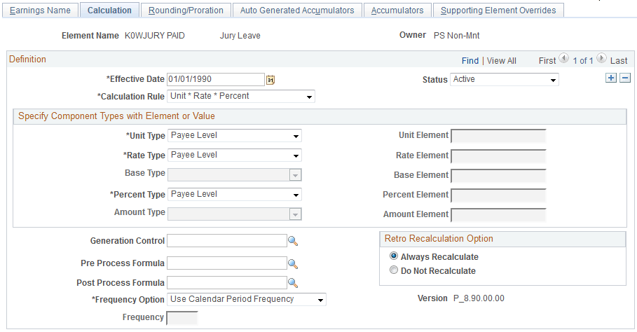

Calculation Page
Use the Calculation page (GP_ERN_DED_CALC) to define calculation rules for an earning element.
Navigation:
Set Up HCM, and then Product Related, and then Global Payroll & Absence Mgmt, and then Elements, and then Payroll Elements, and then Earnings, and then Calculation
This example illustrates the fields and controls on the Earnings - Calculation page.
Calculation Rule
Define the calculation rule for the element. Valid values are Amount, Base x Percent, Unit x Rate, and Unit x Rate x Percent. Your selection affects the availability of other fields.
When you process absence events, the system can generate units for the earning elements, which you can transmit to your payroll system. If you integrate Absence Management with Payroll for North America or Payroll Interface, select a calculation rule that includes units. Unit x Rate x Percent is recommended because it enables you to send both rate and percent information to your payroll system.
Once you define a calculation rule for an element, you cannot change the rule after output results are generated for the element. If you need to change the element definition, create a new element.
Unit Type, Rate Type, Base Type, Percent Type, and Amount Type
The fields that you can update here depend on the selected calculation rule. Select Payee Level for each applicable component.
Note: In Global Payroll, these fields tell the system how to determine the component values or amount. In Absence Management, you use the Absence Take - Day Formula page (when you link the earning element to a take element) to tell the system how to determine the component values or amount.
Unit Element, Rate Element, Base Element, Percent Element, Amount Element, Amount Value and Amount Currency
These fields are not available when you select Payee as the component type.
Generation Control
Pre Process Formula and Post Process Formula
These fields apply only to Global Payroll.
Frequency Option and Frequency
Retro Recalculation Option
Specify whether to recalculate an element during retroactive processing. Values are:
Always Recalculate
Do Not Recalculate
If you select Always Recalculate here, the element is recalculated during processing the element in a retroactive situation.
Note: You can override this field on the Retro Process Overrides page.
See Understanding Retroactive Processing.
