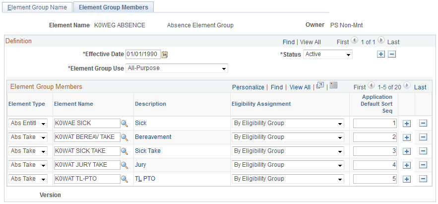

Use the Element Group Members page (GP_ELEMENT_GROUP) to insert elements into element groups.
Navigation:
Set Up HCM, and then Product Related, and then Global Payroll & Absence Mgmt, and then Elements, and then Element Groups, and then Element Group Members
This example illustrates the fields and controls on the Element Group Members page.
Use caution when making changes to element groups that are referenced by list sets. Changes to element groups affect related list sets. For more information about list sets, their use, and their relationship to element groups, see Understanding Applications and List Sets.
Field or Control Description
Element Group Use
Define the way that this element group will be used. This field limits the entry types available in the Element Group Members group box. Values are:
  • All-purpose: Select if this element group can be used for eligibility processing, to define a process set for off-cycle processing, or with list set functionality.
  • Eligibility: This is the default value. Select if this element group is to be used only for eligibility processing.
  • Process Set: Select if this element group identifies a limited set of elements to be processed for a given segment. This type of element group is available for off-cycle processing. The inclusion of an element in this group does not waive eligibility requirements; payees must still be eligible for these elements for the elements to be resolved.
  • Application: Select to use this element group specifically with the list set functionality. Selecting this value will avail the Applications - Static/Dynamic group box and the Application Default Sort Order field.
Note: The system requires that the Element Group Use field value be the same for multiple effective-dated rows. Therefore, if you add a second effective-dated row to this page, the system populates the new effective-dated row's Element Group Use field by default to the value on the original or earliest effective-dated row, and makes the Element Group Use fields unavailable for entry on all effective-dated rows. So, as long as there's only one row, you can edit the Element Group Use field value. When you insert more than one row, all rows will have the same Element Group Use field value (the value of the original or earliest effective-dated row) and all rows will have the Element Group Use field unavailable for entry.
Select whether the element group is a static or dynamic list of elements. Static element groups include a list of elements in the Element Group Members group box. Dynamic element groups include only a SQL Where clause - Dynamic Selection Criteria field - that dynamically determines which elements are included in the group every time the element group is called. The Where clause can also contain an Order By clause to sort the selected elements. This option is only available when Element Group Use is Application.
Element Type
Select the type of element that you're adding to the element group. Values are Absence Entitlement, Absence Take, Deduction, Earnings, and Element Group.
Note: When nesting element groups (that is, including element groups within element groups), the member groups must have the same use option as the parent group.
Element Name
Select the element name that corresponds to the entry type selected.
Description
Click to open the element's definition component in a separate browser window.
Eligibility Assignment
Select the method for assigning the selected element to a payee. This field enables you to indicate whether a payee gets the element processed simply by inclusion in the eligibility group or whether you have to assign the element via the payee-level Earnings/Deductions Assignment page or enter positive input. This field is only available when Group Use Type is Eligibility or All-Purpose.
Values are:
By Eligibility Group: For elements that apply to most or all payees who are associated with this element group via an eligibility group.
By Payee: For payee-level elements.
This field is hidden when you select Process Set for the element group use. It is also hidden when the entry type is Element Group.
Enter the sequence number used to sort the element. To display multiple elements on the same line, use the same sequence number. This field is only available when Group Use Type is Application or All-Purpose.
