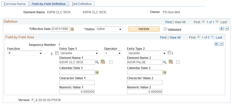

This example illustrates the fields and controls on the Field-by-Field Definition page.

Build your formula in the Field-by-Field Area group box, specifying one operation or result in each row.
Field or Control Description
Function
Select the type of function or qualifier for the formula. Options include And, Average, Comment, Else, Endif, Exit, If, In, Maximum, Minimum, Or, Sum, and Then.
( (left parenthesis)
Select to group your formula calculations. Selecting this check box requires that you must select the ) check box. How you group your formula calculations with parentheses can affect the calculation sequence.
Entry Type 1 or 2, Element 1 or 2, Calendar Date 1 or 2, Character Value 1 or 2, and Numeric Value 1 or 2
Select the entry type for the operation. If you select the Character, Cal Date, Date, or Numeric entry type, enter a value in the corresponding Date Value, Numeric Value, or Character Value field. If you select any other entry type, the system prompts for the correct element in the corresponding Element Name field.
Attributes button
Click to access the Element Name Attributes page and assign a rounding rule, previous period rule, or element pointer selection to a field that you're using in your formula. The check box to the right of the entry type list is selected if additional information has been entered on the Formula - Field Details page.
Operator
Select the operator to perform on the operands that you entered. The following standard operators are available: (none), -, *, /, +, <, <=, <>, =, >, and >=.
) (right parenthesis)
Select to group your formula calculations. If you select this check box, you must select the ( check box. How you group your formula calculations with parentheses can affect the calculation sequence.
Assign To Type and Assign To Element
To assign a value to an element, first select the entry type and then select the element.
For example, you are defining a formula named SICK LEAVE to calculate entitlement for absences due to sickness. To have the system assign the resolved value of the formula element to the SICK LEAVE formula, enter SICK LEAVE in Assign To Element field.
Before you can select the formula in this field, you must save the formula definition with an effective date.
Under either parenthesis, you can enter multiple sets of parentheses. To do so, use multiple lines. You can enter only one ( or ) per row.
