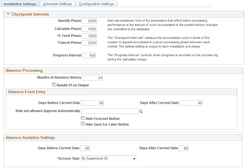

Installation Settings Page
Use the Installation Settings page (GP_INSTALLATION) to define installation settings that are unique to Absence Management.
Navigation:
Set Up HCM, and then Product Related, and then Global Payroll & Absence Mgmt, and then System Settings, and then Installation Settings, and then Installation Settings
This example illustrates the fields and controls on the Installation Settings page.
Installation Settings page (1 of 2)
Installation Settings page (2 of 2)
Checkpoint Intervals
Checkpoint intervals control how many employees are processed between database commits. You can select a different interval for the identify and calculate processing phases. Employees that are committed do not need to be recalculated if the run has to be restarted because of a technical error.
Field or Control Description
Progress Interval
Controls how often the process writes a line to the process log stating how many employees have been processed.
Absence Processing
Months of Absence History
Controls how many months of absence daily history to load into the batch process for use with the absence take element processing and duration element. The absence daily history is loaded from the result table, GP_RSLT_ABS.
Bundle PI on Output (bundle positive input on output)
Selecting this check box causes the system to consolidate positive input during the absence process, when possible, so that you can send a single row of positive input to payroll. Positive input entries for the same asbsence event that share the same percent and rate are combined; the unit, amount, and base values are summed In other words, the bundled generated positive input rows will be output from the absence process instead of daily rows. This is a consideration when considering the size of data storage for the generated positive input result table. Keep in mind, the daily earning/deduction element details will not be stored. This does not effect the actual earning/deduction calculation during the pay calculation. If this check box is off, daily rows would be inserted into the generated positive input result table from the absence process, and the daily rows would be bundled as part of the input process for the pay calculation.
See PeopleSoft Global Payroll: Absence Processing.
Absence Event Entry
Use the fields in this group box to configure the Create and Maintain Absence Requests Pageand the Approve Absence Requests Page.
Days Before Current Date and Days After Current Date
Use these fields to define the default date range that appears in the Search group box of the Create and Maintain Absence Requests page in the From Date and Through Date fields.
Role not allowed Approve Automatically
Users that have the role that you enter here cannot select the Approve Automatically value in the Submit Option field on the Create and Maintain Absence Requests page.
Hide Forecast Button
Select to hide the Forecast button on the Create and Maintain Absence Requests and Approve Absence Requests pages.
Hide Save For Later Button
Select to hide the Save For Later button on the Create and Maintain Absence Requests page.
Absence Analytics Settings
Use the fields in this group box to establish default settings for the Absence Cost Analysis, Absence Events Analysis, Absence Liability and Trends, and Periodic Absence Rate pivot grids that appear on the Absence Analytics Dashboard.
Use these fields to define the default date range for which the pivot grids display information. You can change this date range when you access the individual pivot grids.
Access Type
Enter the access type that the pivot grids use to determine direct reports for managers.
For more information on the Absence Analytics Dashboard, see Using the Absence Analytics Dashboard Pagelets.
Enable Pivot Grid Analytics
Select to enable the process that extracts data for the pivot grids that appear in the Absence Analytics Dashboard.
For more information, see Preparing and Loading Absence Analytics Data.
Payment Processing
Use this group box to define database-specific payment processing settings that are used when communicating payment information.
Database Identifier
Enter a unique alphanumeric identifier that the system adds to payment messages that it sends.
Payment Count
Enter the number of payments that you want the system to chunk together with each payment message. For example, if you enter 3000 here, the system will create and publish a separate payment message for every 3000 rows of payment data.
Packager Processing Defaults
Script Location
Enter the location where DMS scripts are created. The default will be blank. An example displays below the field to let you know how to enter the script location.
Note: The value will default for the rule and non-rule packages. This script location should match the location set up for the PSNT process scheduler in which you are using. This is set up in the psconfig.cfg file.
Compare Report Print Options
This group box controls the sections of the Compare Report that will be printed. Select the sections of the report to print . The options on the Packager Processing page will default the values selected each time you run a Compare Report. The check boxes can be overridden on the processing pages.
Values for the report sections include:
  • Errors/Warnings – Select to print the warning or errors that have occurred during the compare.
  • Modified – Select to print the elements that are different from the ones in the target database.
The above two options reflect the delivered defaults.
  • New – Select to print the new elements.
  • Deleted – Select to print the elements that will be deleted.
  • Unchanged – Select to print the elements that have not changed.
Continue Upgrade Processing
This group box controls the ability to upgrade when there are errors or warnings. The default for each value is cleared.
Valid values include:
  • With Errors – Select to upgrade the package even if there are errors after the compare.
  • With Warnings – Select to upgrade the package even if there are warnings after the compare.

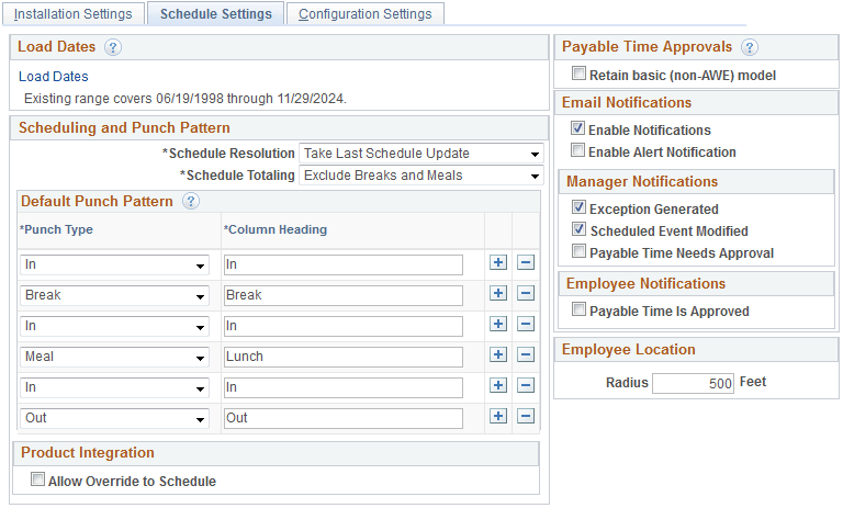

Schedule Settings Page
Use the Schedule Settings page (TL_INSTL_PUNCH) to define default settings for work schedules.
Navigation:
Set Up HCM, and then Product Related, and then Global Payroll & Absence Mgmt, and then System Settings, and then Installation Settings, and then Schedule Settings
This example illustrates the fields and controls on the Schedule Settings page.
Load Dates
Click to access the Dates Table Load page where you can load the range of dates to be used in schedules. Dates from 1994 to 2014 are pre-loaded. You need only use this feature to load dates before or after this date range.
Schedule Resolution
Specify how to resolve schedule changes.
Select Take Last Schedule Update to have the system use the last update to resolve an employee's schedule, whether the update comes from a third-party, workforce scheduling system or an online override.
Select Take Online Override to have the system look for an online schedule override to resolve the schedule for the day. The system does not look for changes from a third-party workforce scheduling system.
Schedule Totaling
This field applies only if People Soft Enterprise Time and Labor is installed. Specify whether to include or exclude meal times, breaks, or both in the scheduled hours totals on schedule definitions, shift definitions, and the Manage Schedules page. Options are Exclude Meals and Breaks, Include Meals and Breaks, Include Meals, and Include Breaks. The default is Include Breaks.
Default Punch Pattern
Specify the default sequence for displaying punch types on the scheduling pages. You can also use the Grid Column Heading fields to modify the punch type labels that are to appear as column headings on the schedule pages.
Payable Time Approvals
Retain basic (non-AWE) model (retain basic non-Approval Workflow Engine model)
Select to use the basic model for approving Time and Labor payable time instead of Approval Workflow Engine.
Email Notifications
Enable Notifications
Select to enable email notifications. You cannot select any of the check boxes in the Manager Notifications or Employee Notifications group boxes unless the Enable Notifications check box is selected.
Oracle PeopleSoft delivers Notification Composer Framework to manage the setup and administration of all notifications in one central location.
Once you have adopted the Notification Composer feature, you must use it to create new notifications and manage your existing notifications.
Notifications delivered with HCM Image 47 or later must use Notification Composer.
For more information about Notification Composer Framework, see Enterprise Components: Understanding Notification Composer.
Exception Generated
Select to generate a notification when an exception is generated.
Scheduled Event Modified
Select to generate a notification when a scheduled event is modified.
Payable Time Needs Approval
Select to generate a notification when payable time needs approval.
Payable Time Is Approved
Select to generate a notification when payable time is approved.

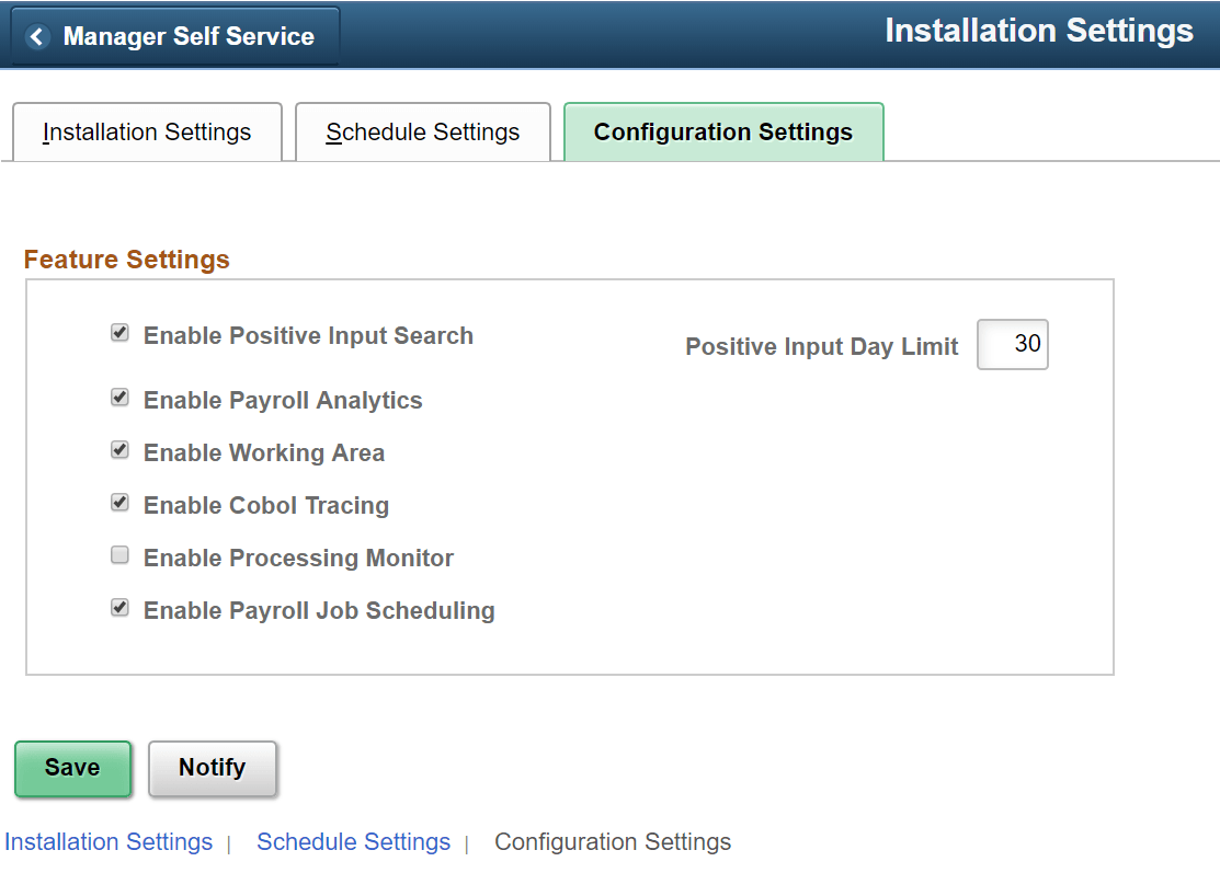

Configuration Settings Page
Use the Configuration Settings page (GP_ACTIVAT_SETTING) to enable and configure feature settings.
Navigation:
Set Up HCM, and then Product Related, and then Global Payroll & Absence Mgmt, and then System Settings, and then Installation Settings, and then Configuration Settings
This example illustrates the fields and controls on the Configuration Settings page.
Feature Settings
Enable Positive Input Search
Select to enable the Positive Input Search page. If this check box is deselected, users trying to access the Positive Input Search page receive an error message explaining that this check box must be selected before the page can be accessed.
Positive Input Day Limit
Enter the number of days in history for which the keyword search retrieves results on the PeopleSoft Global Payroll: Positive Input Search Page. For example, if the value in this field is 100,, the search looks for positive input entries that match your keywords and that were entered 100 days ago or less.
Enable Payroll Analytics
Select to enable access to the PeopleSoft Global Payroll: Global Payroll Analytics Page. If this check box is deselected, users trying to access the page receive an error message explaining that this check box must be selected before the page can be accessed.
Enable Working Area
Select to calculate work item counts during the payroll process. They system displays these counts on the PeopleSoft Global Payroll: Payroll Work Items Page.
Enable Cobol Tracing
Select to enable the Cobol Trace Parameters functionality on the Debug and Tuning Options Page.
Enable Processing Monitor
Currently, this functionality is not supported in PeopleSoft.
Enable Payroll Job Scheduling
Select to enable the scheduling of Payroll Job. If this option is selected the user can schedule the payroll job for Calculate (and Recalculate) option. The system retains the calendar control run parameters for scheduled run and in case if multiple users finalize or cancel the calendar, the stored run control parameters are deleted and its corresponding scheduled job is also cancelled. In case the user who scheduled the payroll job is different from the one who cancels or finalizes the calendar the mail notification is sent to user who scheduled the job about deletion of stored run control parameters and cancelation of scheduled run.

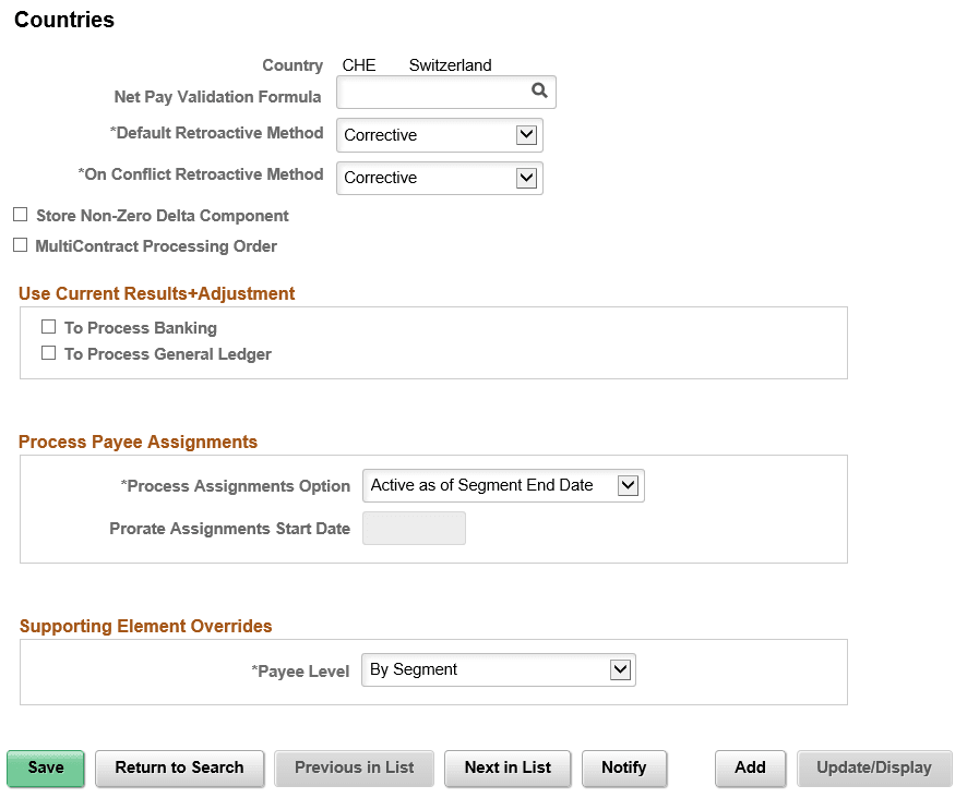

Countries Page
Use the Countries page (GP_COUNTRY) to define country-level setup parameters.
Navigation:
Set Up HCM, and then Product Related, and then Global Payroll & Absence Mgmt, and then System Settings, and then Countries, and then Countries
This example illustrates the fields and controls on the Countries page.
Countries page
Although the fields on the Countries page are not directly applicable to Absence Management, you must use the Countries component to define a country record for each country that uses the Absence Management application. Creating country records is a prerequisite to defining self-service absence entry rules and for using some other features.
Net Pay Validation Formula
This field is not applicable to Absence Management.
Default Retroactive Method
Values are Corrective and Forwarding. The only valid value for Absence Management is Corrective.
On Conflict Retroactive Method
Select which retroactive method, Corrective or Forwarding. The only valid value for Absence Management is Corrective.
Prorate Assignments Start Date
This field is used when the Process Assignment Option is Active Anytime within Segment. It is not used with Absence Management.
Store Non-Zero Delta Component
Select this check box in order for the system to store any delta amount or delta component that has a nonzero value, regardless of the setting on the Element Name (GP_PIN) page, Results group box for the element. Clear this check box in order for deltas to inherit the element's store option.
The following table provides an overview of how the system interprets the check box settings at different levels:
Element Store Option Country Delta Option Element is Stored Delta is Stored
ON
ON
YES
YES
ON
OFF
YES
YES
OFF
ON
NO
YES
OFF
OFF
NO
NO
For additional information regarding retroactivity, see Understanding Retroactive Processing.
MultiContract Processing Order
Select this check box to set the processing order to Emplid/Empl_Rcd for Swiss clients with Multi Contract. This field is displayed only for CHE Switzerland.
Use Current Results + Adjustment
The check boxes in this group box are not applicable to Absence Management.
Process Payee Assignments
The Process Assignments Option field determines when to process earning or deduction payee assignments. The options are:
  • Active as of the Segment End Date: Select to have an element entered on the payee assignment page processed if the assignment is active as of the segment end date.
  • Active Anytime within Segment: Select to have an element entered on the payee assignment page processed and prorated for rows falling within a segment in addition to rows active as of the segment end date.
    This option is used when the proration of earning/deduction assignments is desired. This is the first in a series of steps to setting up the proration of earning/deduction assignments functionality. Additionally a segmentation trigger definition must be defined for the payee assignment record (GP_PYE_OVRD).
Supporting Element Overrides
The Payee Level field determines the level at which Payee Supporting Element Overrides are resolved.
Available options are:
  • By Segment: Override value applies to the full segment.
  • By Slice: Override value can be resolved separately for each slice in case of Element Segmentation.
If no value is selected in this field, the option ‘By Segment’ is taken by default.
