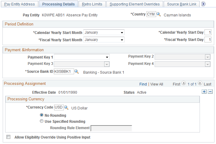

Processing Details Page
Use the Processing Details page (GP_PYENT_PRCS_DTL) to enter processing details for a pay entity.
Navigation:
Set Up HCM, and then Product Related, and then Global Payroll & Absence Mgmt, and then Framework, and then Organizational, and then Pay Entities, and then Processing Details
This example illustrates the fields and controls on the Processing Details page.
WARNING:
Do not modify fields above the effective-dated area of the page after implementation. Doing so can destroy the integrity of retroactive and accumulator calculations.
Field or Control Description
Country
Select the processing country for this pay entity.
Period Definition
Calendar Yearly Start Month and Calendar Yearly Start Day
Enter the start date for the pay entity's calendar year. This date becomes the default start date for accumulators that are based on calendar year, unless you specify otherwise in the accumulator definition.
Fiscal Yearly Start Month and Fiscal Yearly Start Day
If your pay entity operates on a fiscal year that's different from the calendar year, enter the start date of the fiscal year. This date is used as the default start date for accumulators that are based on fiscal year, unless you specify otherwise in the accumulator definition.
Payment Information
Payment Key 1−4
The Payment Key fields are not applicable to Absence Management.
Source Bank ID
This field is required. You must create a "dummy" Source Bank ID and enter it in this field.
See Application Fundamentals: Understanding Bank and Bank Branch Setup.
Processing Currency
The processing currency defined at the pay entity level is the unit to which other currencies are converted before calculations are made.
Currency Code
Select the default processing currency, which the system uses for calculations and reports and as the default for any element without an associated currency.
Note: If the effective date changes during a pay period, the system uses the currency that's effective at the end of that pay period. Any change of currency should coincide with the beginning of a pay period.
No Rounding
Select to prevent rounding in currency conversion.
Use Specified Rounding
Select to have the system run a rounding rule for currency conversion, regardless of the value's source (for example, positive input, accumulators, or historical rules).
Rounding Rule Element
If you selected Use Specified Rounding , enter the rounding rule element that you want to use for rounding.
Eligibility Override allowed via
Positive Input
This check box does not apply to Absence Management. The default setting for this check box is cleared.
