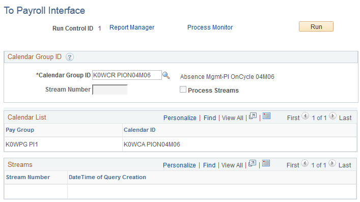

To Payroll Interface File Page
Use the To Payroll Interface File page (GP_ABS_PI_RUNCTL) to run the process that sends the generated positive input from the absence process to a new table from which Payroll Interface extracts data for use in the payroll system.
Navigation:
Global Payroll & Absence Mgmt, and then Absence and Payroll Processing, and then Absence Conversion Processing, and then Send Data to Payroll Interface, and then To Payroll Interface File
This example illustrates the fields and controls on the To Payroll Interface File page.
Use this page to transfer generated positive input from Absence Management to Payroll Interface. After this process is completed, the Absence Management data resides in new table, Absence Management to Payroll Interface - Output File (GP_ABS_PAY_INTF), from which Payroll Interface extracts data for use in the payroll system.
