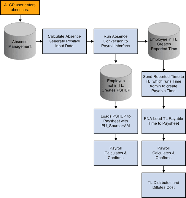

This diagram illustrates the flow of information from Absence Management to Payroll for North America, with or without the interface to Time and Labor.
Absence Management Integration to Payroll for North America
There are two types of integration between Absence Management and Payroll for North America, direct integration or integration though Time and Labor. To enable direct integration between Absence Management and Payroll for North America, Absence Management exports computed absence results to the PSHUP_TXN table where the rest of the interfaces with payroll for North America are deposited. Later on the Absence data can be loaded into Paysheets with the Load Transactions Table process, using the source code Absence Management.
If your organization uses Time and Labor in conjunction with Payroll for North America, Absence Management exports computed absence results in Time and Labor. Time and Labor converts the absence results into Payable Time.

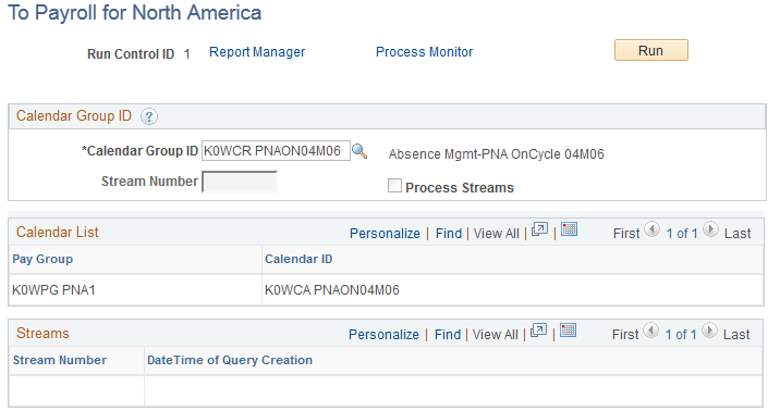

Use the To Payroll for North America page (GP_ABS_NA_RUNCTL) to run the process that sends the generated positive input from the absence process to the Paysheet Load Holding Record (PSHUP) for use by Payroll for North America, or create Time and Labor Payable Time for use by Time and Labor.
Navigation:
Global Payroll & Absence Mgmt, and then Absence and Payroll Processing, and then Absence Conversion Processing, and then Send Data to Payroll for NA, and then To Payroll for North America
This example illustrates the fields and controls on the To Payroll for North America page.
Use this page to transfer generated positive input from Absence Management to Payroll for North America. After this process is completed, the Absence Management data resides in the Paysheet Load Holding Record (PSHUP_TXN) in Payroll for North America for those employees that are not enrolled in Time and Labor.
See PeopleSoft Payroll for North America: Loading Paysheet Transactions.
