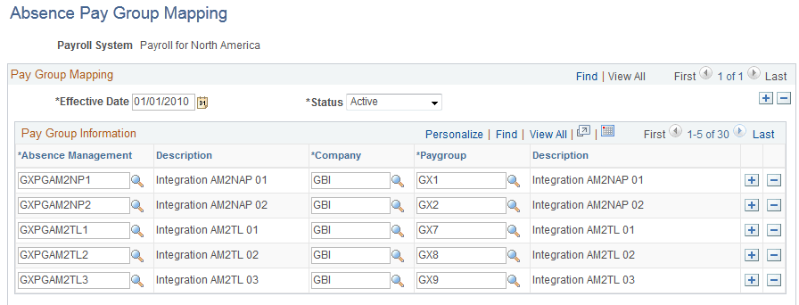

Absence Pay Group Mapping Page
Use the Absence Pay Group Mapping page (GP_ABS_PAYGROUP) to map pay groups that are defined in Absence Management to pay groups that are defined in Payroll for North America or Payroll Interface.

Use this page to establish a one-to-one correspondence between pay groups in Absence Management and pay groups in Payroll for North America or Payroll Interface. For Payroll for North America, the pay group prompt list originates from the Payroll for North America Pay Group Table without any PI Configuration value; those for Payroll Interface have a PI Configuration value.
A company may have multiple pay groups, but each pay group is attached to only one company.

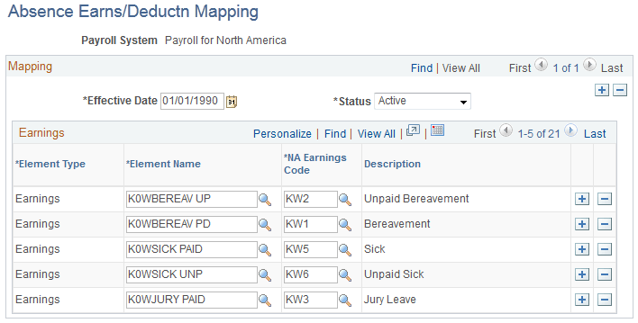

Mapping Absence Management Codes to Payroll for North America without Time and Labor
Access the Absence Earnings/Deduction Mapping page using Payroll for North America as the payroll system (Set Up HCM, and then Product Related, and then Global Payroll & Absence Mgmt, and then Integration, and then Earnings/Deductions Mapping, and then Absence Earns/Deductn Mapping).
This example illustrates the fields and controls on the Absence Earns/Deductn Mapping page for Payroll for North America without Time and Labor.
Absence Earns/Deductn Mapping page - Payroll for North America
Use this page to map earning elements in Absence Management to Earning Codes in a Payroll for North America system that does not interface with Time and Labor.
All positive input generated in Absence Management that interfaces directly with Payroll for North America without Time and Labor must be linked to earning codes on the Absence Earnings/Deduction Mapping page. Earning codes for Payroll for North America originate from the Payroll for North America Earnings Code table.

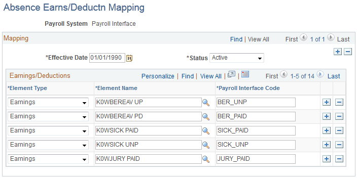

Mapping Absence Management Codes to Payroll Interface
Access the Absence Earnings/Deduction Mapping page using Payroll Interface as the payroll system (Set Up HCM, and then Product Related, and then Global Payroll & Absence Mgmt, and then Integration, and then Earnings/Deductions Mapping, and then Absence Earns/Deductn Mapping).
This example illustrates the fields and controls on the Absence Earns/Deductn Mapping page for Payroll Interface.
Absence Earns/Deductn Mapping page - Payroll Interface
For Payroll Interface, you can map both earning and deduction elements from Absence Management.
Positive input generated in Absence Management does not need to be mapped to valid Payroll Interface codes. Absence Management does not validate Payroll Interface codes. Mapped Payroll Interface codes are free form, as defined by the third-party payroll system's interface. Element numbers (PIN_NUM), Element Codes (PIN_CODE) or Element Names (PIN_NM) can be used instead of mapped Payroll Interface codes to identify Absence codes in Absence Management's output interface file.

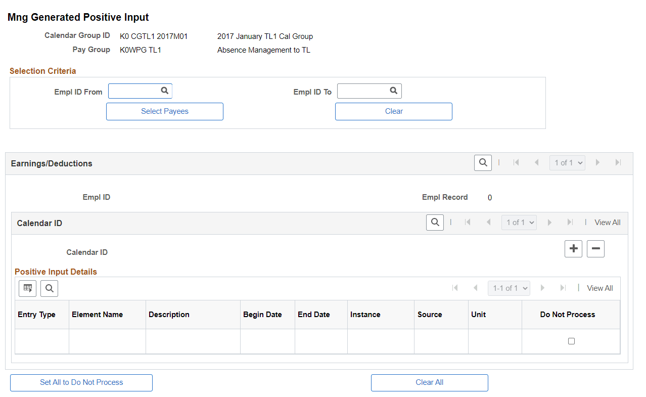

Mng Generated Positive Input Page
Use the Mng Generated Positive Input (Manage Generated Positive Input) page (GP_ABS_MANAGE_GPI) to view and manage generated positive input from the absence process by Calendar Group ID.
Filter records by EmplID and select or clear specific records for conversion to Payroll for North America or Payroll Interface.

Global Payroll & Absence Mgmt, and then Absence and Payroll Processing, and then Absence Conversion Processing, and then Mng Generated Positive Input, and then Mng Generated Positive Input
This example illustrates the fields and controls on the Mng Generated Positive Input page.
Absence Management creates a Generated Positive Input (GP_PI_GEN_DATA) file when the Absence Take process runs during absence processing. Absence Management uses this file to provide information to the payroll system's interface file.
After the Generated Positive Input file is created, the user can opt not to send or process some absences to the payroll system. This page displays absence results for the selected Calendar Group ID as generated positive input. Select the Do Not Process check box in the Positive Input Details group box for all items that you do not want to transfer to the payroll system that Absence Management integrates with, either Payroll for North America or Payroll Interface.
Use the following fields and buttons to filter results by Employee ID and select or clear all check boxes.
Field or Control Description
EmplID From and EmplID To
Enter an employee ID in one or both fields to limit the records that display in the Positive Input Details group box. Specifying a value in the EmplID From field sets the lower end of the range of values. Specifying a value in the EmplID To field sets the higher end of the range of values. You can leave these fields blank to display all generated positive input for the Calendar Group ID.
Select Payees
Click this button to display records for the range of EmplIDs that you specified in the EmplID From and EmplID To fields.
Clear
Click this button to remove values in the EmplID From and EmplID To fields. After clicking this button, you must click the Select Payees button again to display records for all, or a different range of EmplIDs.
Set All to Do Not Process
Click this button to select the Do Not Process check box for all displayed records.
Clear All
Click this button to clear the Do Not Process check box for all displayed records.
