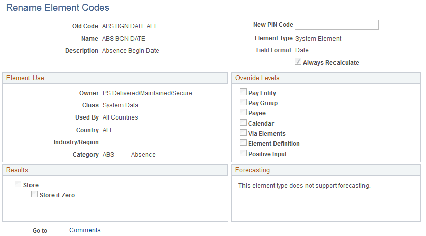

Element Rename Page
Use the Element Rename page (GP_PIN_RENAME) to change an element's PIN code.
Navigation:
Set Up HCM, and then Product Related, and then Global Payroll & Absence Mgmt, and then Elements, and then Rename Element Codes, and then Element Rename
This example illustrates the fields and controls on the Rename Element Codes page .
Field or Control Description
New PIN Code (new pay item name code)
Enter the new code. The old PIN code is replaced when you save.
Note: When renaming a PIN, make sure that you use the PIN name plus the country suffix. For example: PIN NAME DEU.
