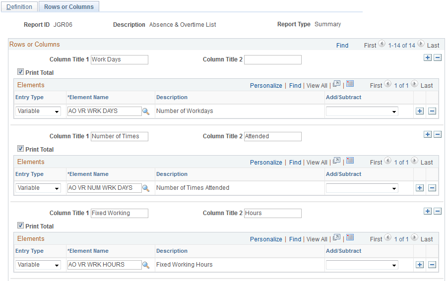

Rows or Columns Page
Use the Rows or Columns page (GP_GENRPT_ROW) to define rows or columns and the elements that are to be reported.
Navigation:
Set Up HCM, and then Product Related, and then Global Payroll & Absence Mgmt, and then Reports, and then Generic Reports, and then Rows or Columns
This example illustrates the fields and controls on the Rows or Columns page.
Different fields appear on this page depending on the report type that you selected on the Generic Reports - Definition page. For all report types, the Column Title, Print Total, Element Name, and Description fields appear.
The following additional fields appear for the specified report type:
List and Summary Accumulators
Entry Type
User Key
Add/Subtract
Label Column
Label (if Label Column is selected)
Do not print row if results equal zero
Print Calendar ID
Rows or Columns
The following table summarizes the type of data in the rows and columns for each report type.
Report Type Columns Rows
List
Element or group of elements
Payees
Summary
Date ranges
Element or elements
Accumulator
Accumulators
Payees
Field or Control Description
Column Title
Define the title for each column. Each title can be two lines with up to 30 characters in each line.
User Key
(Accumulator type only) Select a user key for the accumulator. A column is either a user key or an element.
Print Total
Select to print totals before a page break.
Print Field Label
This check box appears only for Accumulator report types and only for columns that are not user keys. Select to print a label instead of the values for an element in the column. The system prints the text from the Label field.
This check box appears only for Accumulator report types and for columns that are not user keys. Select the check box to suppress rows where an accumulator does not have an end date and therefore forwards zero results into each new calendar. Selecting this check box will prevent unwanted and meaningless rows from displaying on the report.
Print Calendar ID
This check box appears only for Accumulator report types and only for columns that are not user keys. Select this check box to print the calendar ID of the result row, thereby increasing the readability of the report for calendar groups in which retroactive processing has occurred.
Elements
Select the elements that are to be reported in each row or column.
Entry Type
Select the entry type of the element. Values are Auto Assgn (auto assigned), Bracket, Deduction, Earnings, Formula, SystemElem (system element), and Variable.
Element Name
Select the element name.
Label
Replaces the Description field only for the accumulator report type when you select the Label Column check box for a column that is not a user key or calendar ID. Enter the label that is to be printed in the column when the associated element is other than 0.
Add/Subtract
Select whether the element should be added to or subtracted from the total for the column or row.
For Accumulator report types, some precision may be needed. The system obtains all the user keys from the accumulator result table for all the accumulators that are defined in the setup. It then prints the user keys and selects the accumulator results starting from those keys.
In addition, there are cases where accumulators continue to carry forward after an event has completed because the accumulators have not been defined with an end date. In such cases, it may be necessary to identify an accumulator where the results always carry forward as zero and use the Do not print row if results equal zero check box. The above also applies in cases where accumulators have been defined with a storage option of "All Calculations" and the calendar run has encountered retroactive processing. Use the Do not print row if results equal zero check box to suppress the extra unwanted rows.
