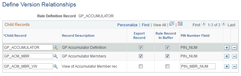

Define Version Relationships Page
Use the Define Version Relationships page (GP_VER_RULE_DFN) to view version relationships between element definition records.
Displays the Rule Definition record and the corresponding child records.

This example illustrates the fields and controls on the Define Version Relationships page.
Field or Control Description
Rule Definition Record
Displays the name of the parent record that contains the field GP_VERSION.
Child Record
Displays the child record whose data when changed causes GP_VERSION to be cleared from the corresponding row in parent record. (The name of the parent record is displayed here if there are no children.)
Export Record
Selected if the child record is to be included in the version package for export and import.
For example, when an accumulator element changes, only data in GP_ACCUMULATOR and GP_ACM_MBR needs to be moved. The child record, GP_ACM_MBR_VW, does not need to be exported and imported because it is used only to associate accumulators with earnings and deductions in the Earnings and Deductions components.
Rule Record in Buffer
Applicable to accumulators only.
Selected if the record that has GP_VERSION is in the component buffer (for example, when an earning accumulator is changed, and needs GP_VERSION cleared). Record GP_ACCUMULATOR is not in the component buffer. Select this check box to prevent the system from looking for the record in RECNAME_RULE_DFN in the component buffer and issue a SQLEXEC instead. The child record that exists in the earnings component is GP_ACM_MBR_VW.
PIN Number Field
Displays the name of the PIN_NUM field on the record that needs GP_VERSION cleared. Using the earlier example, the earning accumulator PIN_NUM is contained as PIN_MBR_NUM in the earnings component buffer and PIN_NUM itself contains the earning PIN. So, when updating data for GP_ACCUMULATOR, data for PIN_MBR_NUM value and not PIN_NUM value from the earnings component must be updated.
