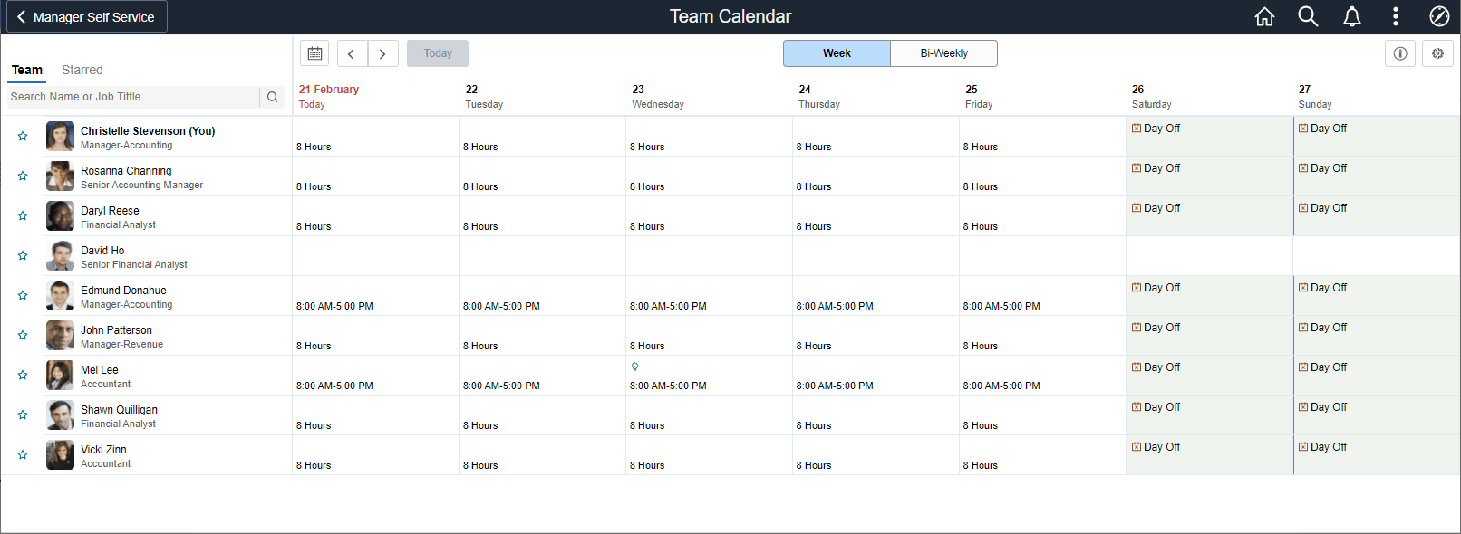

The employee can use the Team Calendar page to view peer events at one place.
By default, the Team Calendar page displays week view. Toggle between the tabs to view the biweekly reports period.
This example illustrates the fields and controls of Team Calendar page weekly view.
Team Calendar_Week View

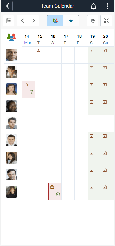

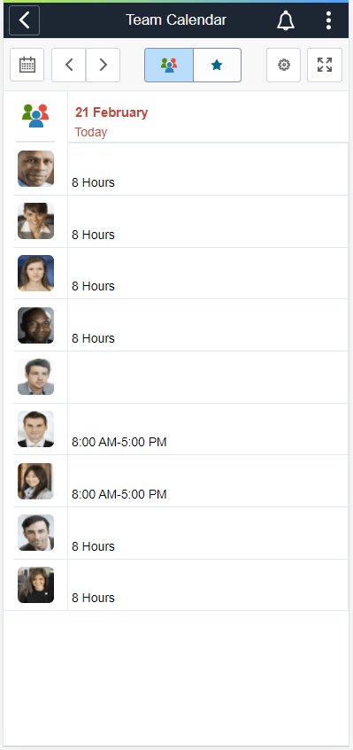

This example illustrates the daily view of Team Calendar page in smartphone.
Team Calendar Daily view in smartphone
The smartphone supports only Daily and Weekly modes.

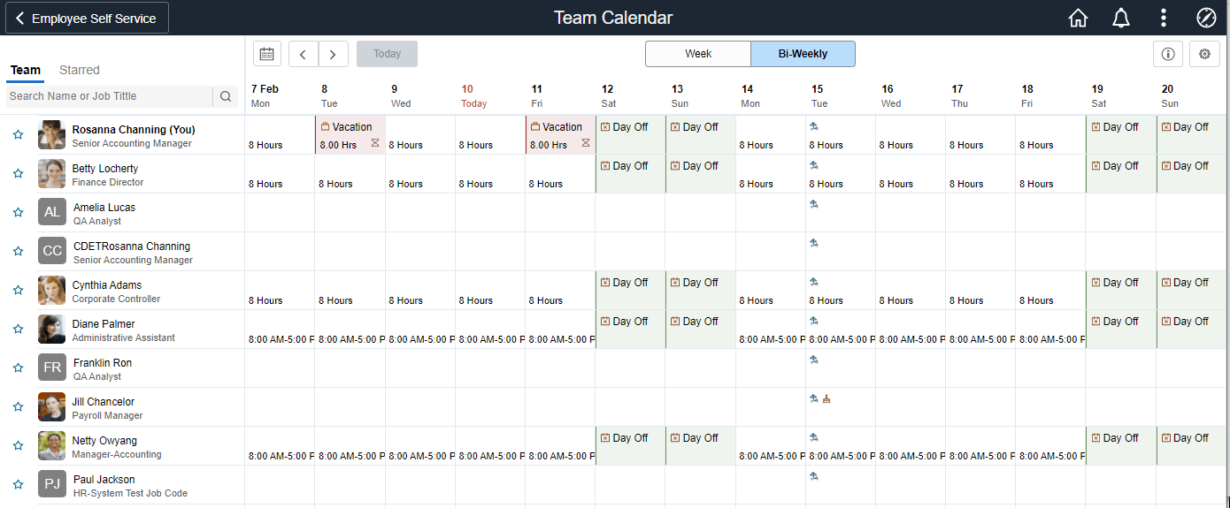

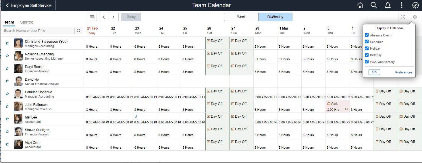

Select the Bi-Weekly tab to view the calendar for two weeks.
This example illustrates the fields and controls of Team Calendar page Bi Weekly page.
Team Calendar_Bi-Weekly

Toggle team and star view in smartphone
Toggle between team and star view while using smartphone.

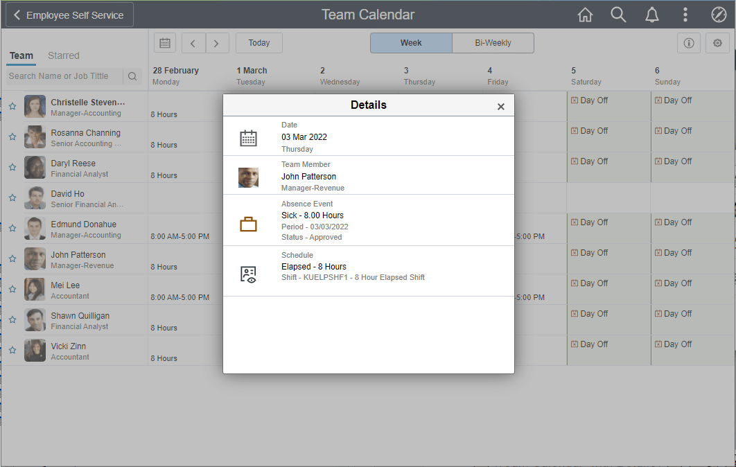

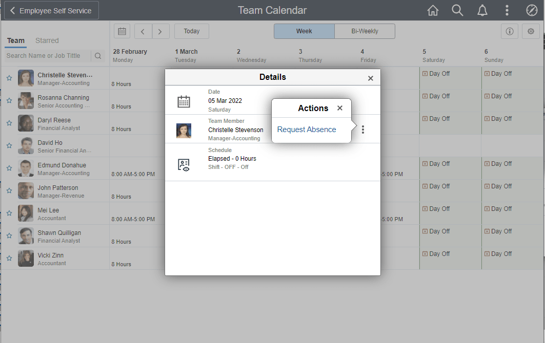

Select the day box for an employee to view the Details modal, from where the manager can select the related actions and do the necessary operations.
While using a smartphone, to view the team and starred employees in a single page, select the Team View in smartphone menu icon.
Select theShow Calendar button to view the comparison report. You can view the report in daily or weekly view by selecting the the Toggle view in smartphone button.
This example illustrates the fields and controls of Team Calendar with details.
Team Calendar_with Details

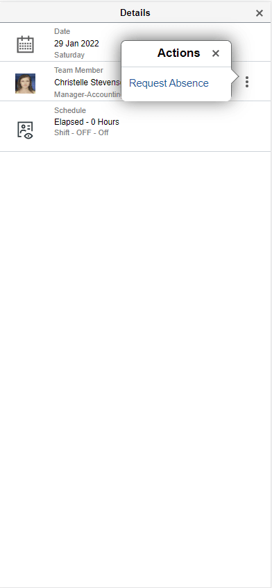

Select Related Actions on the Details modal to open the related actions. From here, the employees can perform the actions. The Related Actions are derived from App Class definition for the event.
The Request Absence option will open up Manage Absences Page to provide absence details for the chosen date.

This example illustrates the related actions in smartphone.
Related Actions in smartphone

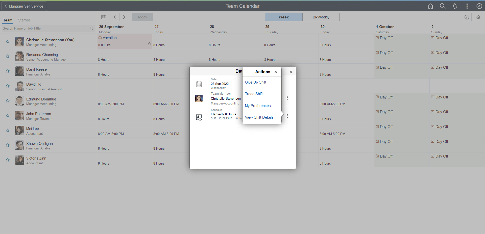

The employees who has access to schedule change request in ESS, will have related actions to give up or trade shift displayed in the calendar. Selecting any of these options will open up the PeopleSoft Time and Labor: Give up your Shift Page or PeopleSoft Time and Labor: Trade your Shift Page to provide the details for the chosen date.
This example illustrates the related actions for Give up, Trade and View Shift details.
Related Actions or Give up, Trade and View Shift Details
The organizations can configure which related actions to show.

This example illustrates the fields and controls of the Display in Calendar modal.
Preferneces_Display in Calendar
